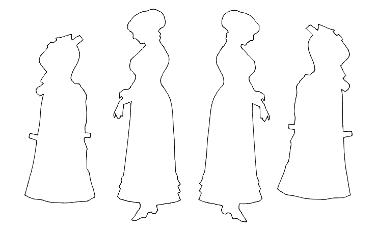

Cut out tabs on paper doll cutouts
I would like to remove the tabs on paper dolls below.

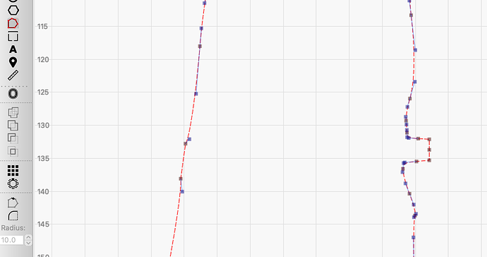

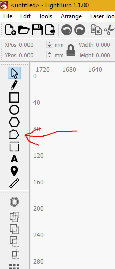

assuming it’s a vector not an image, select the lady to change and click the edit node tool
Hover over the tool bar image for instructions
You need to “just” ungroup it and use the nodes tool. Point to the points to be deleted and press “D”. I hope you understand what I mean otherwise you just return here to.
