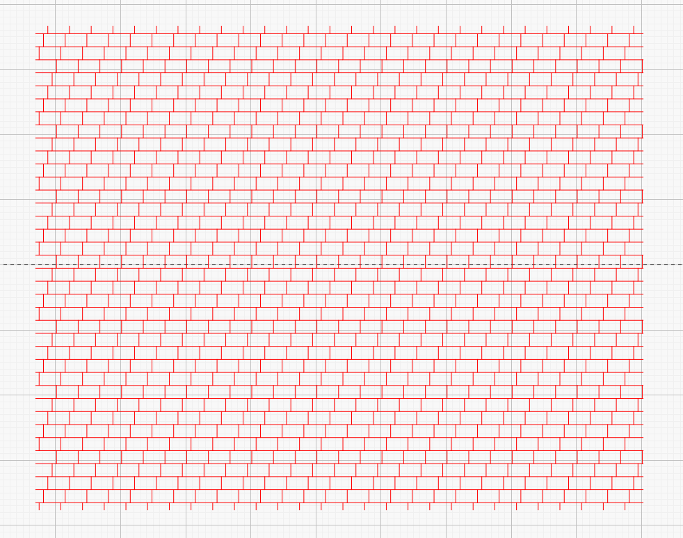

How can I quickly and easily remove the red lines outside the black rectangle, as marked with an arrow in the image?
Here is the file, and I would like to remove the red lines outside the black square.

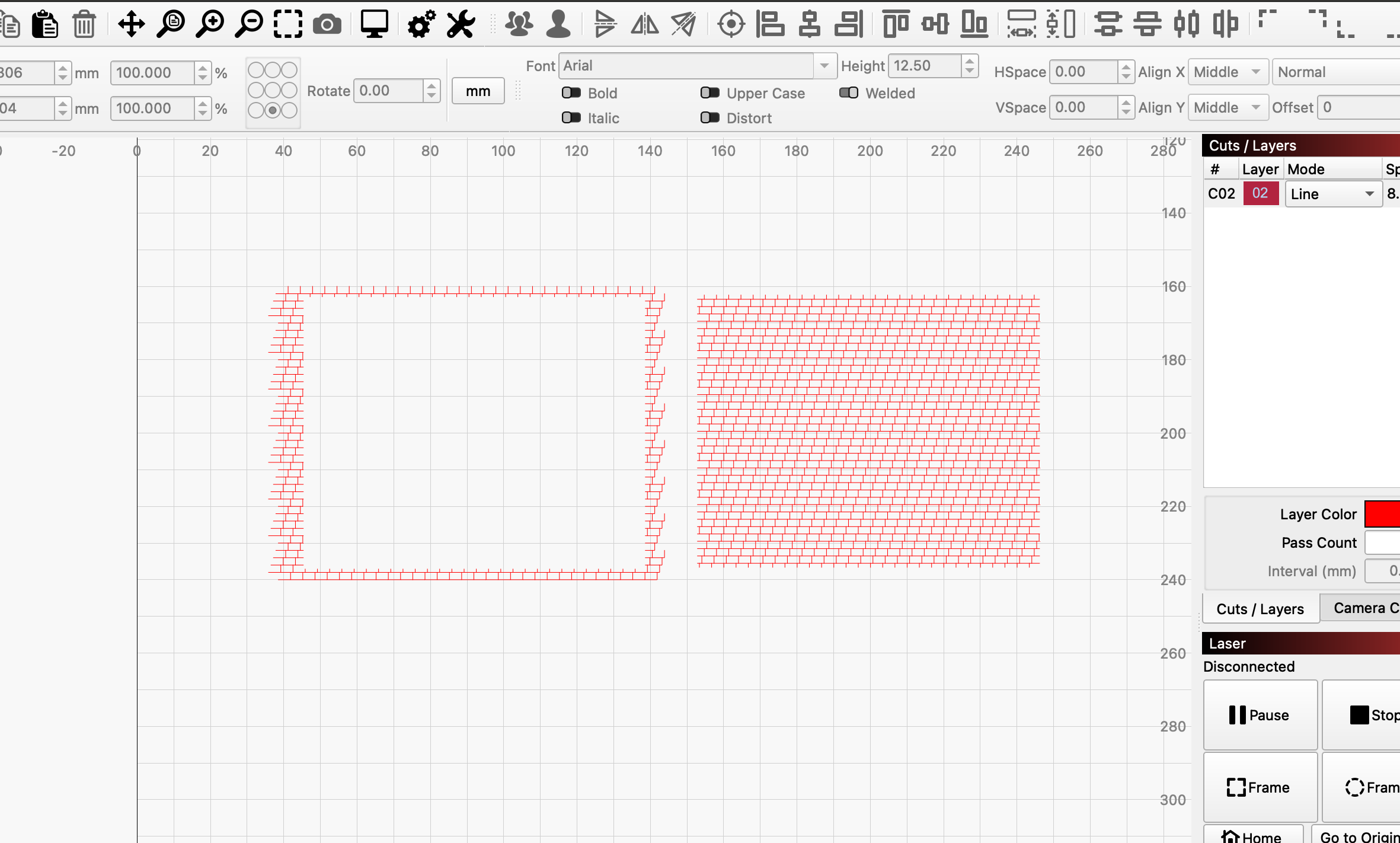

Use the Cut Shapes tool, which requires selecting all the bricks to designate them for cutting:

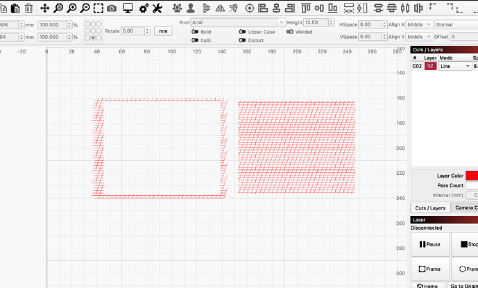

Click-Select the black squareInvert Selection to select all the bricksShift-Select the black square to add itCut Shapes to cut the bricksDelete to get rid of the bricks outside the squareWhich results in this:
Hello,
Thank you very much for your support. The shape cutting tool works very well.
