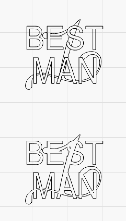

I did use nood editing by hand but its not real clean looking. And offset scanning.

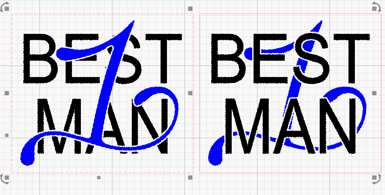

Is there something like this you can use or have I not understood the task correctly?
Are either of these what you’re looking to do? The one on the left, the 1is offse then cut out of Best Man. The one on the right Best MAn is offset and cut out from the 1.
Wow, the top one is what I’m wishing for. I’m amazed at the skill set set you have I don’t even want to tell you how long that I’ve been looking into this.
it’s number two on the right

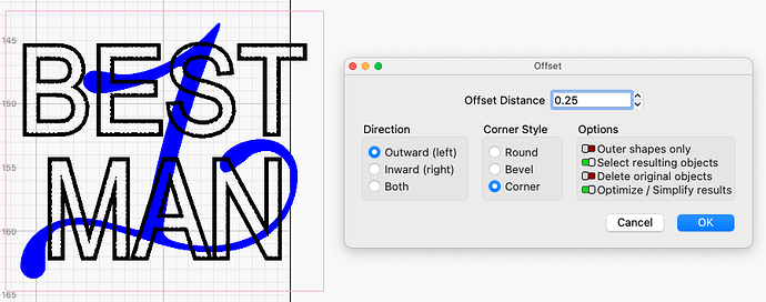

This is how I did it. Select Best Man. Click the offset tool and set it for whatever space you want between the letters. These are the settings I used.

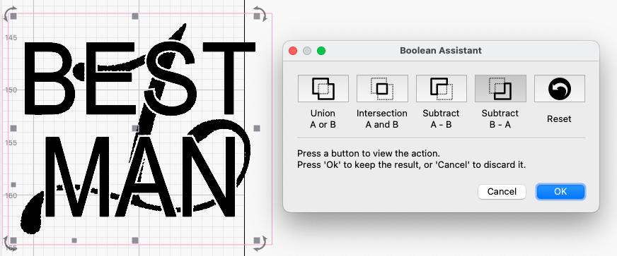

With the offset still selected, shift select the 1. Open Boolean Assistant (CMD + B) and choose the correct subtract mode. Click OK.
You can the select the 1 and change the layer if you wish, or leave it on the same layer.
