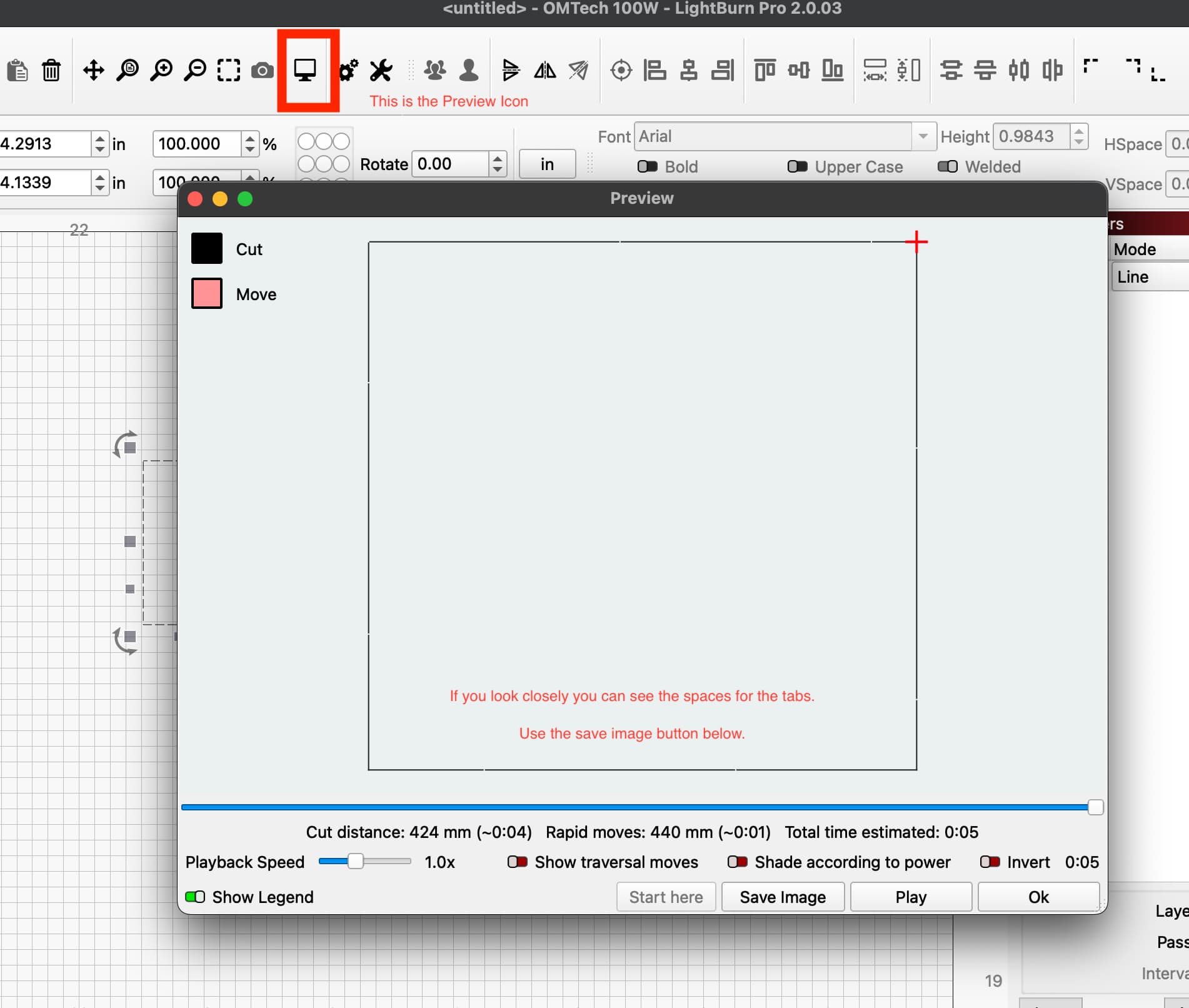

I don’t think that’s possible. Lightburn adds the tab control through the cut settings editor. It’s not part of the geomtry of the shape on screen. They do however appear in the preview window and you can save a .png image from there, but I don’t know if that will help with your “other program”.
Thank you for the clarification about the PNG file! I appreciate it, but I still have one question: where exactly can I see the preview you’re talking about so I can save it, as you suggested?

See below for preview info.
Thanks for the photo. That PNG doesn’t really do much good. As for Wi-Fi, I have a desktop PC 4-5 meters away from the laser. I have two closed lasers, and they have a smoke exhaust pipe that blows out, so I can’t move the lasers or the PC. But since I have Wi-Fi, I don’t have any problems. The only problem is that I can’t use Lightburn. There’s certainly a way to connect it to Wi-Fi using third-party devices, but I’d prefer to continue working like this. I just need to generate these bridges/tabs automatically for complex projects with many pieces, and I can’t figure it out with any software.

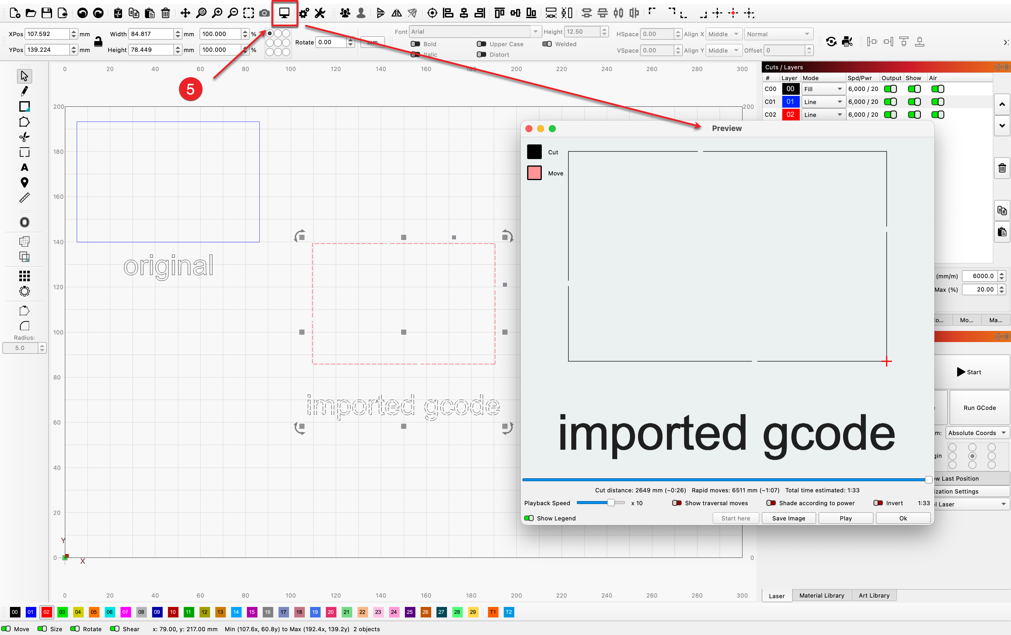

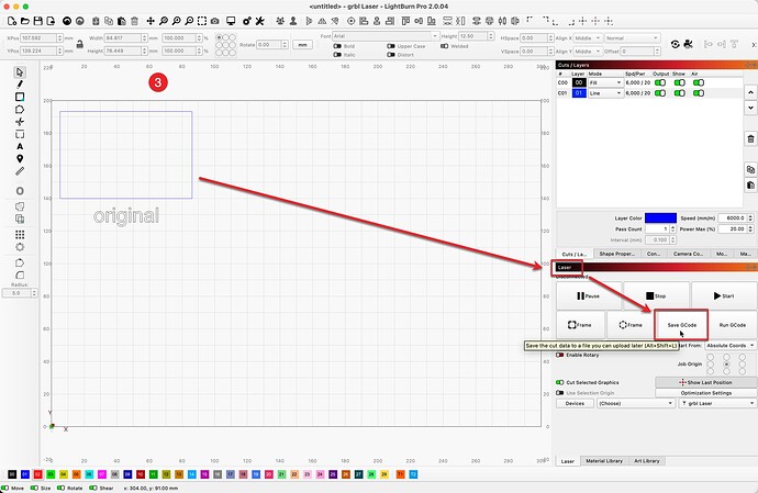

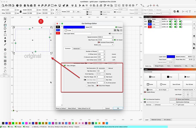

@wolfart, there is a way to accomplish having your geometry show the tabs generated using LightBurn.
After using the ‘Tabs / Bridges’ feature of the ‘Cut Settings Editor’ to place or auto-generate tabs where you’d like, save the file as GCode (ckick the 'Save GCode button in ‘Laser’ tab) and import that file into LightBurn. You will now have the geometry with tabs. :slight_smile:
Please let us know if this approach will work for your needs.
Thank you so much, that’s exactly what I was looking for. You were very precise, thank you.
