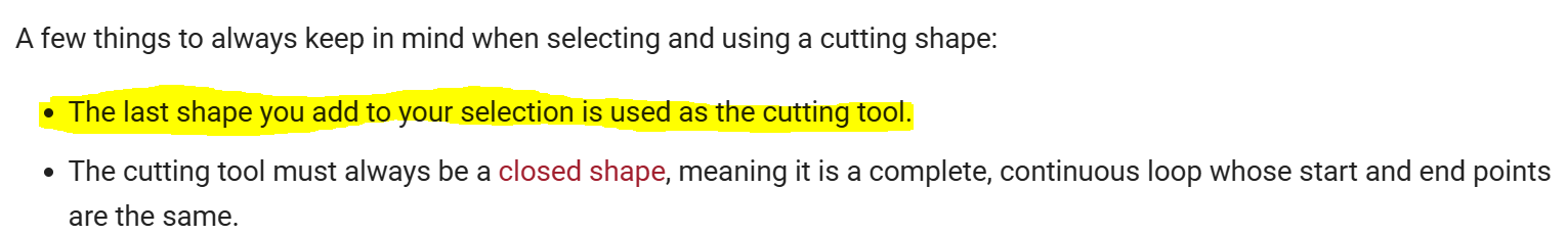

I am running Lburn 1.7.06 and trying my hardest to use the Cut shaps tool.
I have watched tutorials on it, read articles about it , but the Cut shapes will not Aluminat on the tool bar. Please tell me were i am going wrong

Thanks for the link. watched it and have still no joy. All i am trying to do is cut a long picture frame
We are still not able to help - the crystal ball is broken. SHOW us what you want to accomplish, and we can help you get there.

First i selected the red frame then selected the blue cutting frame. go to tools menu to select cut shapes but its light gray not black Hope i have made it a bit clearer and thanks for any contrabution
You only have the blue selected. You must have both items selected. Select red then hold Shift & select blue. You need to have handles around the entire shape.
Thanks you all for helping me. I have managed to cut the picture frame. Happy days
