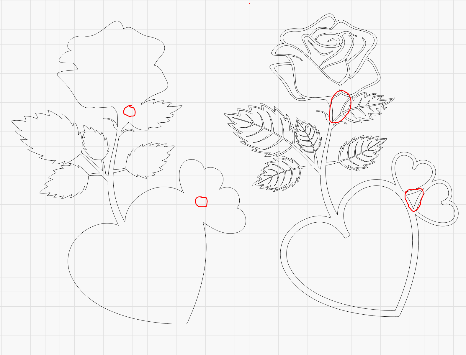

Hi all,
I tried to re-create something I saw online. I basically gathered all the free files I need and designed away. One issue I am having is that it is a 2 layer design and I basically designed the top layer. Then used “Versatzformen” (ALT+O) (sorry I don’t know how it is called in english, it’s the icon below the ruler on the left side of the toolbar) with 0,00 to create the outer shell for the first layer. Now I have the issue that on 2 spots it is not cutting the pieces out, since they are enclosed via the forms…
Does anyone have a suggestion how can I cut those two pieces out, from the outline form?

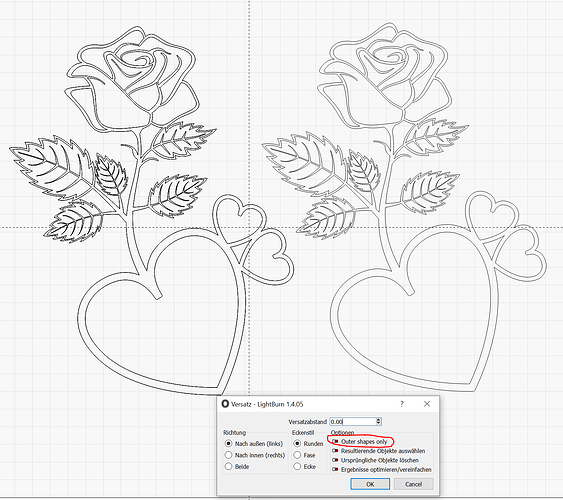

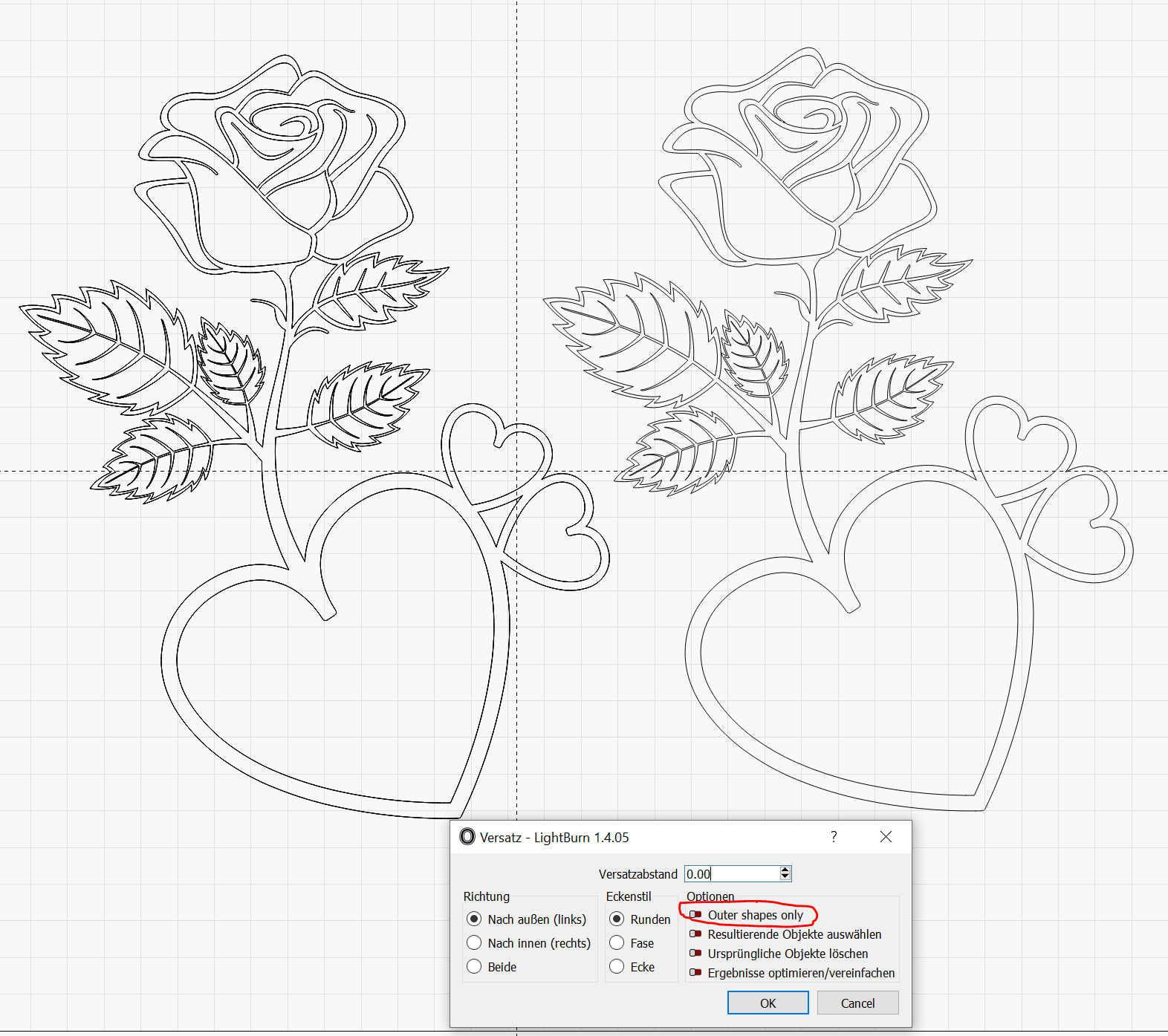

The word you lack is OUTLINE. There is a selection under the outline menu to ignore inside shape. Uncheck that tab and you should have what you need :smiley:
You can see if they are closed Shapes and then give them an offset.
If that doesn’t solve the problem you could send your file up here.
Sadly, when I uncheck it, I get basically an exact copy of the original file:
The result I am looking for is something similar to this:
So I can paint the back and layer the front up top.

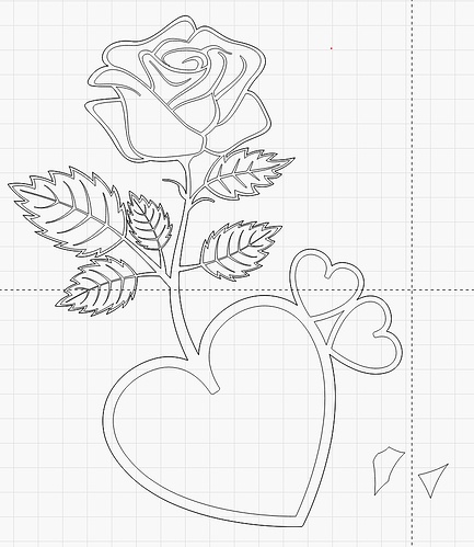

I did ungroup everything, made two copies of the 2 shapes that did not cut out, regrouped everything, then did the outline thing and pieced the 2 pieces back in, then moved the non outline shape away.
So it basically looked like this:
