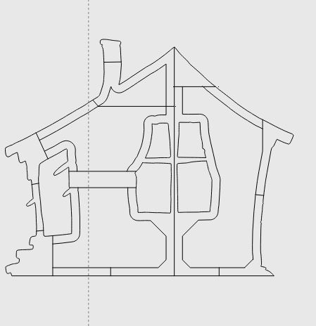

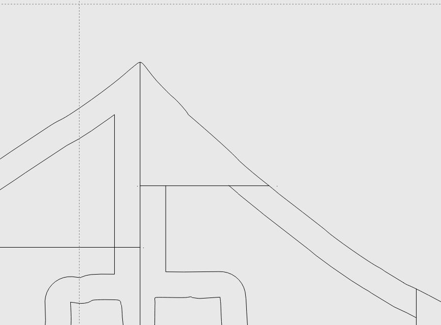

i have the initial out line, than added an off set inserted lines where i want cut pieces
using the cut tool i snip off the overhangs, but its leaving a small segment
and not allowing lines to connect ( not using ctrl when cutting as want auto joining to happen)
if i open file in LB and cut, it remove segment and doesn’t leave a dot, hadn’t noticed it in any of the earlier RCs also nodes dont snap like they do in LB

its happening in millmage only
same file cuts ok in light burn
i have deleted all the dots from that file as i need to get job cut
