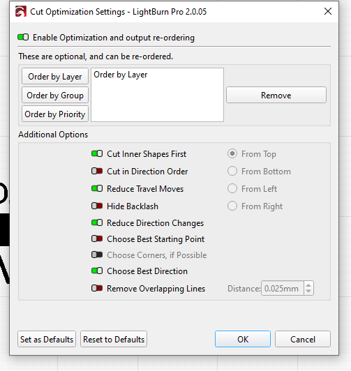

I am running LightBurn Pro 2.0.05 on a fiber laser.

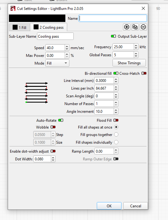

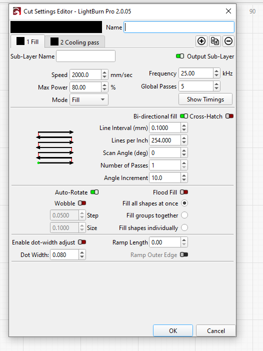

I am etching a sticker that needs multiple global passes and I have 2 sublayers. The first layer etches and the second sublayer is a do nothing cooling sublayer.
At first, this actually did work, but randomly, it is now doing multiple passes on the etch layer and then doing the all the cooling passes.
I have tried:
  • turning off optimizations
  • order by layer
  • restarting the laser and lightburn
Not sure why it is not following the sublayers.

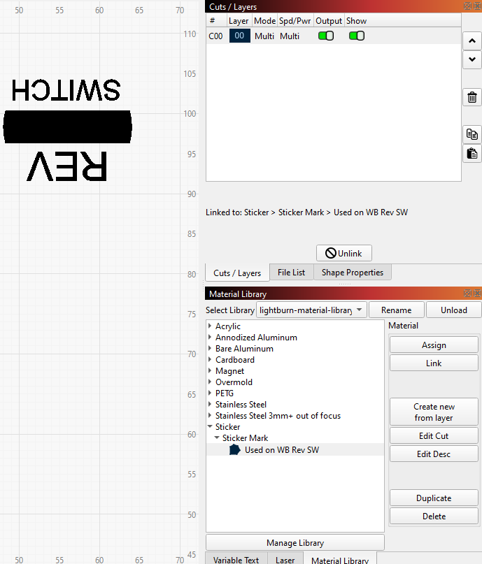

Uploaded my lightburn file:
WB-RevSwitch-FOR-LIGHTBURN-FORUMS-TEST.lbrn2 (26.9 KB)
