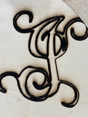

I need help with the settings to be able to cut 1/8 wood for like monograms you hang in your car. All it’s doing is burning the smaller letters instead of cutting it out. If I could upload a picture to show anybody I really need some help.
You bet! Post some pictures. do your settings work to cut out large letters?
I was doing 170 speed 70 power and it burns sometimes. Also how far dose the laser have to be from the wood?
These are what I’m wanting to make!
In the third pic - I can’t tell if the variable darkness is adjacent or overlapping lines.
are you willing and able to share your LightBurn File?
you should be able to upload it the same way you uploaded the pictures.
Which Atomstack laser engraver do you have?
I’d like to confirm how the Atomstack is focused.
