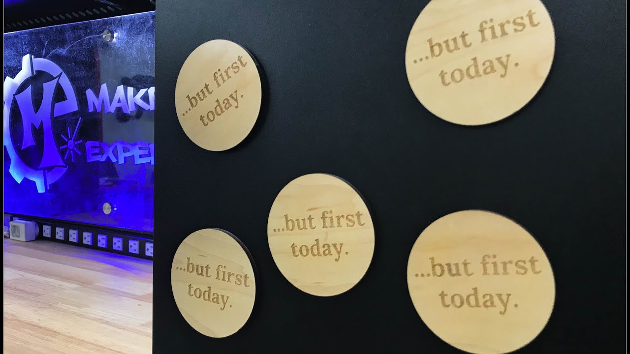

Alternatively, buy magnetic rubber sheet and apply your chosen substrate to that.
https://www.aliexpress.com/item/32970752121.html
I’ve used this, it cuts fine and you can stick anything to it.
Tech tip: don’t engrave your substrate while it’s on the magnet - engrave, bond, then cut.
Heat will remove the magnetism from the sheet. Cutting is fine - it will be demagnetised only in a small area around the cut line, but engraving will make the magnetic properties disappear, leaving you with expensive rubber sheet :slight_smile:

I may opt to engrave and cut the pieces and then glue a small neodymium magnet behind it
