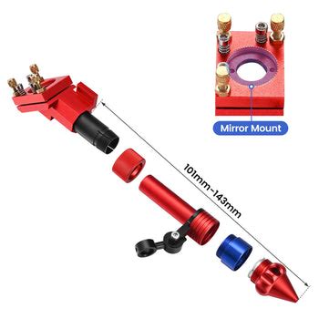

I had my laser head bump a piece of material and it tilted it on the X-axis..
So naturally I had to loosen the head and realign it vertically so the laser beam
would again cut properly…
While I was aligning the vertical beam (plumb)… close to material and then at distance, usually I use 50mm.
I started thinking about the last few straight pieces of acrylic I cut…
Some along the X axis, and some along the Y…
I used a straight 90deg angle sitting on the bed to plumb the laser nozzle, as most do…
I decided to test the angle by setting a 100mm x 10mm piece of acrylic on edge an setting power to 50% about 70w and cutting along the Y axis, back to front, I looked at the angle of the depth cut angle and noticed it was off just a bit.
so even tho I had plumed the laser head best I could, it was not Plumb as the
beam travels thru the laser tube…
So I adjusted the Laser cut angle to near 0 deg and cut a few long acrylic
pieces along the Y axis, back to front.
then I did the same test on the X axis and found there is also a very small angle
creating A cut angle, but this axis has no adjustment, as of yet..
I was an interesting task, as I assumed if I had the laser nozzle plumb the laser beam would also be plumb …
lesson learned, check the actual cut at depth to ensure the beam cut is plumb
and use the 90Angle to get the laser nozzle as close as possible as a starting point. :slight_smile:

I just need to shim up the Y axis movement about .3mm
then in both directions it is plumb…
I try to keep the pulse spot on target at close and upto about 50mm off the material … this keeps it cutting square in the X and Y axis… almost there…
Just out of interest, Is that a pic of your monport head, and could the collision have compressed the threads at a weak spot…just by a fraction, but enough to show over distance.
I have actually, redesigned my head some… but yes that is the Monport head…
and it wasn’t a ‘crash’ so much as a bump…no damage just tilted the head enough
( a couple mm ) to require some attention…
I am cking the Y Axis today with some test cuts…at depth…
I know X axis is good from testing yesterday…
