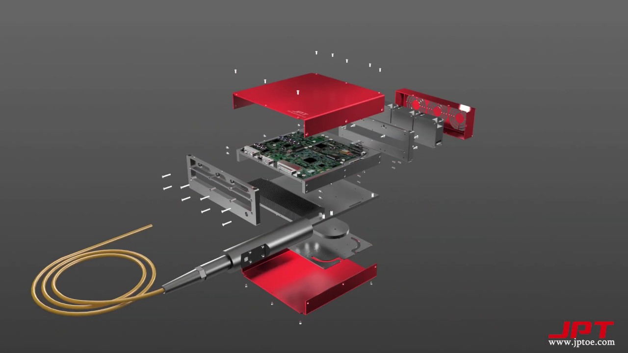

Yes a fiber is a bit more complex than a diode or co2. All lasers require some type of medium to amplify the frequencies. Co2 uses the gas mixture excited by DC (or RF) to raise the energy levels.
Here’s a good video of a JPT fiber with it’s pump diodes. The frequency of the fiber output is controlled by both the fiber type and the incident angle of the pump diodes with the fiber.
So yes, they are more expensive and physically larger in size.
