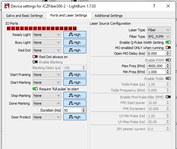

Good morning, thank you for your feedback, unfortunately the problem doesn’t seem to be 100%, the situation is that I put an example of 20% which isn’t meant to mark anything, I set it to cut and it actually makes the cut at 20% then I change it to 100% and I send the cut and the laser shows 20%, I have to go into the box several times and change it to 100% or 90% only after changing it several times does it respond to 100% or 90%. So in this situation I don’t know what value is coming out of the laser.
Good Morning, Emerson
As mentioned above, need model number and other info listed, also, screenshot of this screen here. Device Settings > Ports and laser settings.
