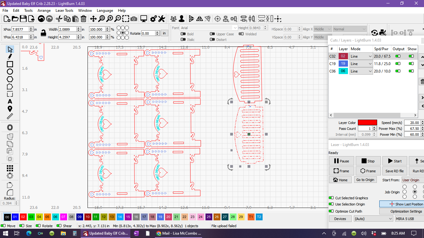

I recently updated my LB on Windows 10 to 1.4.03. Since then, previous files saved on my Aeon 5 cut perfectly. Newer files since the update are not cutting through at all. How do I fix this? Do I need to do a test again to check my cut settings? Or, is there a way to go back to the previous version?

Can you take screenshots of an old file vs a new file? Please have the Cut/Layers Window visible in the screenshots.

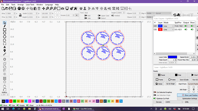

The first is one that cut. The second I just tried this morning and it didn’t go through.
You are using different units there. One is inch/s, one is mm/s. That’s quite a difference :slight_smile:
But the first window lists a grbl laser type, is it a diode then? I don’t know that laser. Then mm/min would be the best units. Otherwise, it’s mm/s, I guess.
I stupidly changed it and now it’s just messed me up lol. No, I’m using the Mira 5. I just pulled up that file in LB, but didn’t change any of the settings as if I was going to cut it.
I believe I was using inches. Because, the number is smaller than mm’s. I thought that might be an issue, but changing it back didn’t seem to work either. It’s a mess…I’m a mess lol. It’s a simple thing, I just have to straighten it out. Glad it isn’t a update issue then.
