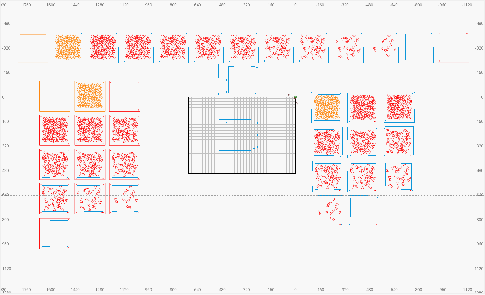

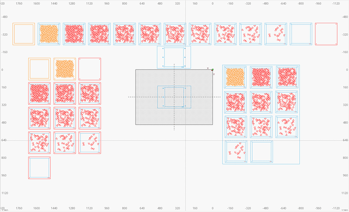

I generally have a bunch of layouts scattered off the workspace and just drag the appropriate one into position as needed:
The template in the middle of the platform is on a tooling layer (so it will never go to the laser) as a snapping target when dragging the next layout into position. I align the template to a fixture on the platform once, snap successive layouts into it, and burn each one without any additional fuss.
