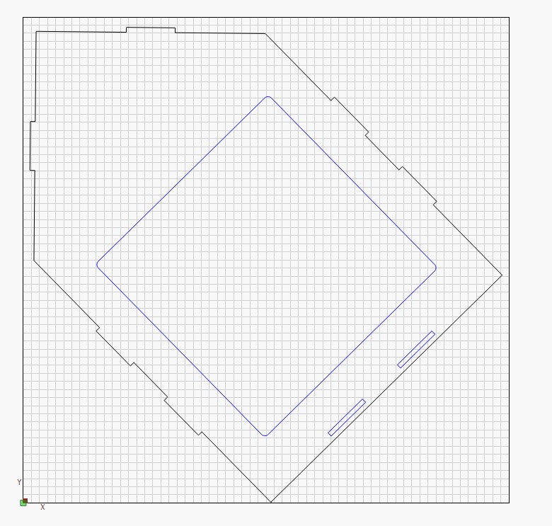

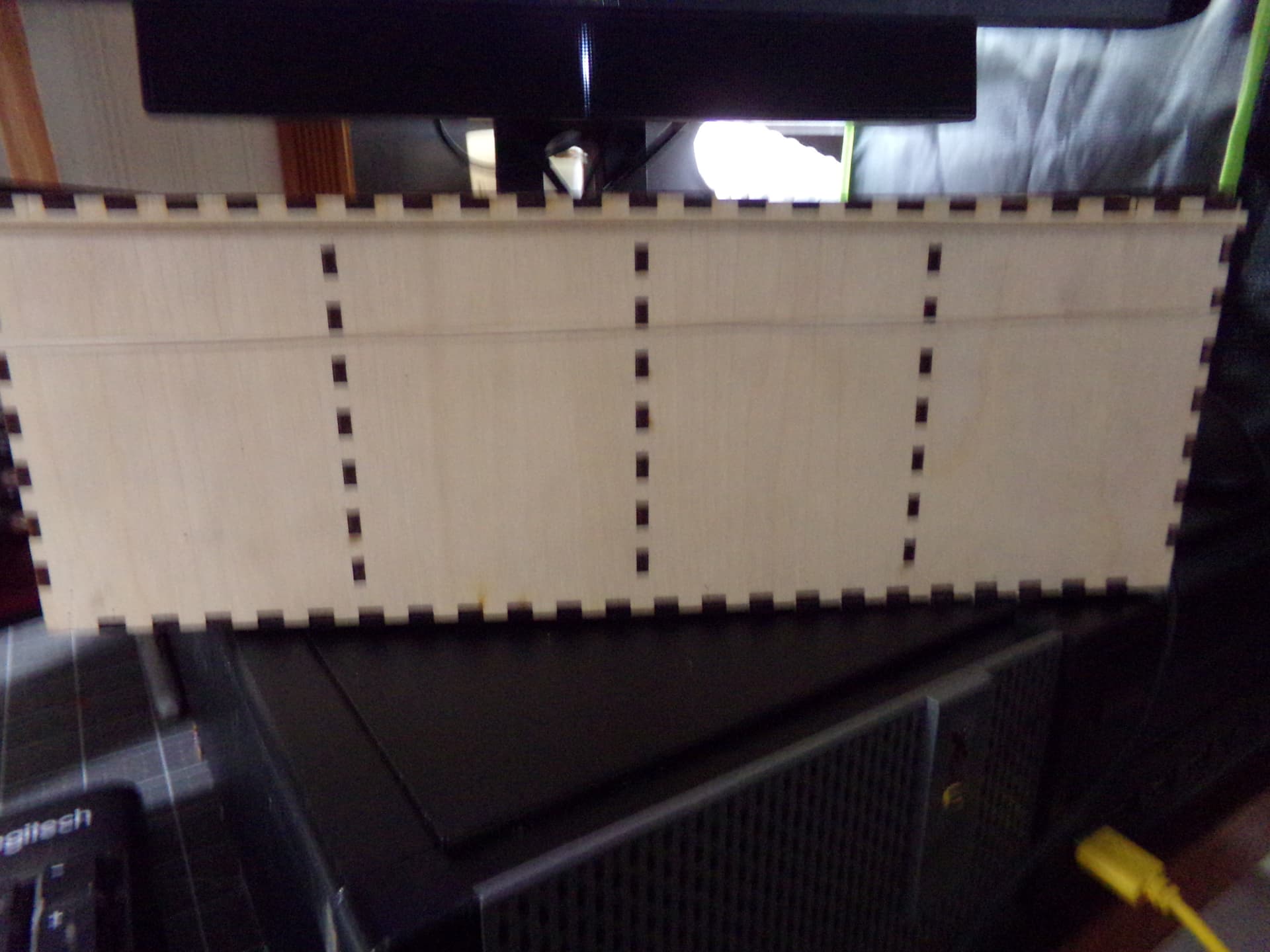

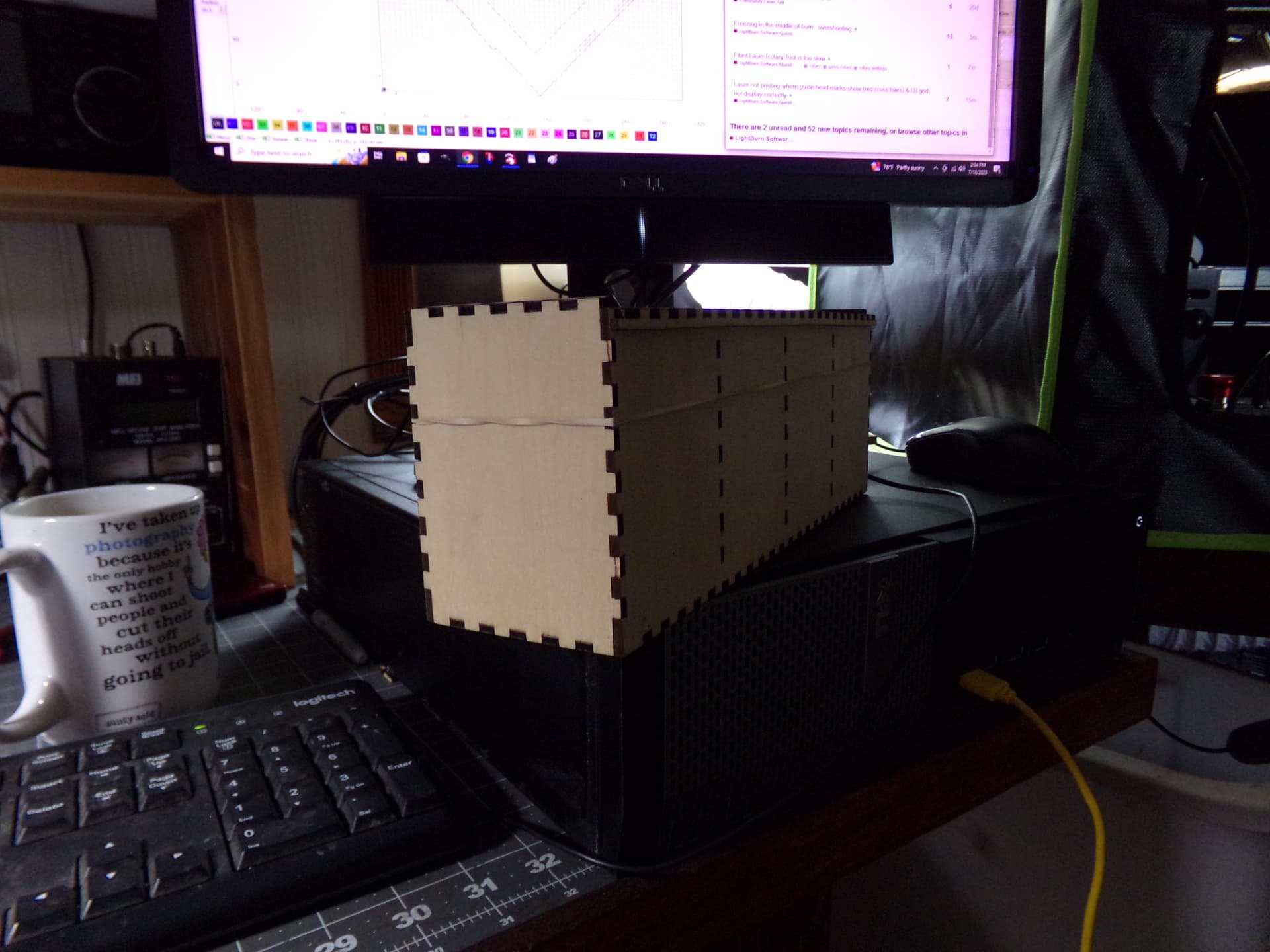

I got the card box (1&2) done and it went together with no problems my next project is a bird house and I have a question on the size of the graph, does it matter what size the graph is in relation to the actual size, If I have the width and height set say at 100mm this is the size it will cut even if the graph is say 50mmx50mm.
It’s great that you succeeded with your first attempt in cardboard.

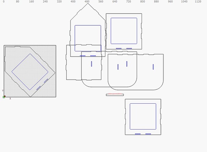

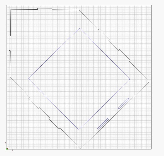

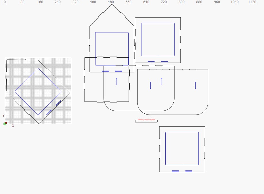

I used plywood 2.88mm and the plan called for 3.0mm, before I assembled the parts I used a finger nail file to give the fingers a light touchup which worked just fine. I am not sure how to put this but the screen shot shows one side of the bird house which has dimension of 200x200x200mm, if I were to use my scroll wheel and shrink the graph so I can get the whole plan on the screen, I can then pick and choose the arragement of the parts to maximize my usage of the material. Doing this will it affect the X-Y and height of the plan. (see screen shot)
I do not think it will. Thanks for the complimant and instructions.
No, you only change the overview. What are you going to do with the 2 largest parts that are bigger than your work area? - Print and Cut"?
In order to adapt the drawing to the material, I will, as mentioned before, adapt the drawing. 2.8mm is 6.667% smaller than 3mm, i.e. you must enter 93.33 in LightBurn’s (proportion-locked) percentage field (after you have selected everything) and everything will be adjusted automatically. I don’t adjust the fits manually, I know how wide my laser beam is and compensate this value in the kerf settings. If you don’t adjust the kerf, it should be a loose fit.
The 12x12" boards I have wil allow me to place the pattern on the board at an angle and it just fits the laser, my biggest peeve is the constant adjsting of the cutting platform, and the frame of the dust cover.
