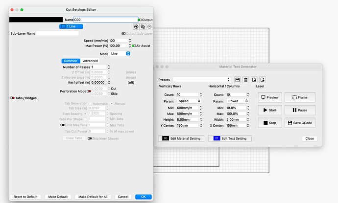

I have many different materials that I will be using and, thus, many different test cards. But I can figure out how to activate the cut path. There are options for engrave settings and cut settings. The engraved worked as expected. But not the cutting of the card and no cut path is displayed on the preview. What am I missing?
When you edit Material Settings are you explicitly choosing Fill or Line operation? If not, switch from Fill to Line.
It is set to line.
Using a GRBL profile, when I set the ‘Material Test’ to ‘Line’, I see the following from ‘Preview’.
That’s odd.
I’m seeing what @Rick is seeing.

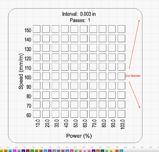

I do see the same things, but maybe I was not clear.
I was looking for the border around the project. I know I can manually try to line it up, but I figured that since you guys designed the Material Test, I was missing something because of the added Edit Material Settings. This would make each test project exactly the same size.
Understood, and thank you for the suggestion. I did note this in your OP, and presented to our internal channel for consideration. Thank you again.
