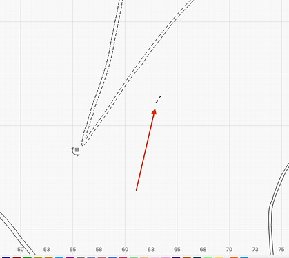

I started with a photo of next year’s ornament sketch (a chickadee), which I imported as a JPEG into LightBurn. After descending the learning curve a bit I managed to create a cutting outline and smooth out the perimeter irregularities in the sketch for a smooth cut. I then started doing test burns to determine an optimal speed and number of passes to completely cut out each ornament in this stock (100% power, 275 mm/min, 3 passes).
This is where things get confusing. When I select my 3 passes, Preview will show 6 passes, 3 in one direction and 3 in the other (and a test burn does the same thing, of course), and I can’t find any setting or reason for this. Even weirder, when I replicate the chickadee for an 11-up cut (about half my eventual 400x400mm layout) and choose “Cut Selected,” selecting one or a few and previewing will show the number of passes I choose. However, if I select one too many (or all), it reverts to back-and-forth doubling.
What am I missing?

The reason delete duplicates doesn’t find them is because they’re not actually duplicates, just very similar and close together.
I assume these were scanned from a drawing. That would create lines for both the inside and outside of the scanned line.
no, that is not correct! sorry

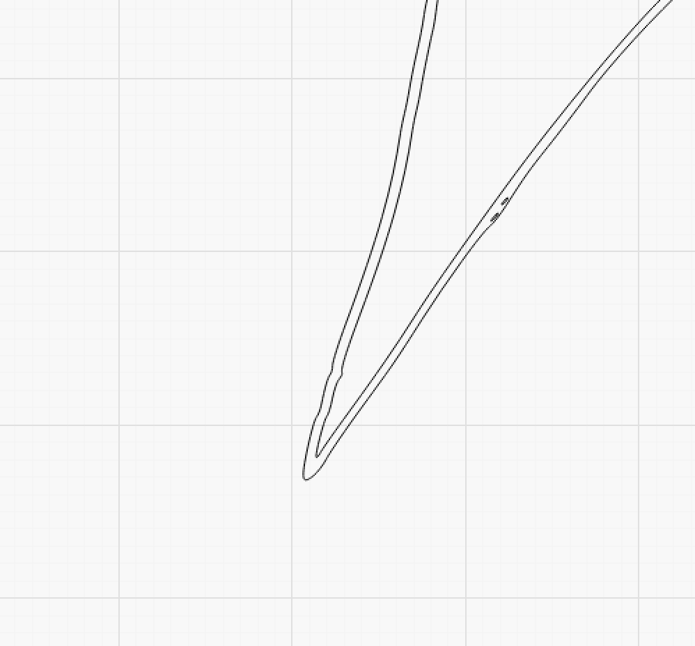

You have traced your birds and have 2 lines per bird, I only saw it now.
It surprised me that I could not mark all the birds on the top and delete them and by enlarging the image it becomes clear.
That’s not happening for me, and I only have one layer (baby steps; I haven’t knowingly ventured into multiple layers yet ;-). Are you seeing layers I’m not? How about uploading your duplicate-deleted file (with a name change to avoid confusion) so I can compare and confirm?
Oops, our replies crossed; it’s becoming clearer now…
also note that you have small remnants from your scan which will also be cut out if you do not delete them
Yup, I enlarged and can see them now (and can delete the second lines and artifacts). I still don’t understand why my selection scheme affected the one-or-two-pass result. Any ideas?
Oh, I figured it out; clicking on one outline just selected one of the lines, but dragging selected both.
