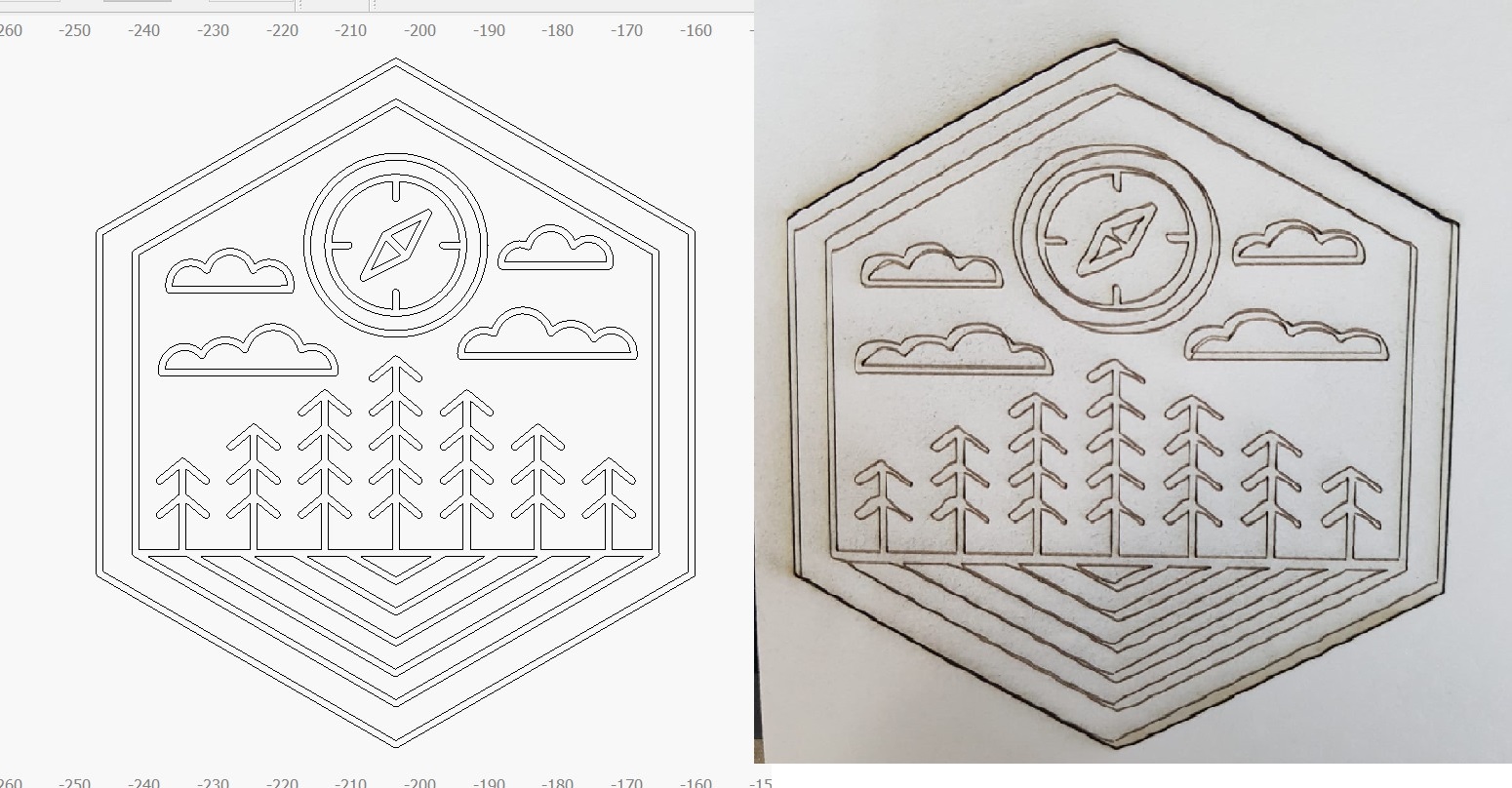

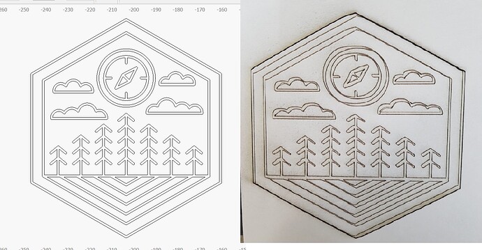

I have elegoo laser machine 20w and I am using Lightburn software. there an issue with cutting result not same the drawing .
should I do any adjustment
with the machine or the software?
That’s the machine. The mechanics is not tuned as it needs to be. Check this guide and go through every step: Guide to mechanical adjustments and maintenance
