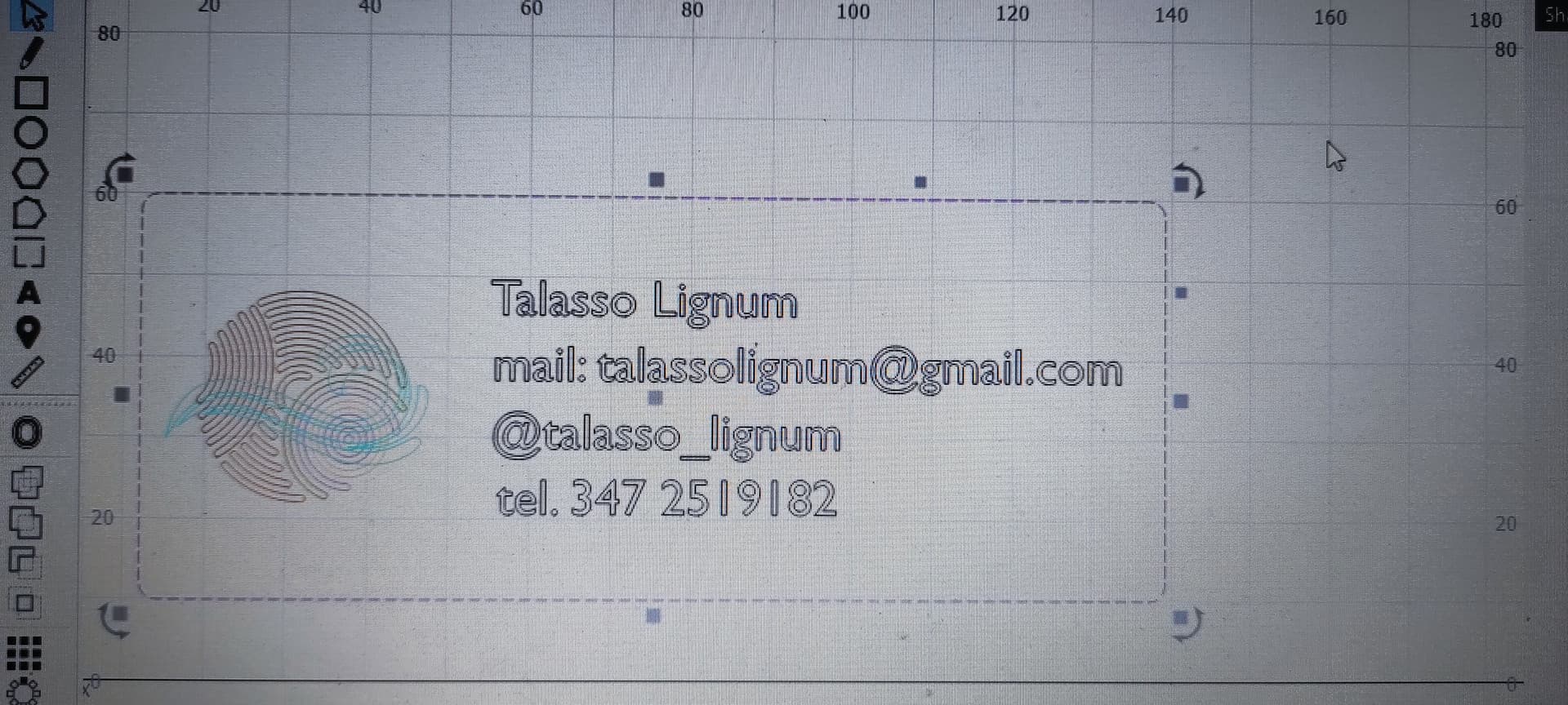

Hi there … newbie here. I have engraved my new logo and social media contacts but when i come to cutting rounded corners this is what is happens. Lines are not straight. Maybe the picture i uploaded gives a better feedback. Any suggestions? Project and Result pics included.
I would first check my belts for proper tension. May also be a speed/acceleration problem.
Resolved! There was a loose belt and slowing down the speed worked.Thanks!
