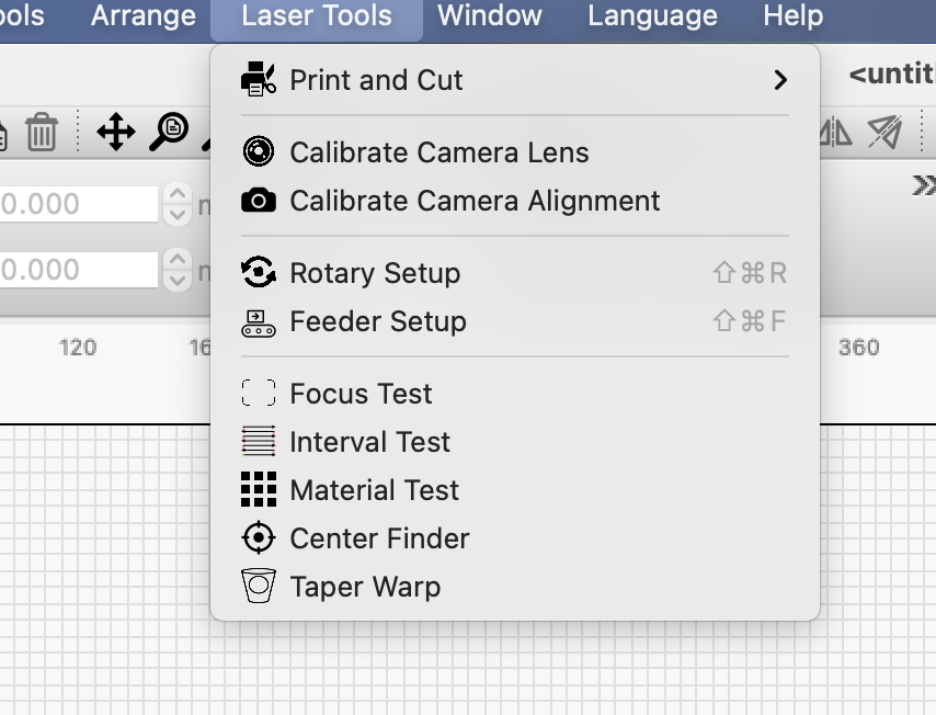

Thank you Bernd. Where can I find those lightburn tests and I’ll get experimenting?
Focus, Interval and Material Test you will find you under Tools
I don’t really use the Lightburn materials test for cutting. The materials test makes boxes and you can figure it out with ranging the speed/power. When cutting vectors, interval is of no use.
