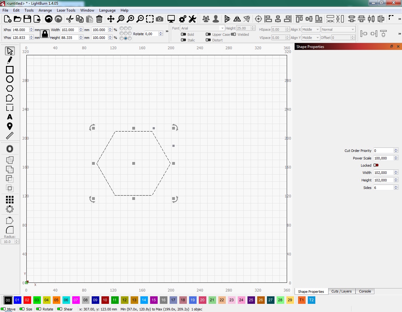

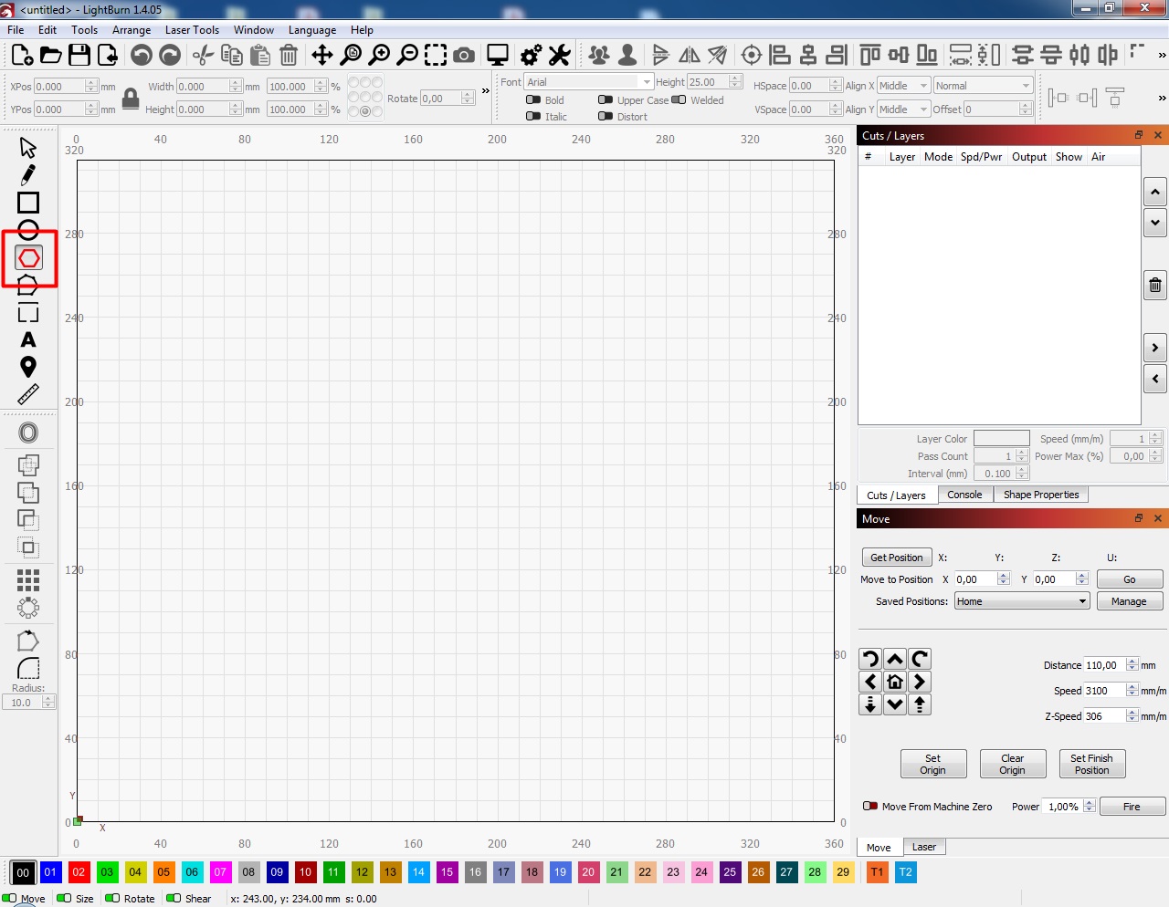

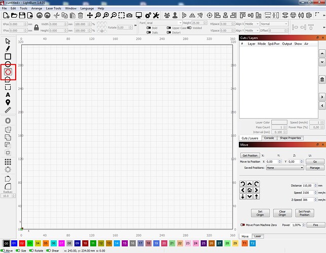

I started by selecting the “Rectangular Polygon” tool
Draw the polygon, opened the properties window

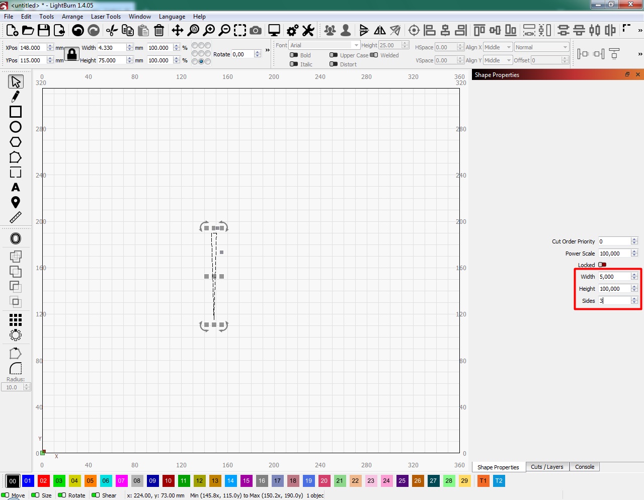

and put the values I wanted in width, height and put 3 in the number of sides. This changes the 6-sided polygon to a triangle with the width and height specified in the previous fields.

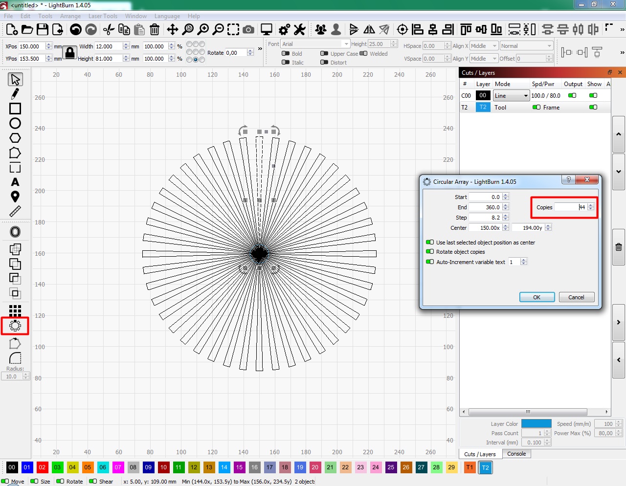

Then it was basically following the example given by @bernd.dk to make the “Array”.
Draw a circle as a frame and centre it on the vertex of the triangle.
and I made the “Array” selecting the number of copies that I liked.
Basically in 4 to 5 steps… :slightly_smiling_face:
