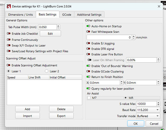

Can you show a screen shot of the Device Settings window for your laser, for the “Basic Settings” tab?

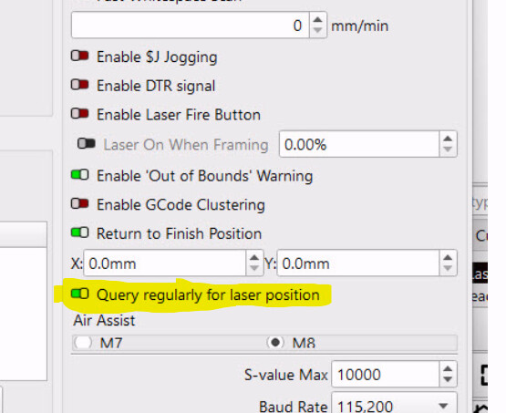

One of the few things that changed for this release was this:
Try turning that off and see if it helps.
What brand of laser / controller is this?
CXXXV
(Paul)
November 14, 2025, 9:52pm
6
Laser Tree K1 PRO. 30w laser.

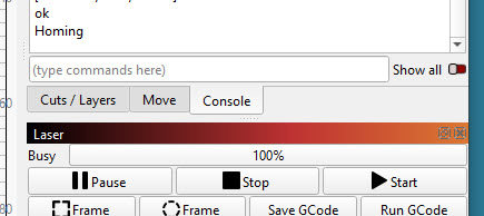

No change even after deselecting option. I used LaserGRBL with same file and it ran fine. The pic below shows what happens. It gets stuck on 100%.
Clearly there is something wrong with LB 2.0.04
