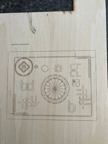

I burned at 10,000 mm/min and 95% power on a scrap piece of luan
The design is severely distorted:

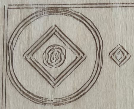

It has a lot of backlash in the X axis:
Check for loose screws in the X axis drive train, starting in the motor pulley and going all the way to the laser head mount. The X axis belt may be far too loose or anchored incorrectly. Make sure the laser head is securely fastened to the belt carrier.
Assuming it’s this machine:
Then 10 m/min is probably much too fast for the frame to handle.
After you find and fix the mechanical backlash, then run the test pattern with the speed reduced to 2000 mm/min and the power to 20%. If the results look good with less vibration, you can experiment with higher speeds.
