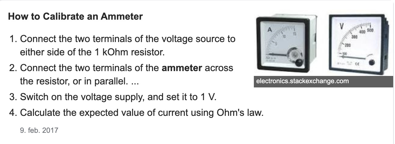

People put so much faith in an uncalibrated Chinese ammeter - I’ve never worked out why.
Still learning ![]()
Calibrating an ammeter is no big challenge
But using a co2 laser machine (K40 / 50 …) without ammeter is a challenge that ends up with a much shorter life of one’s tube.
And even with a 10% deviation from a Chinese ammeter, it will show “good enough” for our purposes.
