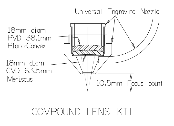

Anyone tried to cut with a compound nozzle on Omtech 60W
My compound is only 11.5mm off the surface, so I’d have to bump the pressure.
The drawback is the a more shallow ‘depth of focus’, so it won’t keep a tight beam for any depth.
I’ve done many engravings with the compound and cut it out with the 2 or 4 inch lens. I do a lens change after the engraving…
No different than my little cnc making pcb’s. do a bit change, usually three times on the same pcb… The right tool for the right job.
I found that it took more power or slower with the short lens than any of the longer ones. So I don’t use the compound for any cutting…
Try it, maybe you’ll get a different result :crazy_face:
I have a compound lens but don’t have an Omtech 60. What question or point are you making?
My original question was…Has anyone tried to “cut” with a compound lens setup.
We are talking about the two stacked lenses from Cloudray? I read somewhere that you aren’t suppose to put a lot of power thru them.
So I’m going to avoid cutting. I think they would do a crappy job cutting anyway at a focal distance of 10.5mm. From what I’ve seen they do a great job engraving.
You can research for yourself as there is a good article covering their engraving lens on the cloudray site.
They are for a fine point, so you wouldn’t think to put lots of power into a fine engraving. I tried all kinds of stuff with these lenses and keep going back to the same setups.
