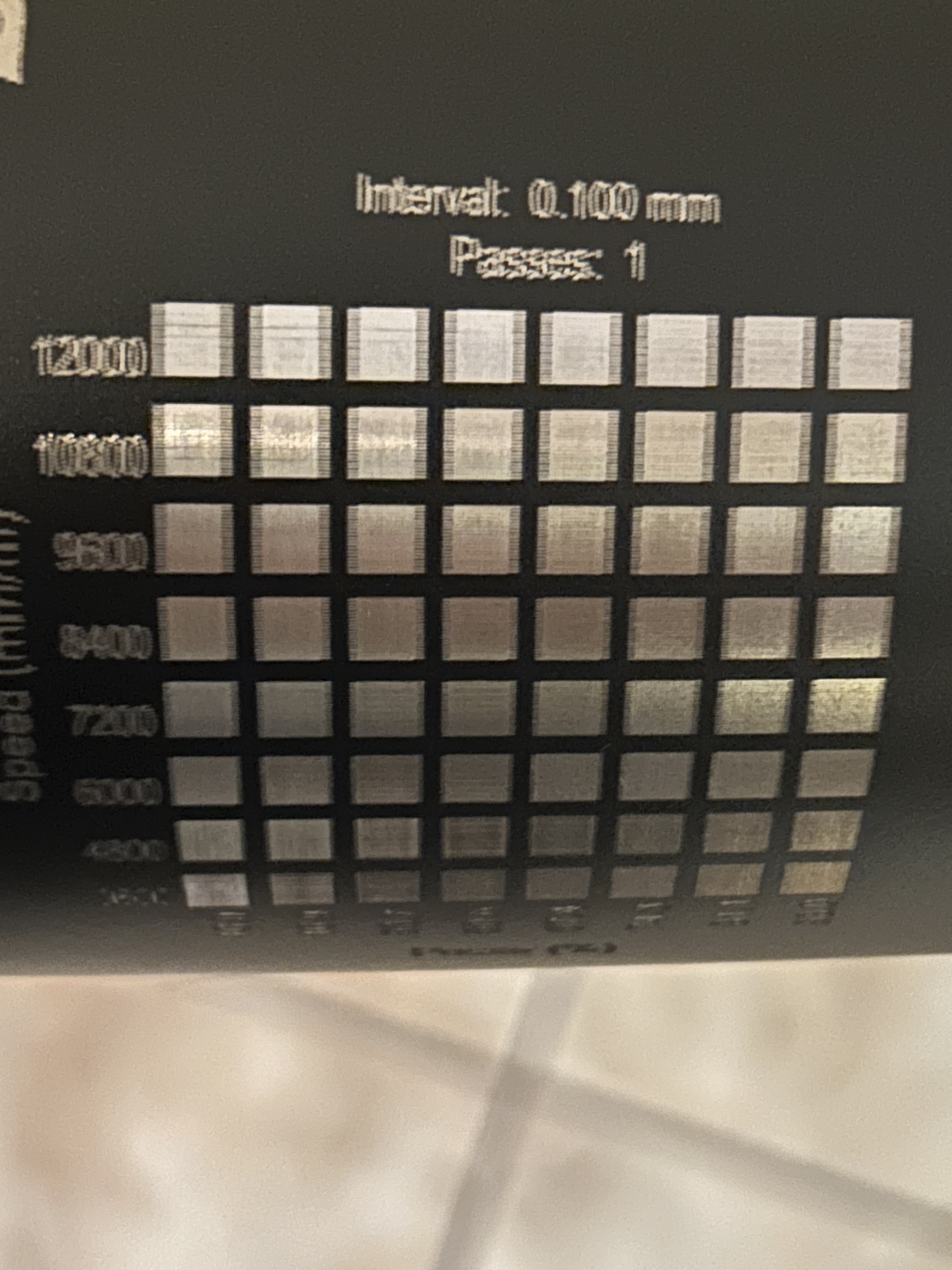

Has anyone had this issue with an Xtool D1 pro? Was working fine and now the rotary engraves “blurred “
It’s the offset scan… If you notice, each scan line is offset from where it should be.

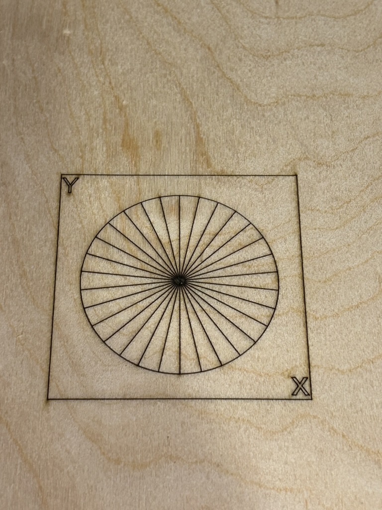

Run this on a stock machine - Non rotary
maybe on a bit of cardboard
And send results please
Dot Test with Angle.lbrn (46.3 KB)

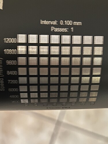

Thanks I’ll keep messaging with the offset. It was at 4% and when I changed it to “0” it was worse. Does it make sense it only does this on tumblers?
Will do thanks!
perfect when not using the rotary

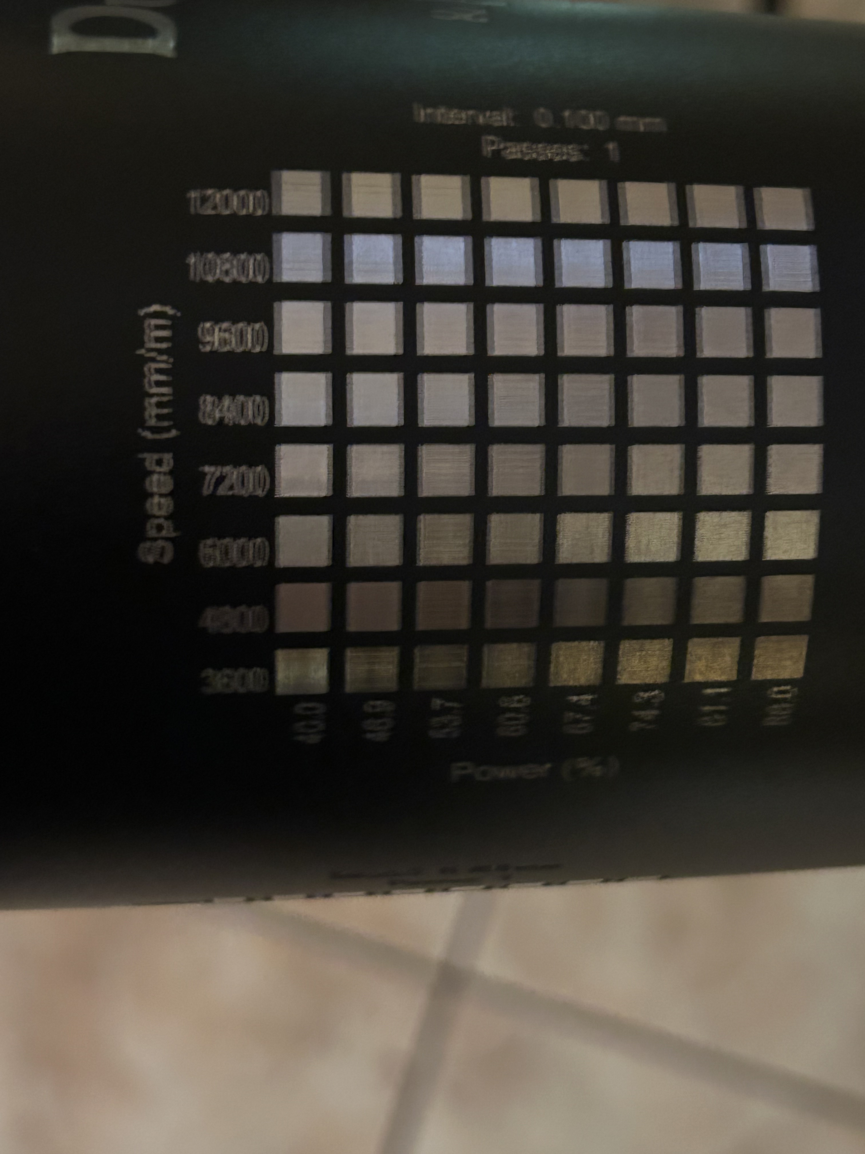

Question, could you cover a round object on paper and do the test again but on rotary
Also a image of your overall setup.
Thinking something mechanical might be happening as you maybe raise machine to accomodate the rotary under it?
