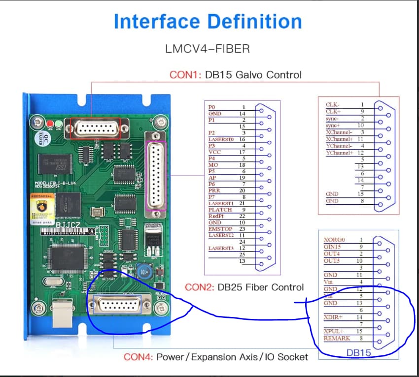

I think I have found what is missing : I am now looking for the correct stepper motor driver that is compatible with my laser controller card (FBLI-B-LV4 A) for the D80 rotary chuck as this seems to be missing
Can someone help me which stepper driver I need to buy that works on the FBLI-B-LV4 A control card to make the D80 rotary work?
I have found DM542 seems to be a good driver.
I would then have to put this between the controller card and the stepper motor
I use the DM542 for all my projects, solid microstep driver for any stepper 4.2A or smaller. 5V-24V inputs no switching or resistors. Question though, sounds like you have a 4 pin connector on the back of your machine, or you would have had nothing to plug your rotary into. Sounds like you opened the case and there was no microstep driver. So question, was the connector wired to the BJJCZ board or not connected to anything? Assume it is a aviation type GS16-4?

What is commonly called an ezcad2 or BJJCZ Lite board, comes with or without axis extension. You can tell by the A after the barcode. Was that way a couple years ago anyway.
If your board has 4 DB connectors, it is a “Standard” board. Difference is Lite is around $250 and will control 1 external axis. Standard is around $850 and will control 2 external axis. Then there is the EZcad3 board costs twice as much looks completely different.
This video is old, but a must watch if you are wiring a microstep driver to a BJJCZ board.
So it’s interesting, when I do anything CNC + on the board goes to + on the microstep driver, but with the JCZ board + is the common and pulse+ and dir+ from the board wire to the Pls- and Dir- on the microstep driver. Jeffery notes this in his video when he points out his setup was originally using pin 11 as the common which did nothing.

Controller card if different than on the invoice : BJJCZ LMCV4-FIBER-M REV : 20171014
The power and digital signal connectors for the driver for the stepper motors are there, all labeled as well.
I guess the only thing I will have to do now is check the diagram of the controller > Driver > Stepper motor connector (4 pins) and swap what is needed to make it all work.

The LMCV4-FIBER-M seems to be able to control two motors I think, so if I want to add another one later (with it’s own driver again) to move the gantry up and down for better engraving control, I might still consider it.

I can’t see the whole thing, but I think that is still the “Lite” board, 1 motor connected at a time.
Only difference with the DM542"T" I think is you have to switch between 24V and 5 V on the inputs. The DM542 is 5V-24V no switch. I’m pretty sure either one will be fine.
If using the same terminals on the main power supply for both laser source and microstep driver, really be careful about getting all connectors secure. I see builds with added hot glue over the completed terminal connections.
My layman’s take on it is you are adding up to 4.2A to the PS, look at what the Laser source draws and make sure you have some wiggle room. Set your microstep driver equal or below the stepper motor’s rating. Set dip 4 to half holding amps. The rotary will likely draw less then full, but it is turning on and off and holding (quickly and a lot) the same time the laser source is under power. I only know enough about this to be dangerous, just be aware.
