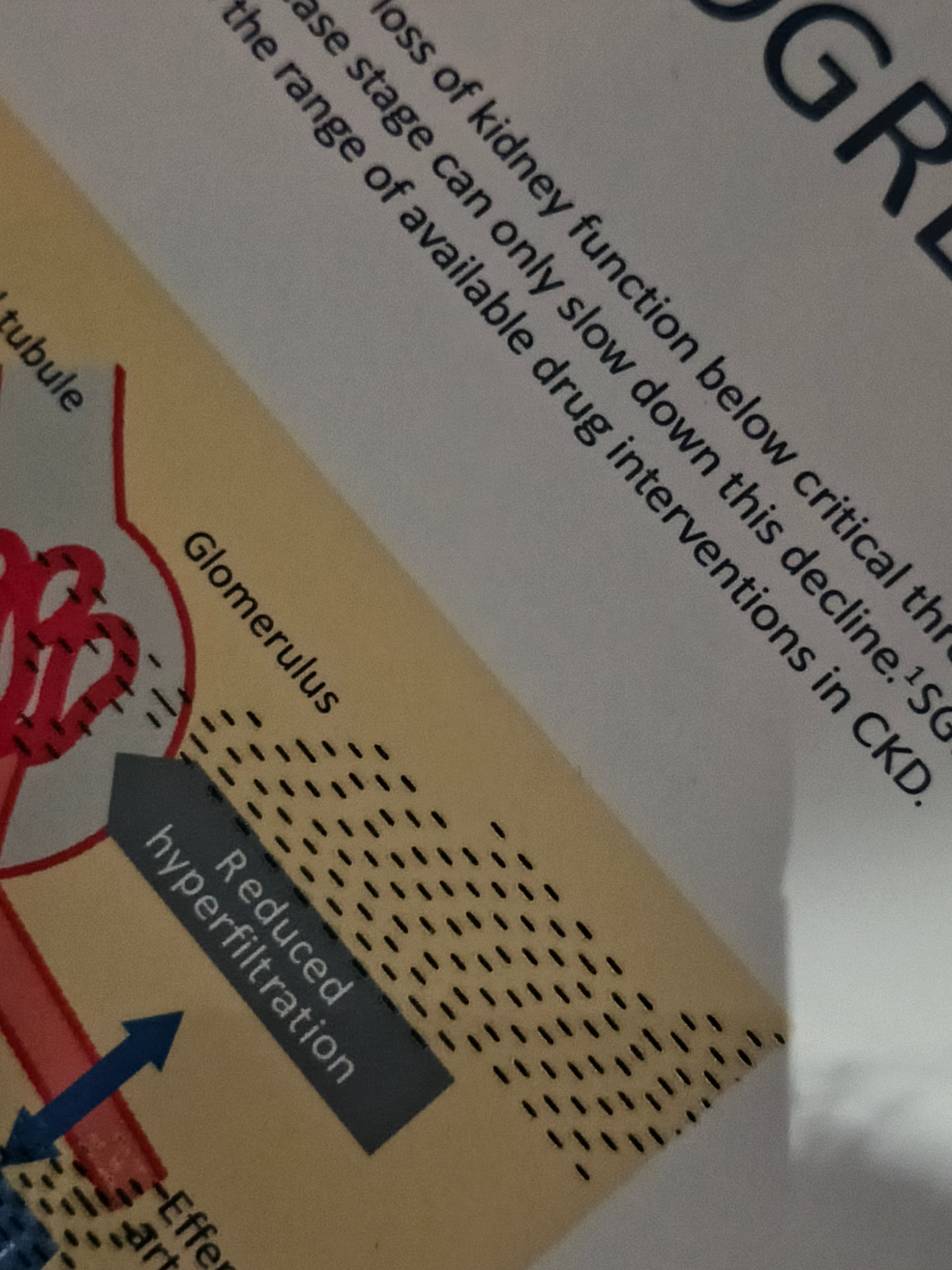

Good day!!
I have been using twotrees tts 55 pro with my old computer no problem. Just now i installed lightburn on my new laptop and wanted to engrave names on my new pen. As a sane person i tried to sample some words on a piece of paper. Problem is whenever i start engraving it only do dashed lines. Framing the word moves it on my desired location no problem. But engraving is a different matter… It makes dashed lines and somewhat engraves bigger than my desired object. What am i doing wrong here?

It almost looks like you have perforation mode enabled, it would be helpful to see your file to confirm.
Do the dashes appear in your preview window?
