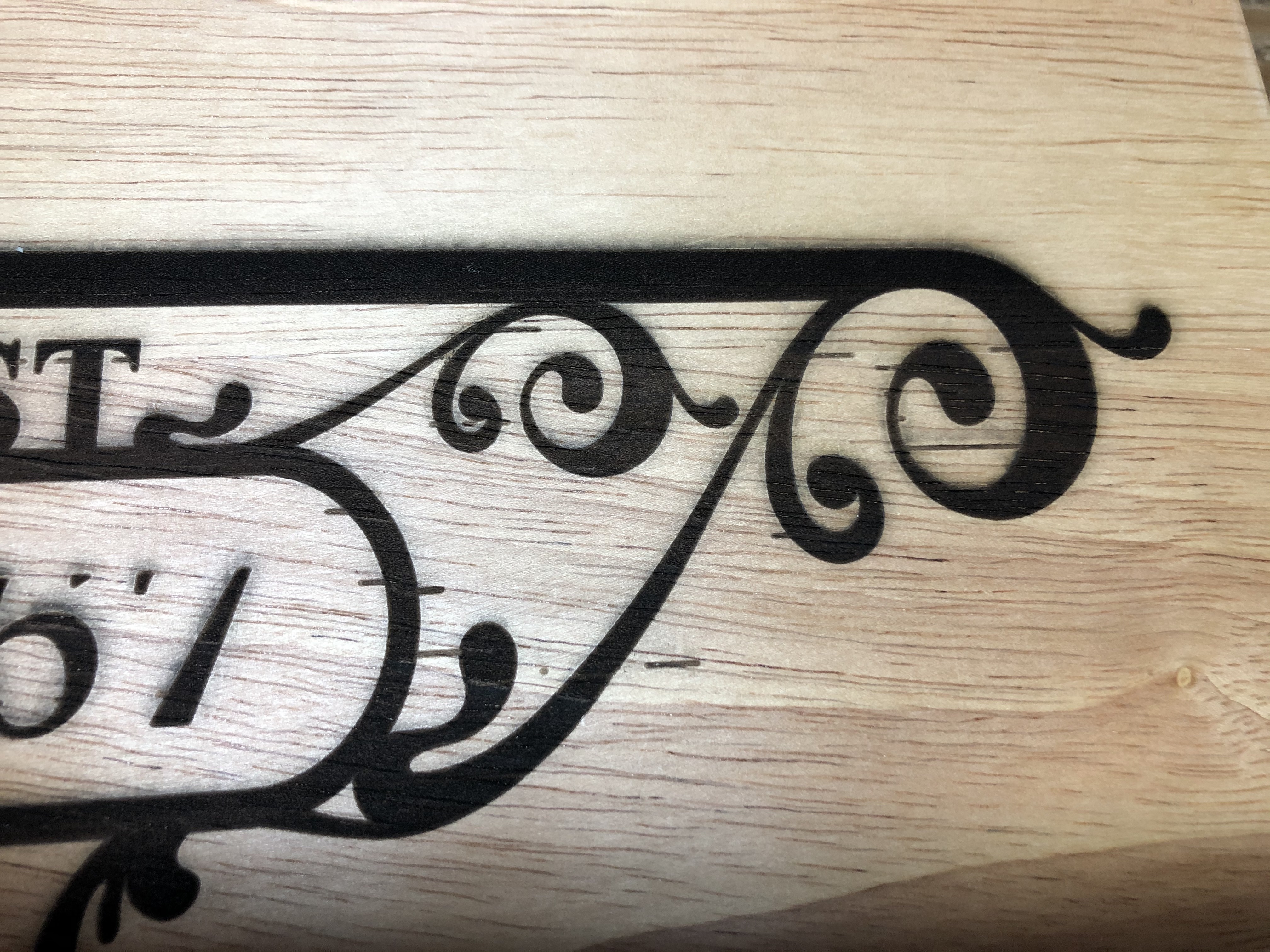

Can I get some help on why these random dashes are appearing in my design? I have already done several of these and suddenly these started appearing.
Thanks in advance.

Those are very wide, and don’t look like a focused beam did that. Did you see them being burned?
I did not, I reset my machine and burned a successful project after that. I started another project and it did the same thing? I’m at a loss of what this could be.
Do you see them on the preview? This could feasibly be noise in the wiring, a loose connection from the L-ON wire, or the input to the HV-PSU. I would check those first.
