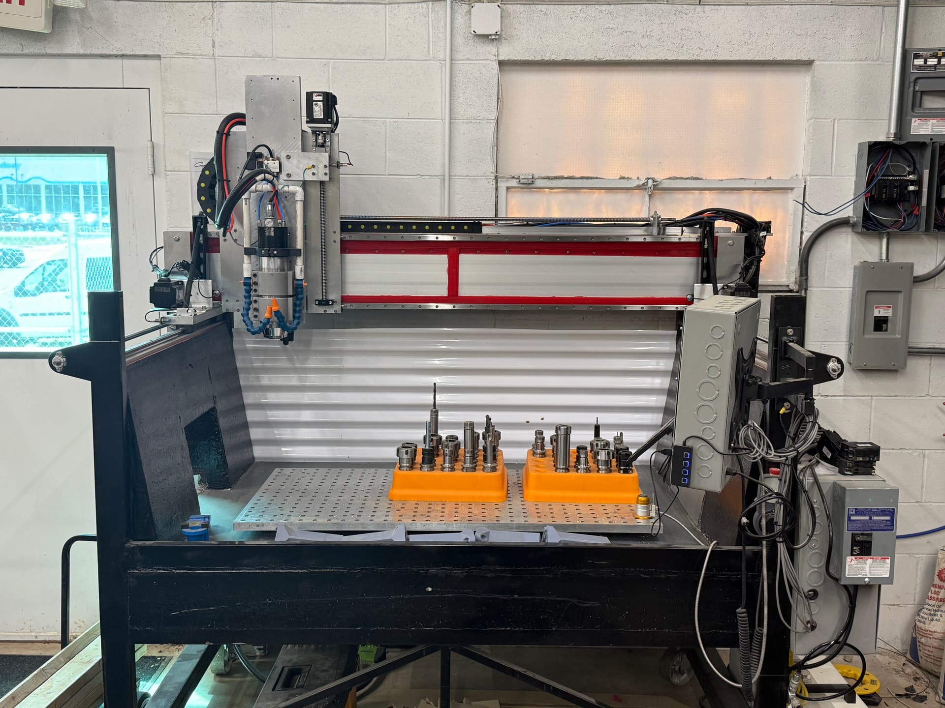

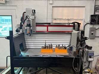

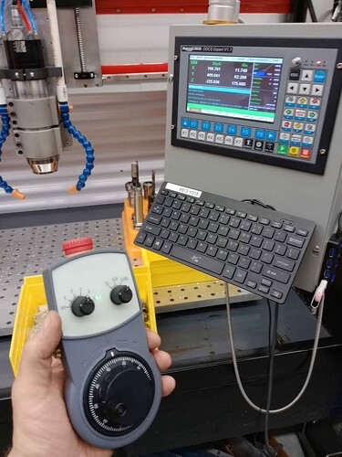

Currently I have a DDCS Expert v1.1 on a machine I picked up in December 2024 and looking to get a V3 or V4 for another machine after falling in love with the interface. From what I am finding these controllers are stock EMC2/LinuxCNC flavor of GCODE and even take the “.ngc” file format as does LinuxCNC. In MillMage you will simply need to set up a LinuxCNC flavor of controller to be able to export the proper GCODE format to control machines with these controllers.
