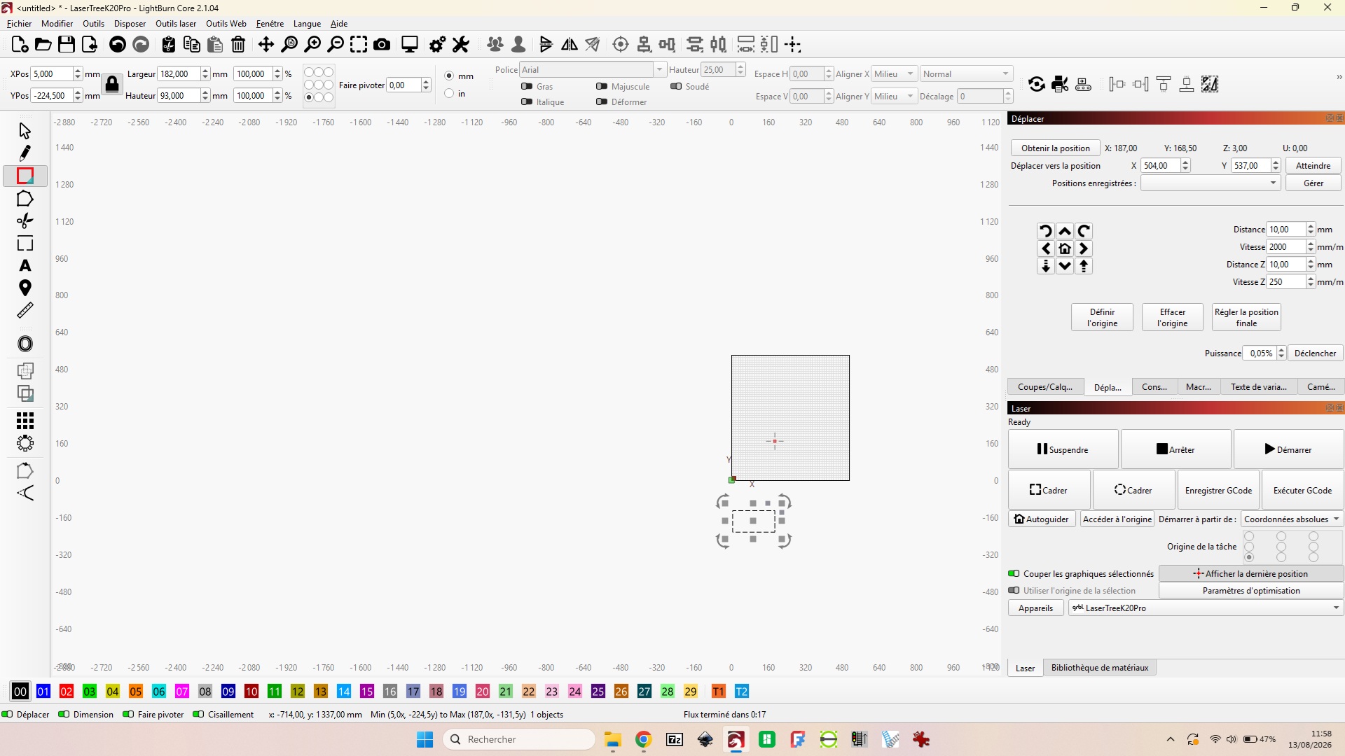

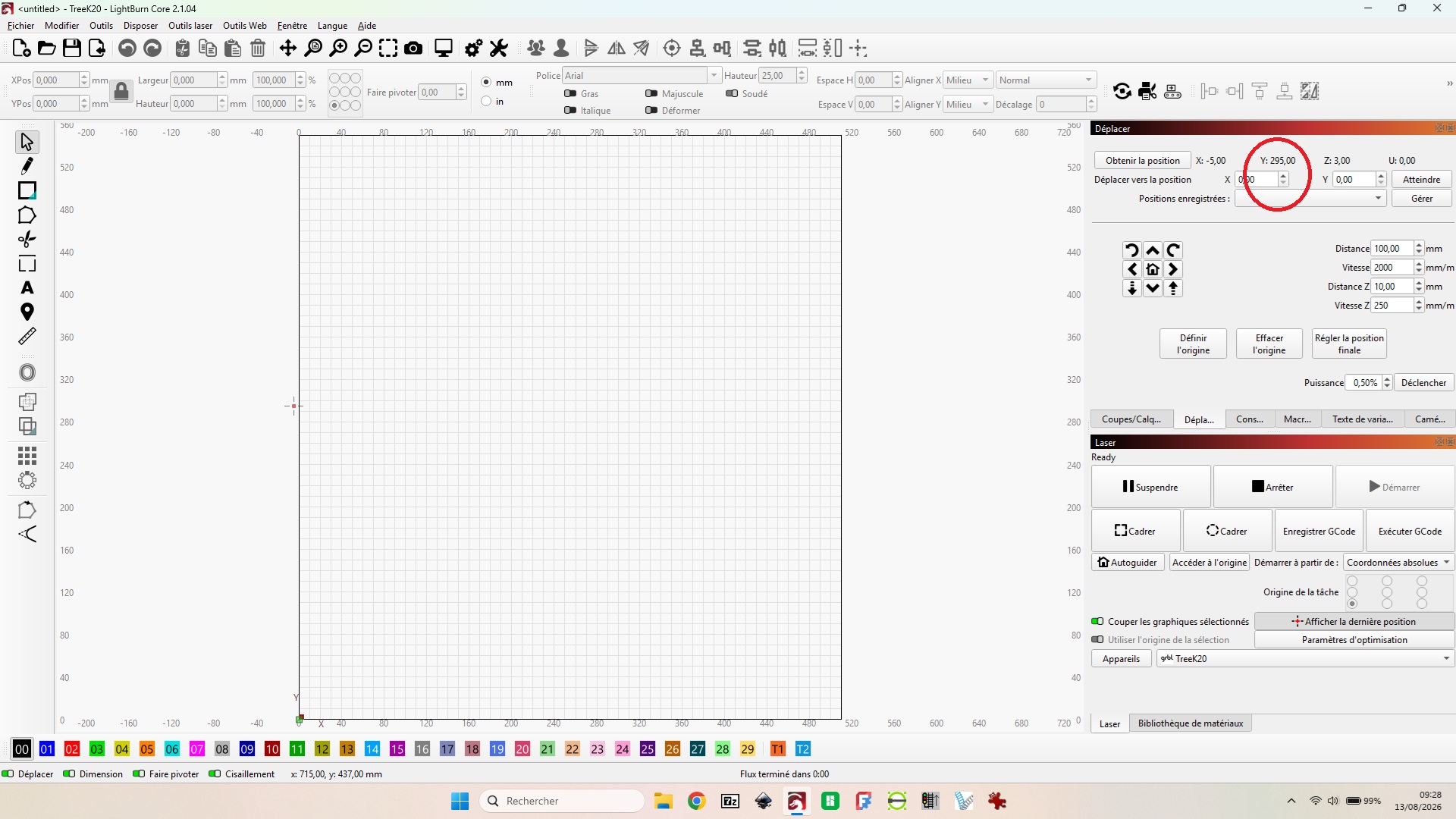

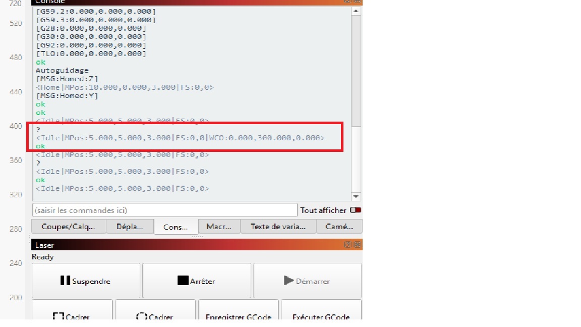

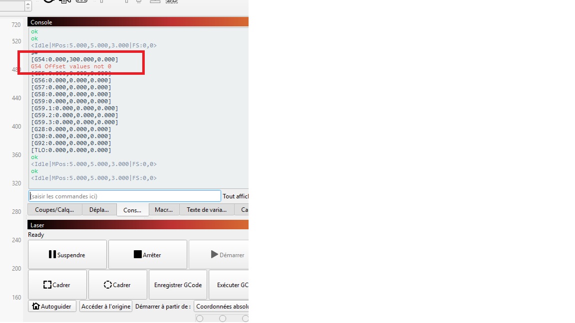

Hello, after homing, the Y-axis shows a position of 297 mm—even though the homing process completed successfully—and when I frame a rectangle, the laser head moves 300 mm along the Y-axis. I never entered the value “297” anywhere. How can I resolve this issue? Thanks in advance for your help.
In Console window, input $RST=# to clear the offset.
