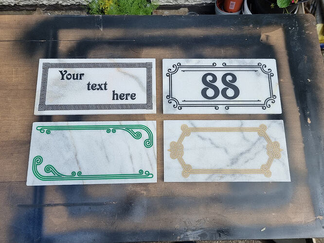

Anybody here tried deep engraving natural marble ? By deep i mean 1-3mm deep, not just surface mark.

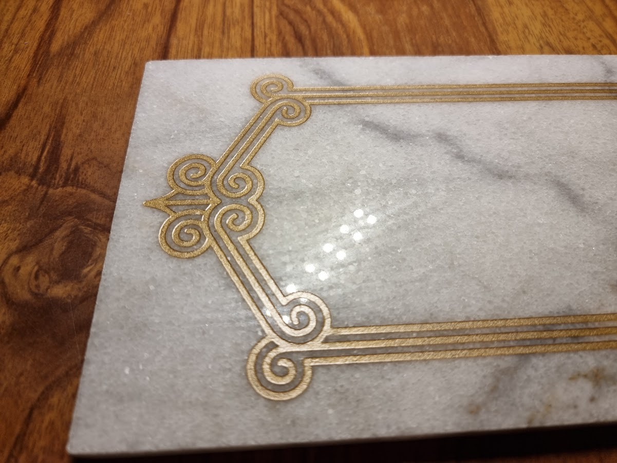

I have 100W co2 here, done some marble before, usually in one pass for 0.25-0.5mm, never tried going deeper. Anybody tried ? What are the results ? Does marble burn (as the case with slate, it turns brown with too much power)?

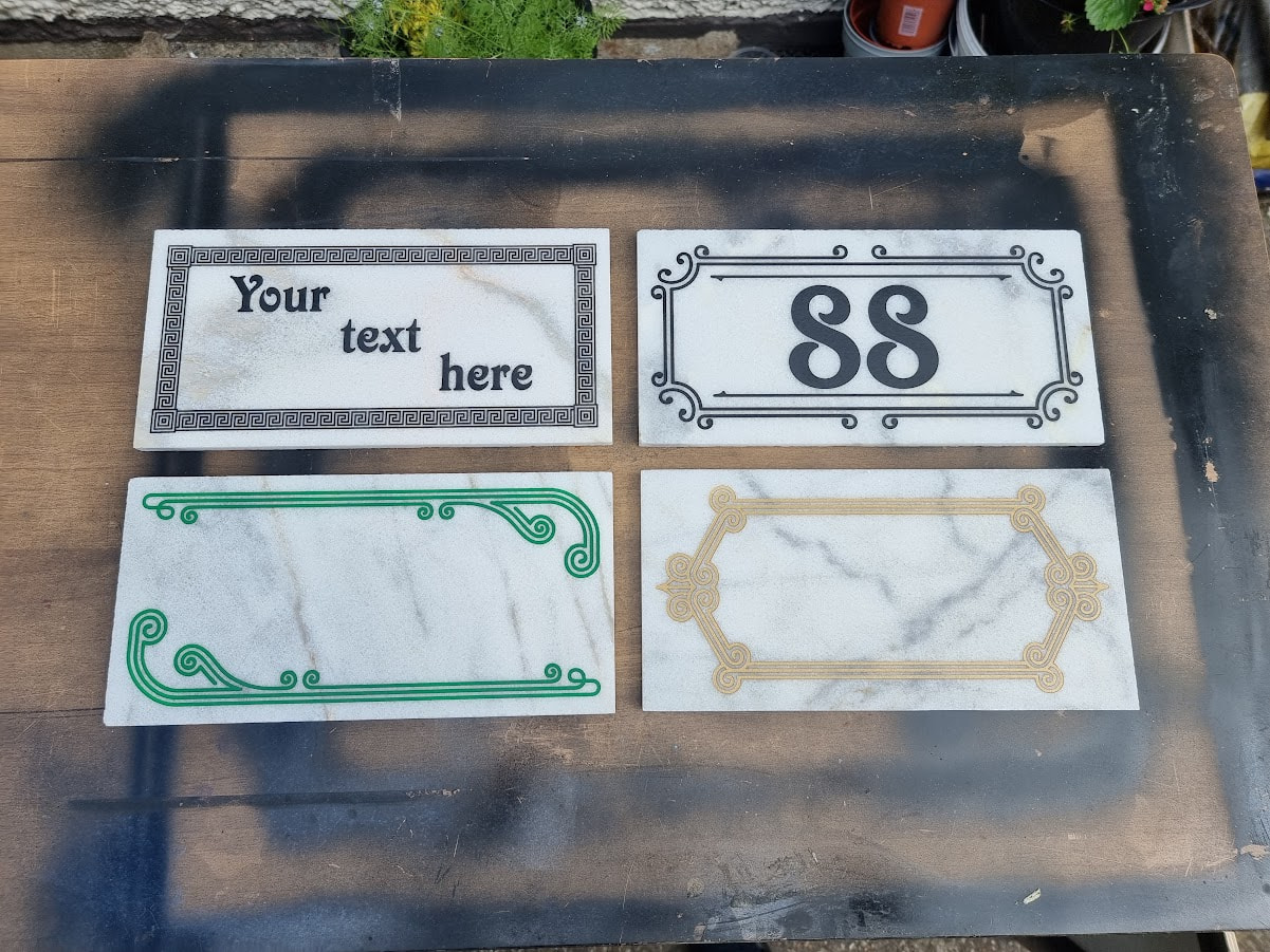

Above, engraved and gold paint filled plaque.

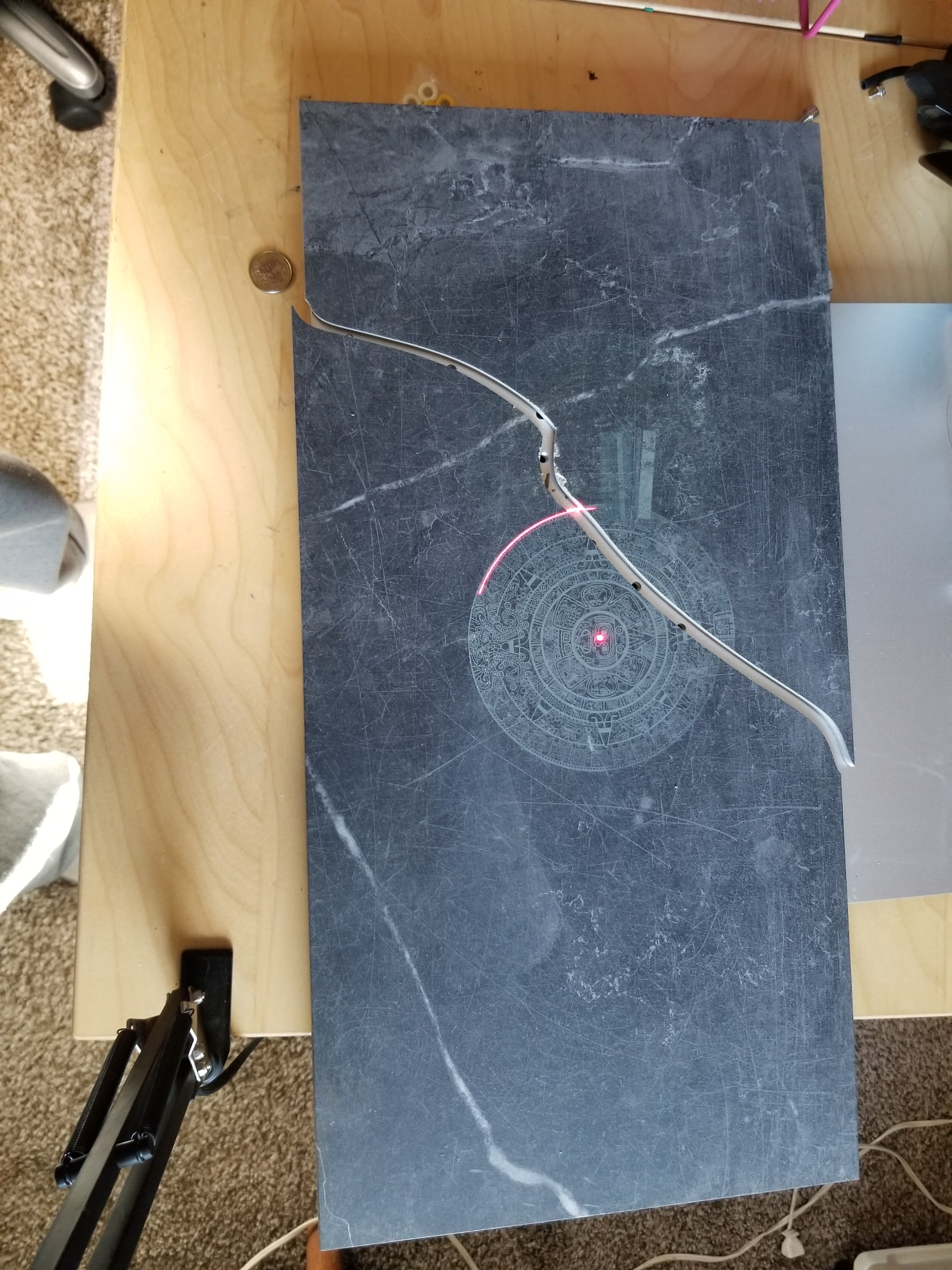

You have to be careful with some of the stones. I did one, on the fiber, with a very light engraving using a 1’x2’ floor tile made of slate.
After it finished, I shut everything down and went to dinner. Partially through dinner we hear a loud pop, it was the slate shattering from the heat..

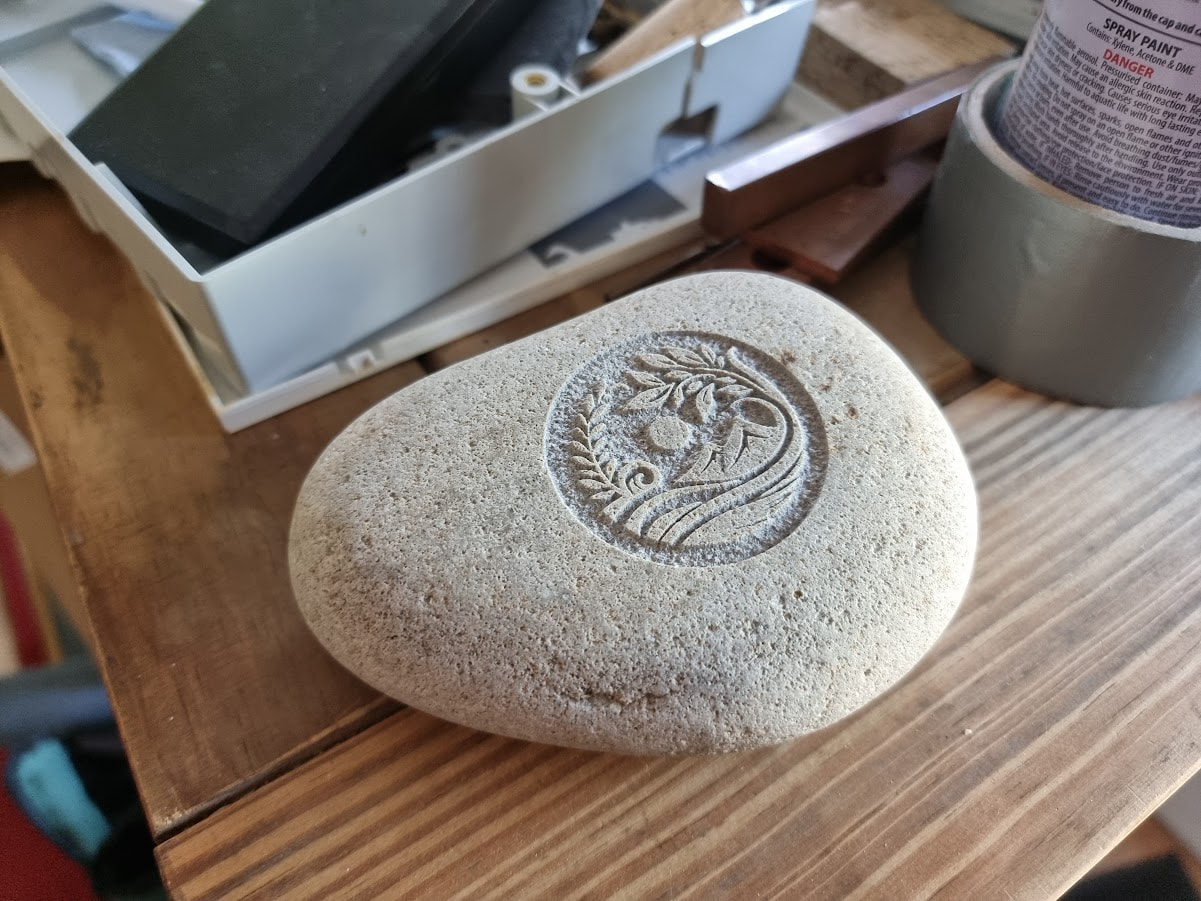

I’ve done this, on a rock, using powder coating. Brush it on after you make the grove and brush the powder coating into the engraved area and lase again, rinse/repeat.

The marbles i’d done so far were about 0.1-0.3mm deep for paint fill, so it worked fine. The old runs were done on 80w tube but about 30% power/200ish mmps speed (if memory serves). Now i run 100W tube.
I have a potential order of a lot of BIG stones to do. Single piece would take whole bed of 900x600) but they want a deep engrave of 3mm. Slabs are thin too (~12mm thick), which makes me worry about localised thermal expansion/shock situation.

I would try a higher speed and multiple passes. Take out a little at a time. If you try to do it in one pass, you will likely get a Jack Rock result. :face_with_symbols_on_mouth: I can imagine the panic when that thing popped.
