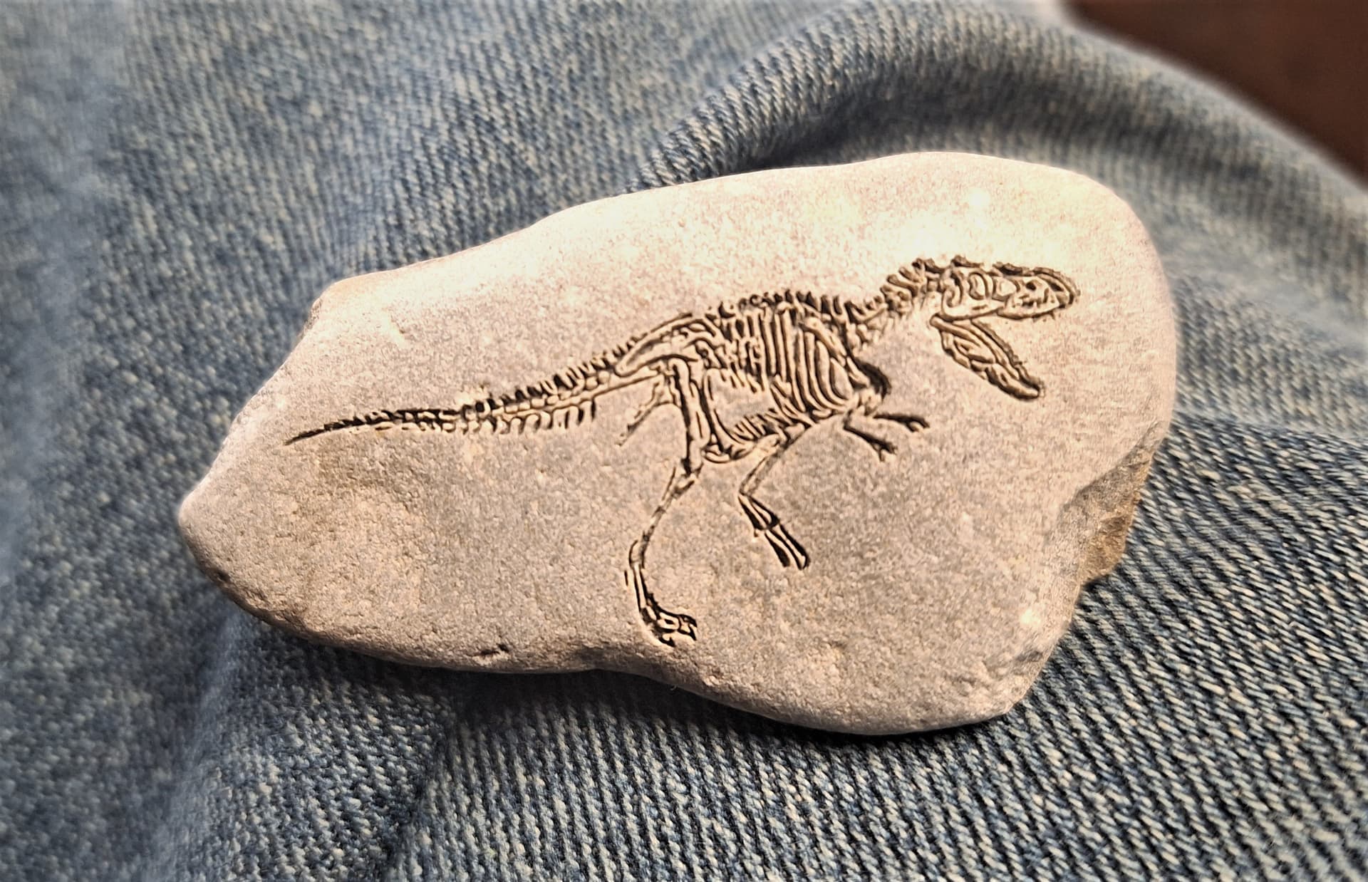

Deep engraving Rocks With 60 Watt Fiber
OMG JPT 60 watt M7 MOPA
2000/70/105/100 0.025 interval…10 passes

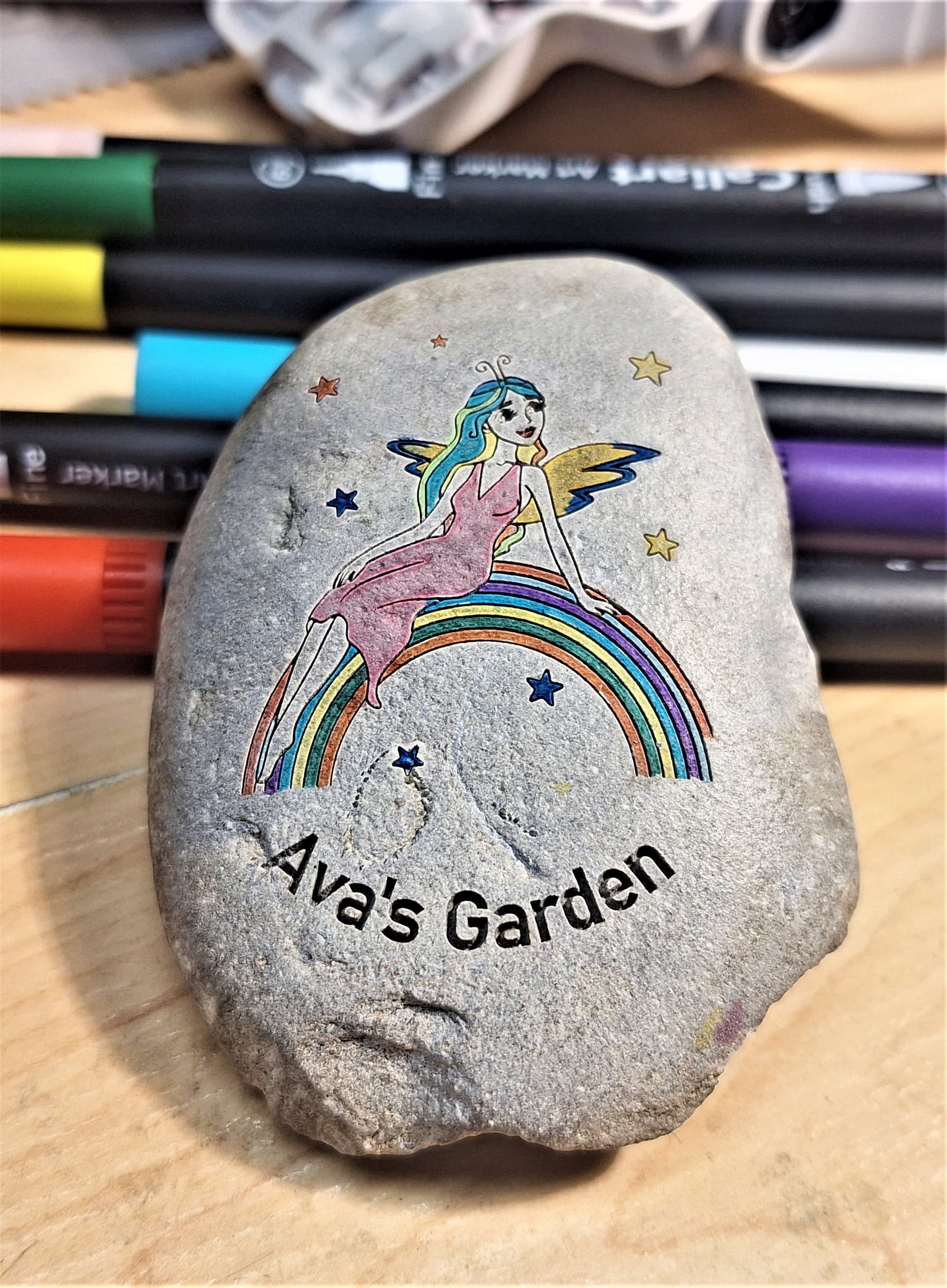

Some are for Grand Daughter’s Fairy Garden

Assume, 105kHz and 100 q-pulse… which lens?
I did a few with petroglyph type art, spread them around and didn’t say anything. I used a 175 lens similar settings, think I’ll go down to the 100 if I was to do any more.
150 mm
