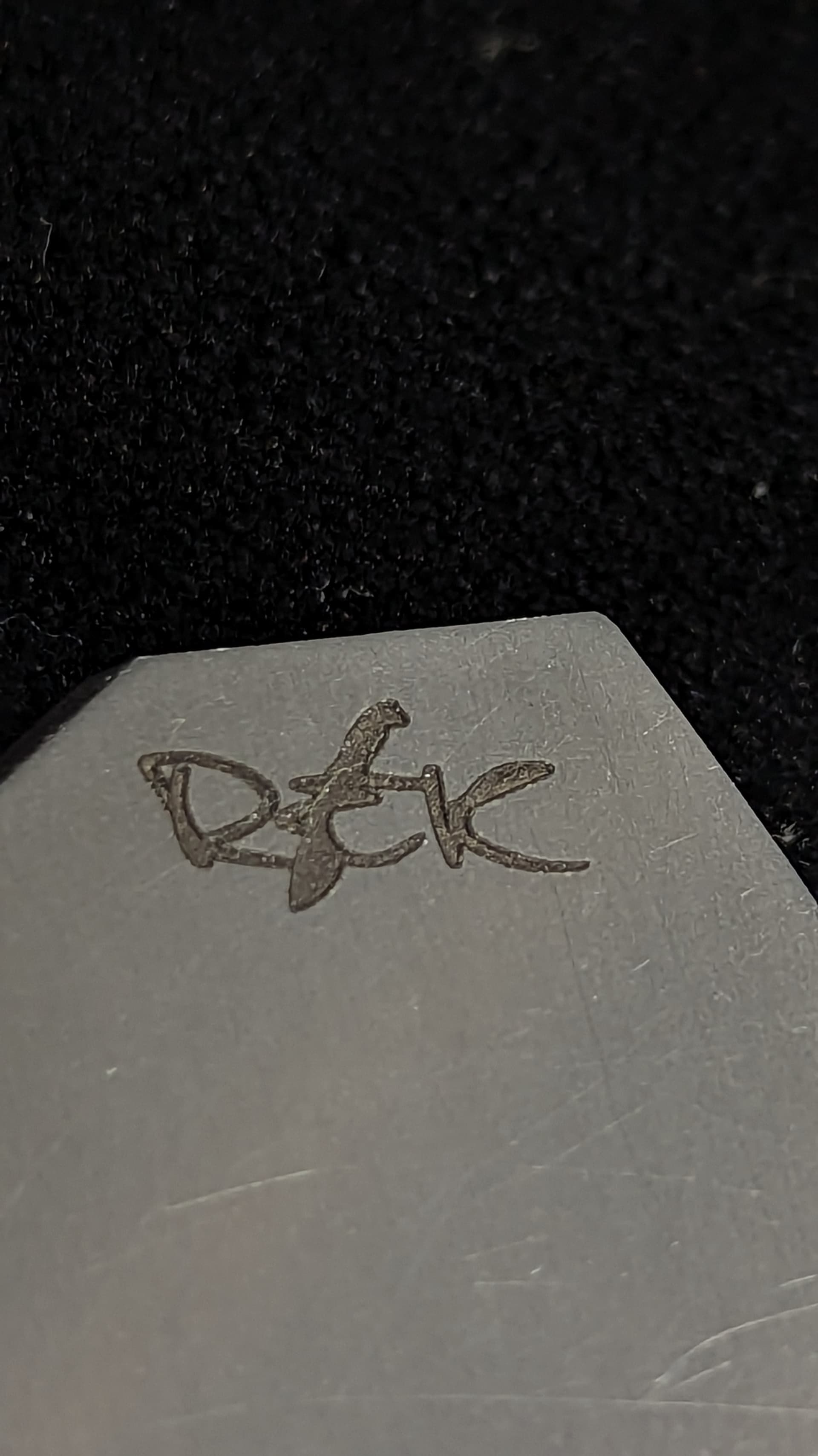

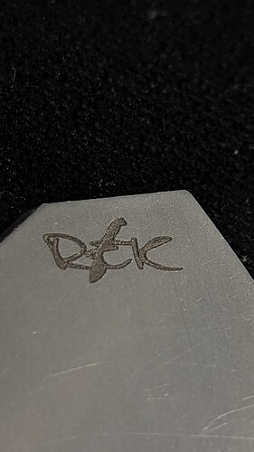

Don’t know how helpful, but these are the settings I have for an F254mm lens… M60 MOPA…
This knife is annealed, it’s very smooth.
using these settings…
Good luck…
Thanks for sharing!!
I’m wanting some depth though… I have figured out how to do an out of focus anneal with some depth (shiny though) but now I’m going for more of a matte finish with depth and crisp on the edges. I keep running into a burr though.
I tried doing the settings above and it seemed to actually work! Have to play around with it more though.

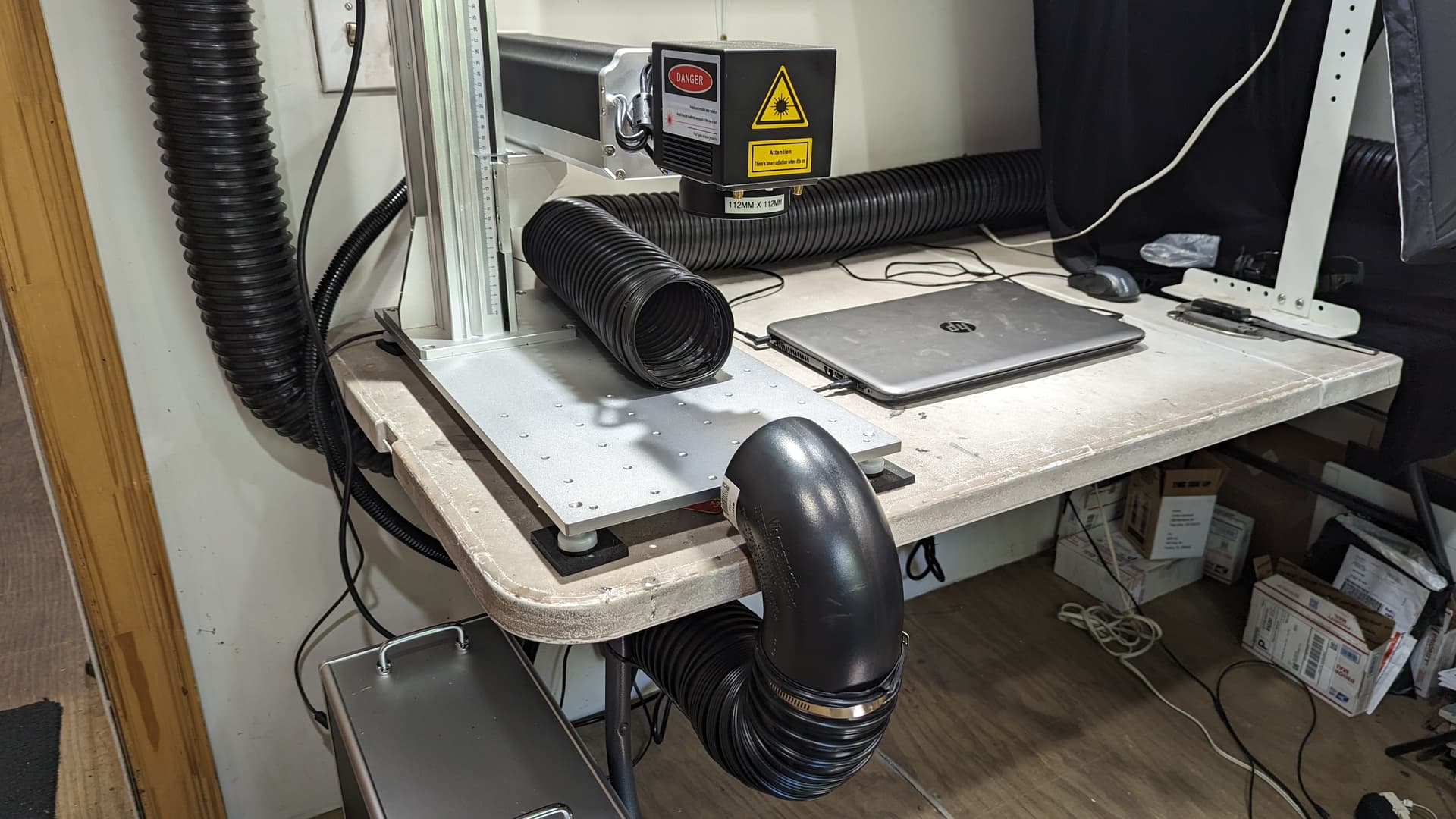

In situations where you are deep engraving the debris will stack up in the crevices and effect how well the laser performs… Just enough air to keep the debris from collecting…
I don’t do that many deep engravings to make it worth the effort… I can see the streak of brass going towards the ventilation that was debris from the coin.
I’ve got good ventilation, I just wasn’t sure about the nitrogen thing… In some videos I watched they made reference to a clean up pass (to remove the junk from the deep engraving pass). I’m still trying to figure it all out though lol

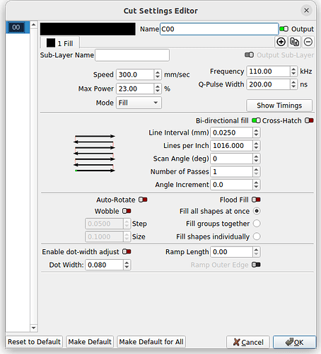

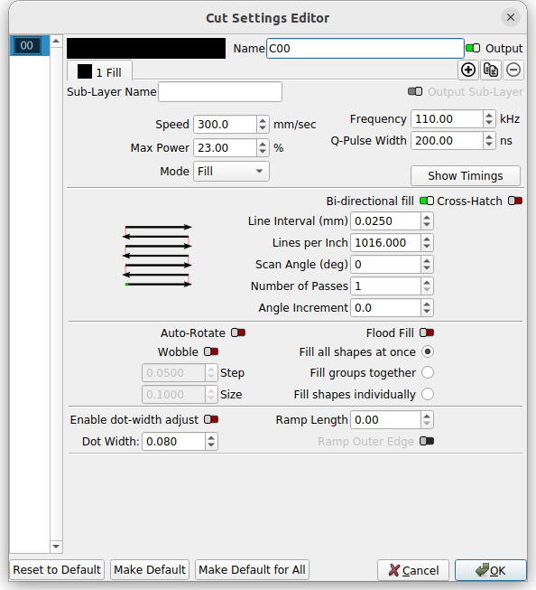

I’ve found from my limited experience trying to come up with cleaning passes, that an increase in frequency and lower power level seems to clean up a lot of metals…
If you do a 60% power at 40kHz, then start values to figure out a good cleaning pass might be 20% power at 80 or 100kHz.

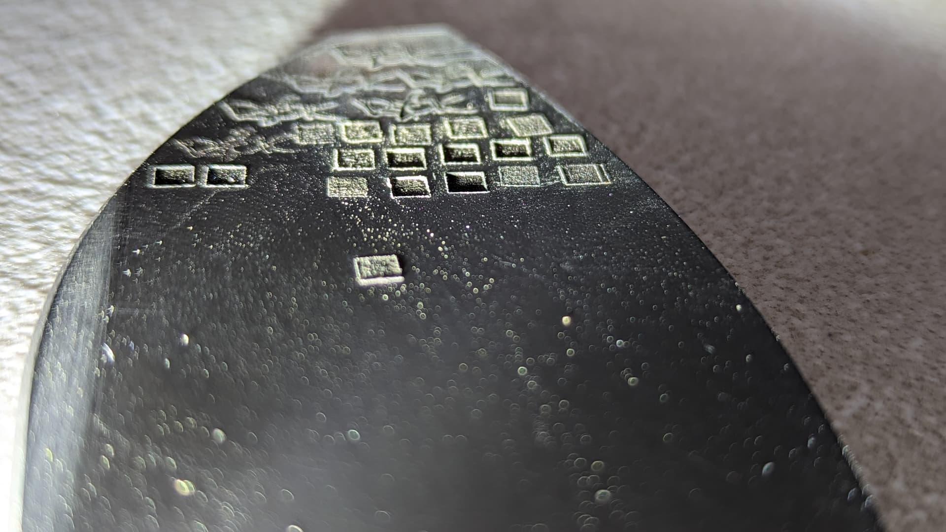

Here’s the burr I’m talking about
Looks like the debris is building up… maybe too much heat too quickly?
Make more passes at lower power or higher frequency… That should reduce that effect…
