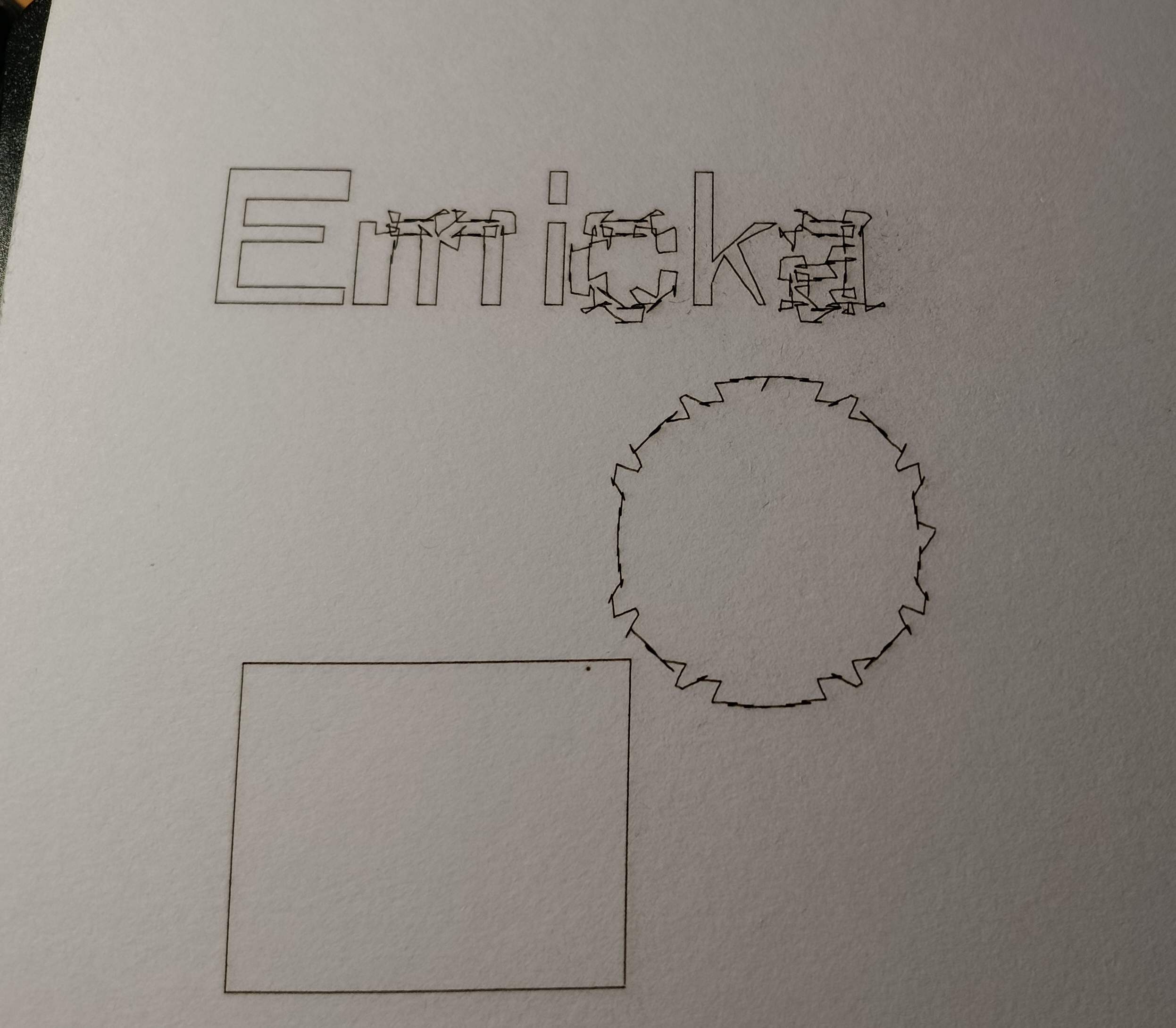

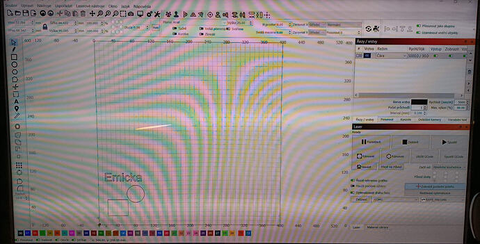

I create some shapes and writing. Export this as gcode, copy file on SD card for machine but result os deformed - bad. What do I wrong ? Some tips ? Thank you.
Do you have a real, legal and licensed copy of Lightburn?
***DO NOT POST YOUR LISCENSE NUMBER***
I have trial license.Now I tryed change profile of engraving machine, but with this is laser so weak (although is set 90% . . .) the machine dont fire . . . it seems complicated . . . .
As James writes, this is not an authorized version of LightBurn
That’s typically the symptom of a “cracked” LightBurn file downloaded from somewhere other than the Official Site:
You should run a good malware scan, because similar programs generally install a bunch of other stuff you really don’t want on your PC.
A previous discussion explains some of the issues:
Thanks for info. I uninstalled LB and make new download from link above - and voila - first test seems like everything is OK. Thanks for advice and tip. J.
