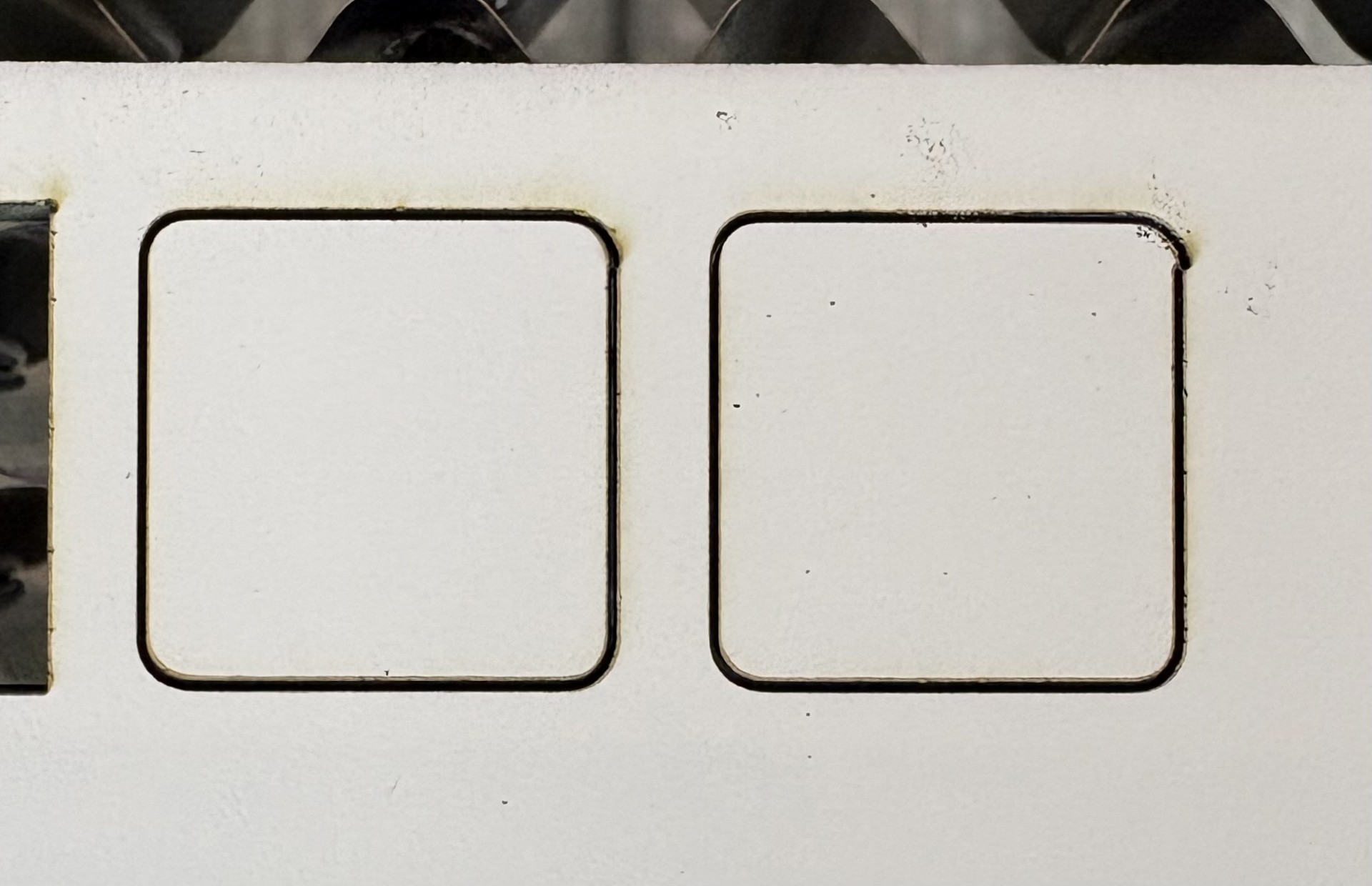

Hello,
I have a new OLM2 S2 and I am having trouble with shapes being slightly deformed acting like they are not closed shapes. It looks like backlash but there is absolutely no way it is backlash. All the mechanicals are tight; there is no slop anywhere. Here are just two of my test squares. I used the rounded corner because it’s easier to see the deformation, square corner do the same thing.
Both squares start in the upper right corner below the curve and cut counterclockwise, all settings the same. The only difference between the two is where the laser had to move from to start the cut. Left square, the laser had to move from the left rightward to start the cut and it cut fine. The right square the laser had to move from the right of the square leftward to start the cut and the shape is deformed. Basically, if the laser has to move any amount in the same direction as the initial cut the shape is deformed. If the laser approaches from any other direction it cuts perfect. The issue is repeatable, and if you rotate the square 90 degrees so does the issue.
Seeing that issue is repeatable in both the X and Y axis (depending shape starting point) I believe that rules out backlash. All belts are taunt, gears tight, and no slop in the rollers. It’s not an acceleration issue because I enable “pause at start” of cut for 500ms and that didn’t change the results. Nor did slowing the acceleration speeds down to 1000mm/s^2.
Tried swapping out the motherboard with another brand-new one and got the same results. Both boards are running firmware version 190. Swapped computers, both running the latest version of Lightburn, same results. Tried updating the firmware to version 191, but like everyone else I can’t get either motherboard to accept the new firmware. Went so far as to create a windows 10 VM to apply the firmware with no success.
I am running out of ideas. Anyone else have this issue? or an idea on how to fix it? Could this be caused by the firmware or could it be something in Lightburn I’m missing? Thanks

You did not mention which mechanicals you checked, but the set screws on the couplings and motor pulleys are often overlooked.

Everything, if it can be tighten or has a set screw it was checked.

Engrave a square, as large as your machine bed allows and measure the exact length of the sides (X,Y), there should be no difference.

Scale it uniformly to fill the platform and run it as fast as the machine will go in Line layer mode with Enable optimizations turned off and power set to mark a sheet of cardboard. Any differences from the design will be informative; a crisp photo will let us look over your shoulder.

Thank you for the response. The grub screws are tightened correctly. My original statement was correct, everything was tight, too tight. Every was adjusted correctly but loosening the eccentric rollers solved the problem. Apparently, they need to barely touch the rails, seems too loose IMO, but that solved my problem.

By the way, the eccentric wheels also tend to collect dirt over time from the aluminum profile, which can also cause irritation.
