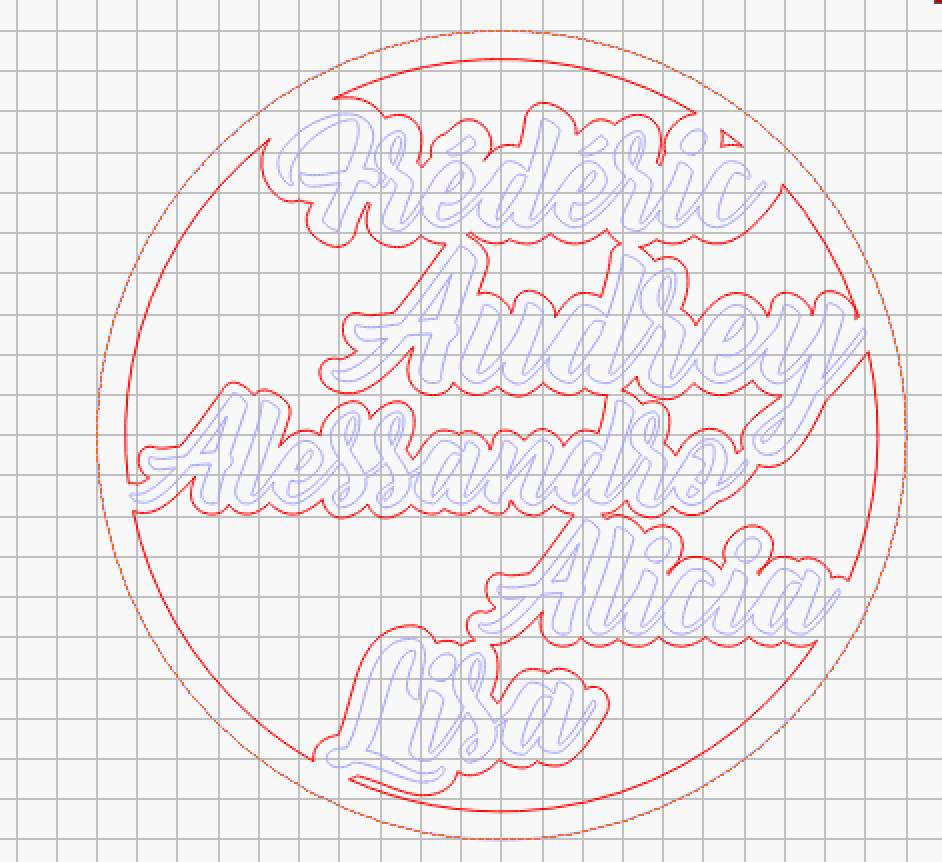

I would like to make a circle, and inside cut out first names, but I can’t do it. I can make the first names, put a border around the first names, but I can’t attach the first names to the circle. Could someone give me the procedure to follow. Thanks in advance

Thank you for your reply, here is what I would like to do

Select the red offset around the letters, then shift and select the inner circle. Bring up Boolean Assistant (Ctrl+B) and choose intersection. That should provide the results you’re looking for.
Thank you very much for this info, it works very well now. I did not know the shortcut CTRL-B. Thanks again
