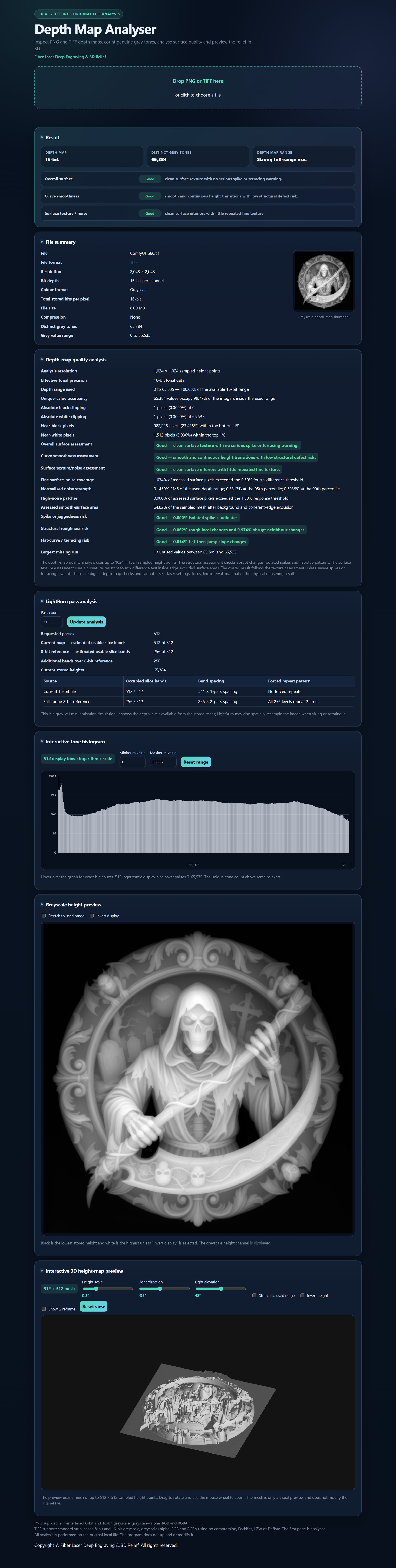

The tool
DepthView counts what’s actually in the pixels. Free, MIT, no signup, single file, Windows/Mac/Linux — nothing to install.
GitHub - LeeGillie/DepthView: Depth map inspector: reports what a depth map actually contains, not what its header claims. Bit-exact decoding, imposter detection, and a software-rendered 3D relief preview. · GitHub
Typical output screening a folder:
step is the GCD of the gaps between occurring levels. Genuine data gives 1. A step of 257 or 256 is byte-widening; 64 is a 10-bit ladder. Exit code 1 when anything is flagged, so it drops into a batch script.
It also reports unused headroom (a map spanning 267–63,271 wastes passes at both ends), pure-black and pure-white pixel counts where depth has already been clipped away, and it renders a lit 3D preview with a terracing control you can set to your pass count.

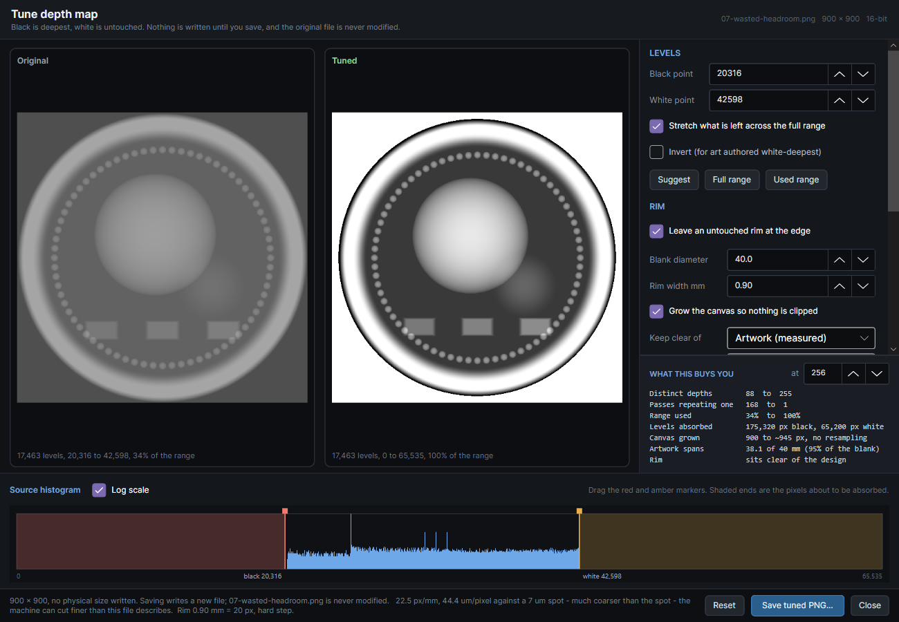

DepthView 1.2.0 — it now fixes what it finds
The version I posted about earlier could tell you a depth map was wrong and then leave you there. That always felt like half a tool. 1.2.0 is the other half.
Download: Release DepthView 1.2.0 · LeeGillie/DepthView · GitHub
Windows, macOS and Linux, x64 and ARM. One file, nothing to install, no runtime to add first — the .NET runtime is inside the executable. Free, MIT licensed, and the binaries aren’t code-signed, so the release page explains what your OS will say about that.

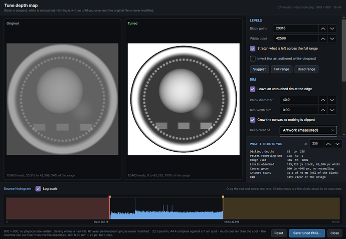

What the tuning window does
Load a map, press Tune…, and you get the original and the corrected version side by side with the source histogram underneath. Drag the two markers on the histogram:
  • Everything at or below the black point becomes one uniform full depth. That’s how a noisy floor stops engraving mottled and starts coming out as a clean polished plane.
  • Everything at or above the white point is left untouched — zero passes, bare metal.
  • What’s left is stretched to fill the range, and the shaded ends of the plot show you exactly which pixels you’re giving up to get that.
Every number updates as you drag. The panel answers the only question that matters: at the pass count you intend to run, how many distinct depths do you actually get, before and after.
On one of the bundled samples, that’s this:
  levels          black 20,316, white 42,598, stretched
  flattened       175,320 px to pure black, 65,200 px to pure white
  depths @ 256    88 -> 255   (wasted passes 168 -> 1)
  range use       34.0% -> 100.0%
88 distinct depths to 255, at the same 256 passes. 168 passes that were re-cutting a depth already cut, reduced to one. That map wasn’t broken — it just only used 34% of its range, and nothing tells you that by looking at it.

Finn — you’re right on both counts, and the second one is the more serious of the two. I went and worked it through properly rather than argue.
On repeated masks: yes. I checked what those 256 passes actually do on that sample, and “wasted” is a bad word for it because it turns out to describe two completely different things that I’d lumped together.
passes   1..89    every artwork pixel is in the mask. The laser fires, material
                  comes off - it just comes off everywhere equally. That's a uniform
                  recess 89 passes deep. Depth, but no form.
passes  90..176   masks shrink. This is where the relief is actually made.
                  87 passes carrying the entire image.
passes 177..256   nothing in the map is dark enough to be in the mask at all.
So of the 168 I was calling wasted, roughly 89 are cutting real material that produces no relief, and roughly 80 have nothing in the mask. Whether LightBurn skips an empty pass or runs it, I don’t actually know. Either way, calling the whole 168 “wasted” implies an idle laser, and that’s not what’s happening. A repeated mask adds depth. It doesn’t add a distinguishable level. Those are different claims and I was making the wrong one.
Your second point is the one that actually undercuts my headline, and I want to be plain about it rather than bury it.
I’ve been describing stretching a map from 34% to 100% as recovering wasted resolution. It isn’t. Work it through: that map’s relief occupies 87 passes of depth and resolves into 88 distinct levels. That’s 1.01 levels per pass of relief depth — the theoretical maximum. You cannot fit more levels into a relief than you have passes of depth to put them in. Nothing is being wasted.
What stretching actually does is make the relief roughly three times deeper, and it gets more levels because it is deeper. Levels per unit of depth are identical before and after. If that 34% range was deliberate — somebody wanting a subtle shallow relief — then my tool isn’t fixing their file, it’s overriding their intent by a factor of three and calling it a correction. And nothing in the file says which it is.
On your third point I’d push back a little, but only a little. The numbers have stayed on the right side of that line: nothing in DepthView claims to know depth in millimetres, --depth-mm explicitly changes no pixels and only reports the geometry the settings imply, and the whole reason there’s a calibration coupon is that the file cannot tell you how your material ablates. The rim ramp defaults to none precisely because I don’t know what wall angle a galvo holds at depth and wasn’t willing to invent one.
But the language absolutely did cross that line. “Wasted passes” and “fixing” are physical claims dressed up as file analysis, and you caught them. The measurements were careful and the words around them weren’t.
So, what I’ve changed. All of it is in 1.2.1, which is up now — no new features, it exists purely because 1.2.0 said two things that weren’t true:
1. The word “wasted” is gone. Not softened — removed. There is no column called that any more, anywhere in the report, the window or the docs.
2. The stretch is reframed as what it is. It’s no longer described as a repair. It’s a decision about how much of your available depth the relief uses, and the tool now says so outright: more depths because it is deeper, levels per unit of depth unchanged, worth doing if the narrow range was an accident and worth leaving alone if it wasn’t. The warning that used to fire merely because stretching would add depths doesn’t fire any more — that was the tool calling a design decision a defect.
3. Reporting the split instead of the single number. The table now shows, for each pass count, how many passes form the relief, how many have every engraved pixel in the mask, and how many have nothing in it. On that sample at 256 passes: 87 relief, 90 uniform, 79 empty. They sum to the pass count.
I nearly wrote here that you’d therefore get an identical result from 176 passes, and I’m glad I checked before posting it, because you wouldn’t — the pass count is what sets the threshold spacing, so running fewer passes redistributes all of them and gives a shallower relief. The 79 empty passes can’t simply be dropped. What’s true is narrower: 79 of your 256 have nothing in the mask, and whether LightBurn skips them or runs them empty I don’t know.
4. README, release notes and the sample docs swept for anywhere else file properties were written as if they described material behaviour. The report itself now spells out that a large uniform count is not automatically a fault — it means the design sits in a pocket, which is sometimes exactly what was wanted, and the useful question is whether you asked for it.
Here’s the new table on that sample, for reference:
  passes   depths   uniform   relief   empty   stretched   band spread
      64       22        22       22      20          64   348..349 x1.00
     128       45        45       43      40         128   174..175 x1.01
     256       88        90       87      79         255   87..88 x1.01
    1024      347       358      349     317       1,014   21..22 x1.05
None of this touches the imposter detection or the band spread work, which are both genuinely about the file and stay as they are.
Third time this thread has corrected me and third time the tool comes out better for it. Much appreciated — blunt and specific is far more use to me than polite and vague.
This is more the kind of depth-map analyser I find useful myself. Unique Download Link | WeTransfer
It still checks the basics bit depth, actual grey levels, tonal range and whether 8-bit data has simply been stored in a 16-bit file. but it also analyses the height map itself.
It looks at curve smoothness, surface texture/noise, isolated spikes, abrupt height changes and terracing, and gives you an interactive 3D preview so you can actually inspect the relief geometry. It also reports clipping, tonal-range use and LightBurn slice-band behaviour without assuming that a narrow range is automatically a defect.
