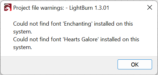

Note that I got this message when loading the file.
So it appears that font text is still somehow perceived to exist in the file.
If that’s the case, then it’s possible that what I’m getting is the fallback path that LightBurn includes for fonts.
You may want to make sure that absolutely everything is converted to path.

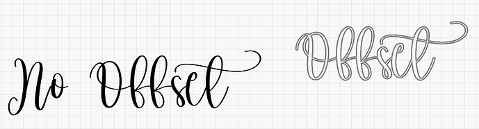

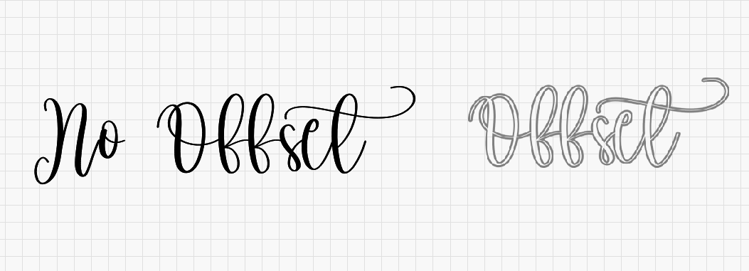

So it appears to be something to do with the offset. If i take the same script/font and recreate the design, except I do not add the offset, then the design is the same across all environments. If I add the offset, then the misalignment appears in the environment the design was not created in.
On Mac
On Win10
The result is the same whether i group the objects or lock the shapes.
The interesting thing is that if I convert it to a bitmap, the script/font that had the offset still “jumps” when opened in a different OS than it was created.
Mac->Win the offset is a lower Y value and Win->Mac, the offset is a higher Y value.
