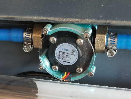

You will be able to do things in Inkscape that cannot be easily done with Lightburn. Just like Gimp handles some things that Lightburn doesn’t. Some of my designs need to ‘match’ something else I’ve created. For example, I needed a box to hold a sensor. Designed the box in Freecad for 3d printing and exported the ‘top’ out as a DXF that I cut on the laser using Lightburn.
