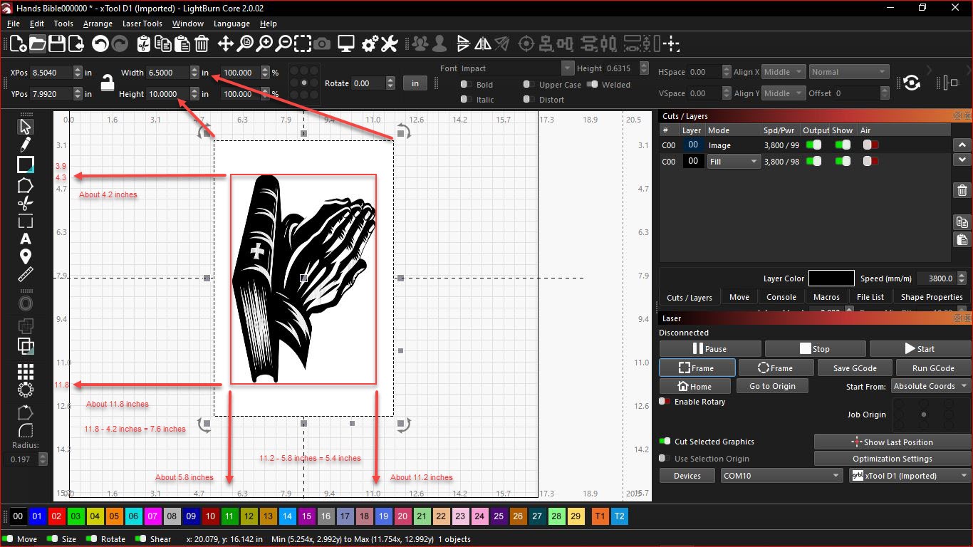

The ‘White Canvas’ that the art is on is 10 inches tall and 6.5 inches wide (on the screen and in the computer). The scale on the left side places the top and bottom edges of the canvas at about 3.1 and 13.1 so there’s the 10 inches.
If I put a red box around the bible and praying hands and draw arrows back out to the scale I get (Roughly) 7.6 inches tall and 5.4 inches wide (In the grid).
These are rough numbers but they’re really close to what you measured.
7 9/16 is 7.563 and fairly close to 7.6 (0.037")
5 3/16 is 5.188 and not as close to 5.4 (0.212")

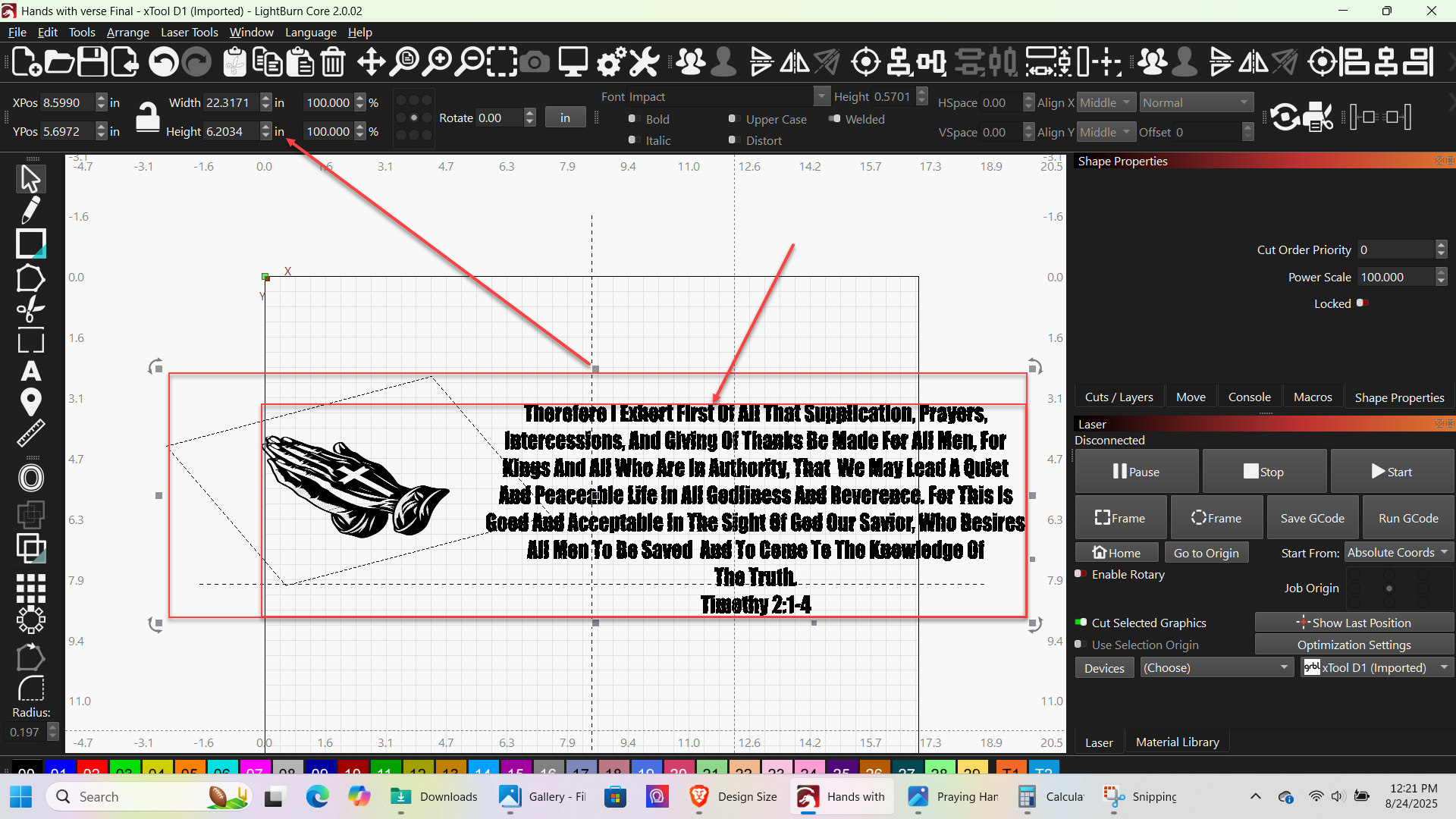

The .gc file won’t show the white canvas part. It only shows where the machine moves and what it engraves or doesn’t engrave.

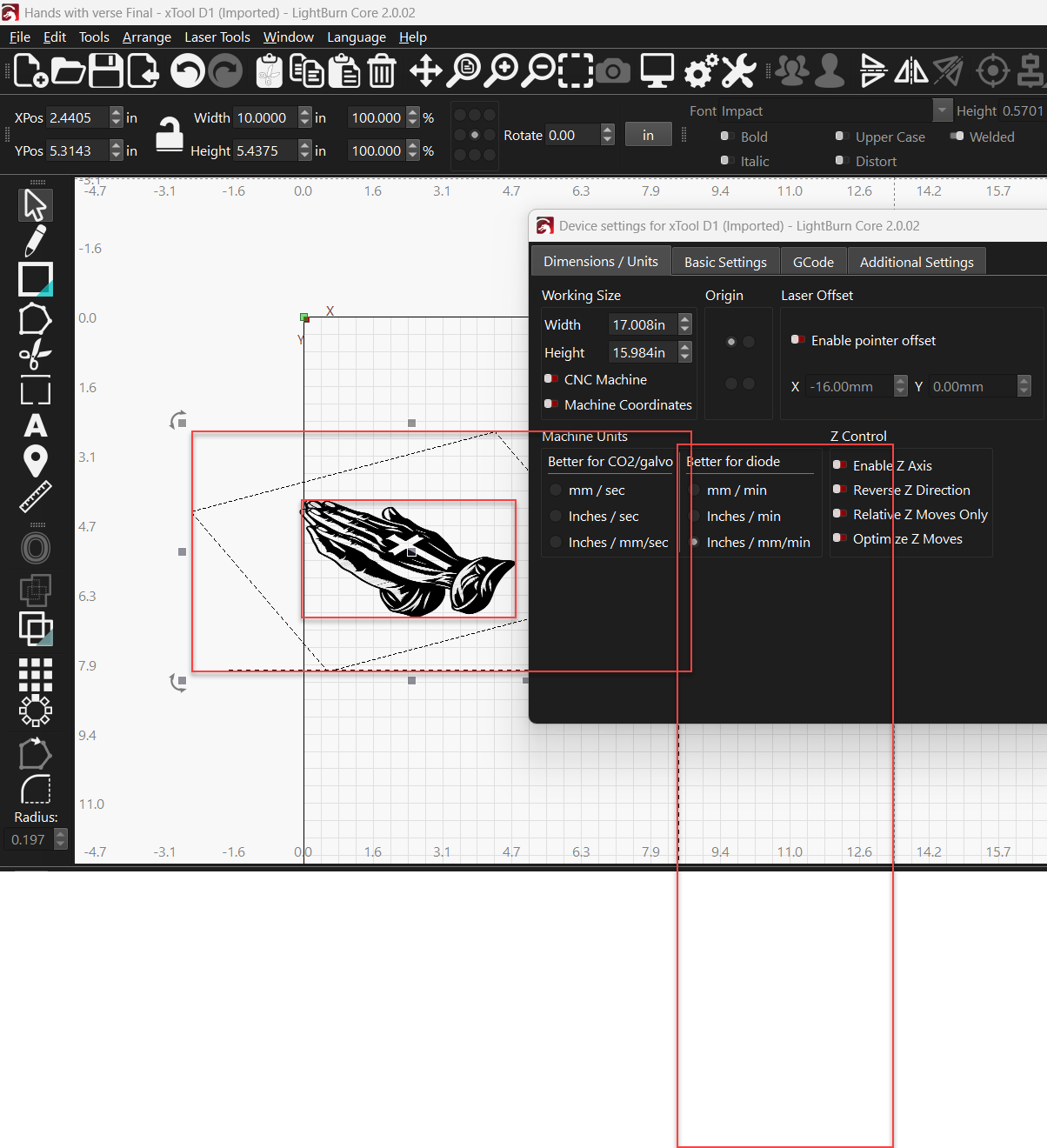

The Larger red outline is what you’re seeing measured in LightBurn.
What I feel you may have measured is the smaller red outline - The finished work.
This one is huge and partially hidden. It’s the only way I could make any sense of it.

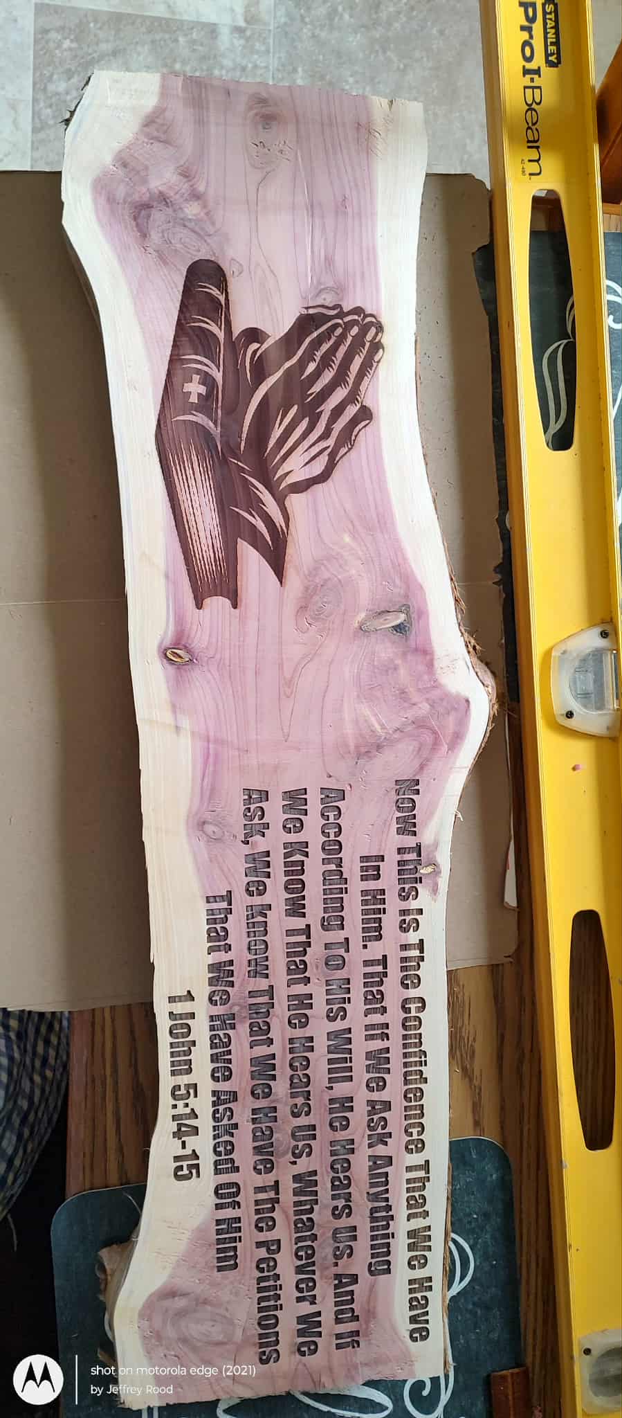

I understand about the measurements, I think? Obviously I need to get the projects laid out so that I know where the artwork will land so that I can place right on spot to turn out right. I believe I found a way around it, I will have to go back and think about it. It has been crazy getting my new laser set up and I will have to look into it. I think I traced it or something like that? I may have just measured with the measuring tool. I did get something worked out because I finished that plaque for him. I am pretty sure I used the trace feature to get rid of the box, that is what I did yesterday when laying out one.
