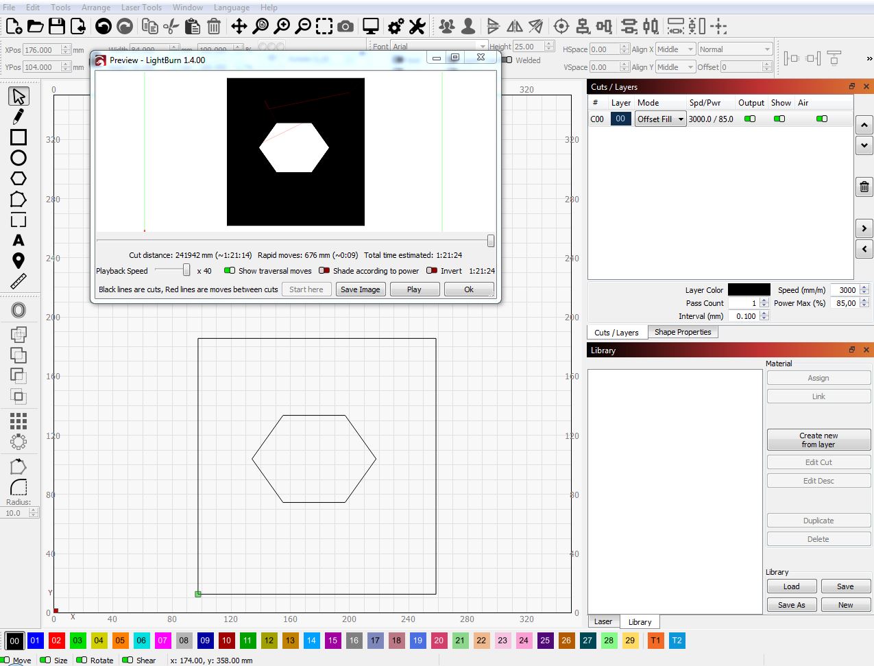

I am trying to engrave an un-filled star onto a filled background. Both background and star are being filled.
Put both patterns on the same layer, so the innermost shape will be removed from the outermost shape’s fill.
In order for that to work, however, the inner shape must be closed. If it’s not closed, then it has no “inside” to remove and will get filled.
A quick test: Edit → Select Open Shapes should not select the inner shape. If it does, then Edit → Close selected paths may be your friend.
Select all shapes and put them all at the same layer, then in the cut/layers window select mode “Offset Fill”.
If this not solve your problem please be more specific, and maybe with some pictures.
