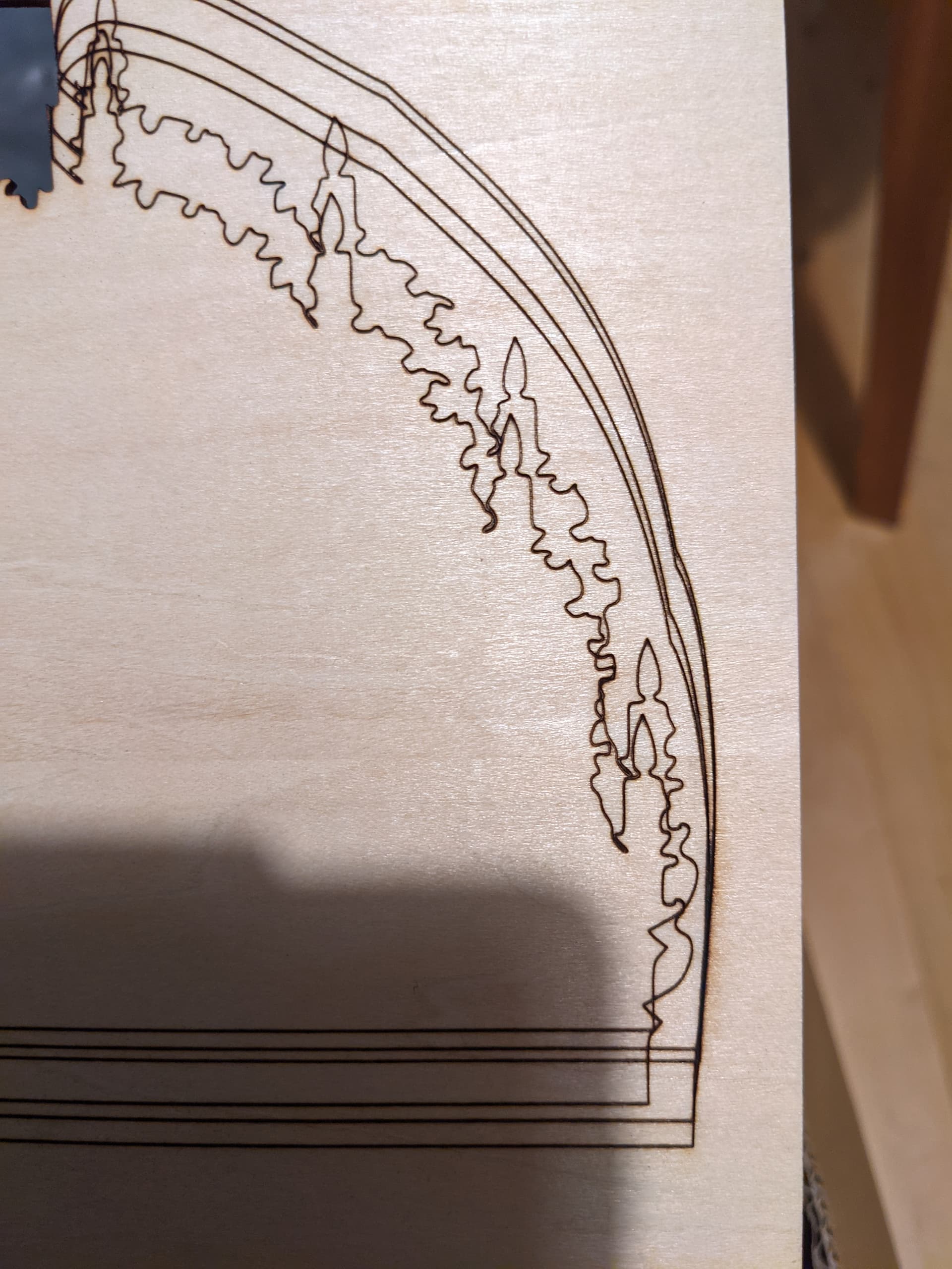

Unfortunately I’m facing a problem with deviations on multiple cycles for the same element to engrave / cut. (On 3d printers it would be called layer shifts…)
I have checked the belts, motors hardware etc. When cutting a simple circle or square things are fine.
When cutting some Christmas decorations I have a shift only on the x axis.
As the structure is rather complex I m afraid it might be some rounding issues on the hardware ? All things on mechanics I think I have checked :frowning:
To illustrate I have uploaded a picture (I used the same piece of wood for two tries with slight resize and speed change as the deviation somehow scales it looks like some systematic problem :frowning: but I don’t have a clue what’s on)
As the two different tries may confuse I uploaded the picture with some markings: red and green are the different tries
ilust

Yeah did it using the layer settings and with most parts of this project it works fine. Only this one (a rather long line) ends up in a mess
Still thinking :thinking: whether there’s a chance for breaking the long line into pieces and if thinks get better then

Yes other parts of this file are produced correctly. the difference is: in this parts there are many changes of direction, as to be seen in the section in the fotos) and the part is larges one (about 900 mm of engraving /cutting with 3 passes thus 2700 in totalfor all passes - which is about 25% of the “picture”). Thus I more and more think it might be some inprecise calculation in the grbl 1.1h firmware.

ok I think I finally sorted out the problem:
It seems to be the 2.4 screen with offline capabilities.
to be fair and open: It’s not 100% safe by now, as I didn’t laser the picture for the testings anymore but CNC plotted it by fixing a Pen to the laser. BUT things sort out to be reproducable.
When engraving not from SD Card (several tried) but directly via lightburn and notebook it looks ok; when splitting the line in Lightburn [found the option :)] into 5 parts offline processing looks ok as well. (only ok as the Pen is only attachted to the laserhead with a quick and dirty printed holder and some bungee cors, thus it moves very slightly)
Well when having time I’ll try the next “real” test with laser on [as I dont want to burn wood for about an hour indoors - even with carbon filters]. Thanks to you all.
can finally confirm the problem resolves when either cutting long paths into smaller sections or engraving directly, thus it should be a bug with the tft24 offline capabilties. not too sure what happens in details but might be s.th. like roundings when having many small direction changes [what somehow doesn’t fit as in most situations things like this should compensate themselfs].
