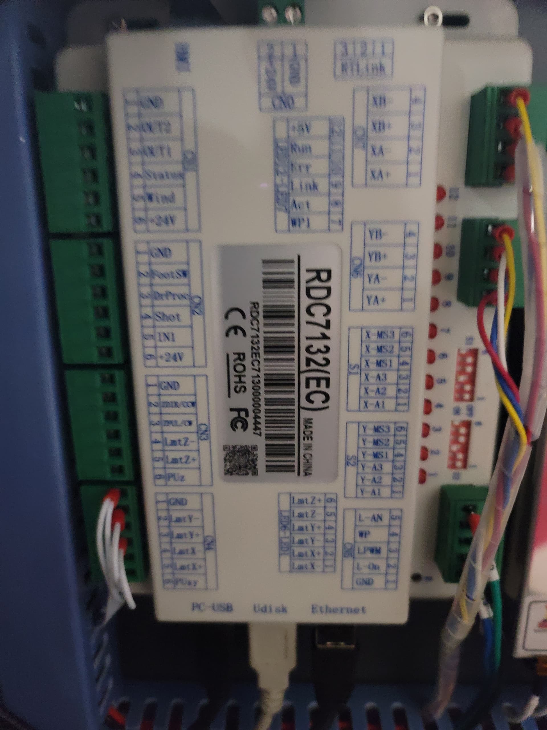

Can you provide pictures of your laser controller and panel?

Replied with photos below

I haven’t seen this control panel, which Ruida do you own?

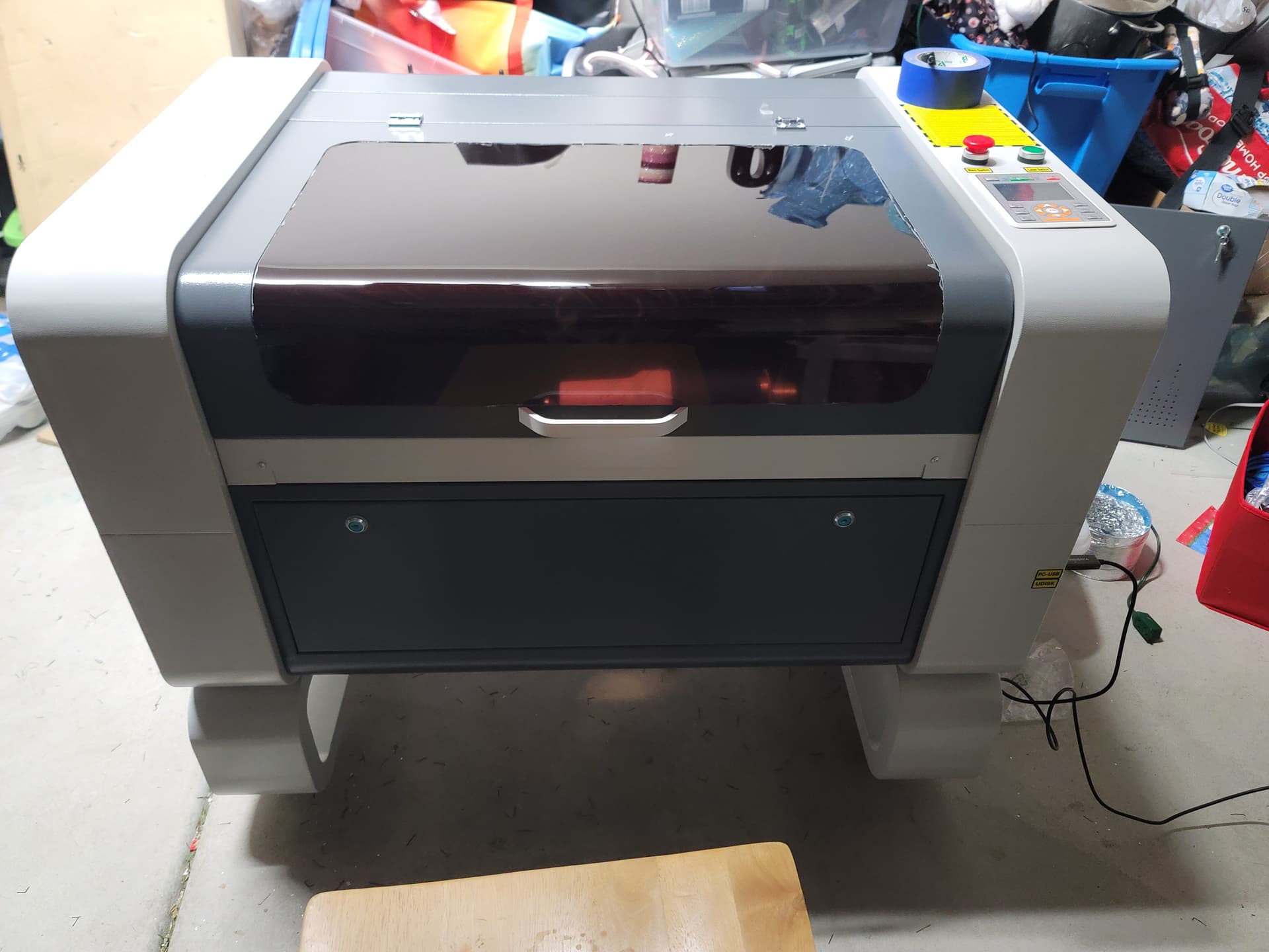

Which ruida… good question here is a pic of the side.
I do own it. I just purchased from a local wholesaler. Went to his workshop watched it run and everything from his laptop off lightburn. We event tested the rotary. Took it home and now I can’t get my comp to work. I’ve tried on two different laptops and my desktop. Two are windows 11 and one windows 10. I’ve tried installing comp ports unsuccessfully as port didnt even show under device manager. I found them in hidden devices but cant get that to work. My computers don’t even ding that something is plugged into the USB like they would with anything else inserted.
Under device manager I don’t see the laser and I installed the driver that was provided with lightburn download. What other driver do I need?
