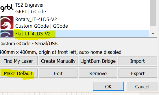

Change the highlighted to A and keep your rotary axis at Y.

No need to do that.
In Device settings select your Flat device and click Make Default then OK.
Keep your Rotary_CustomGCode edited, when you need/want to do rotary.
If you enable rotary in your Rotary_CustomGCode and leave without disabling it, Lightburn keeps the switch position per device so that you need only to alternate between flat and rotary.
You are absolutely right, making 2 Gcod customs one for flat work and the other for rotary work is very clever. Everything is now optimized and works as expected.
