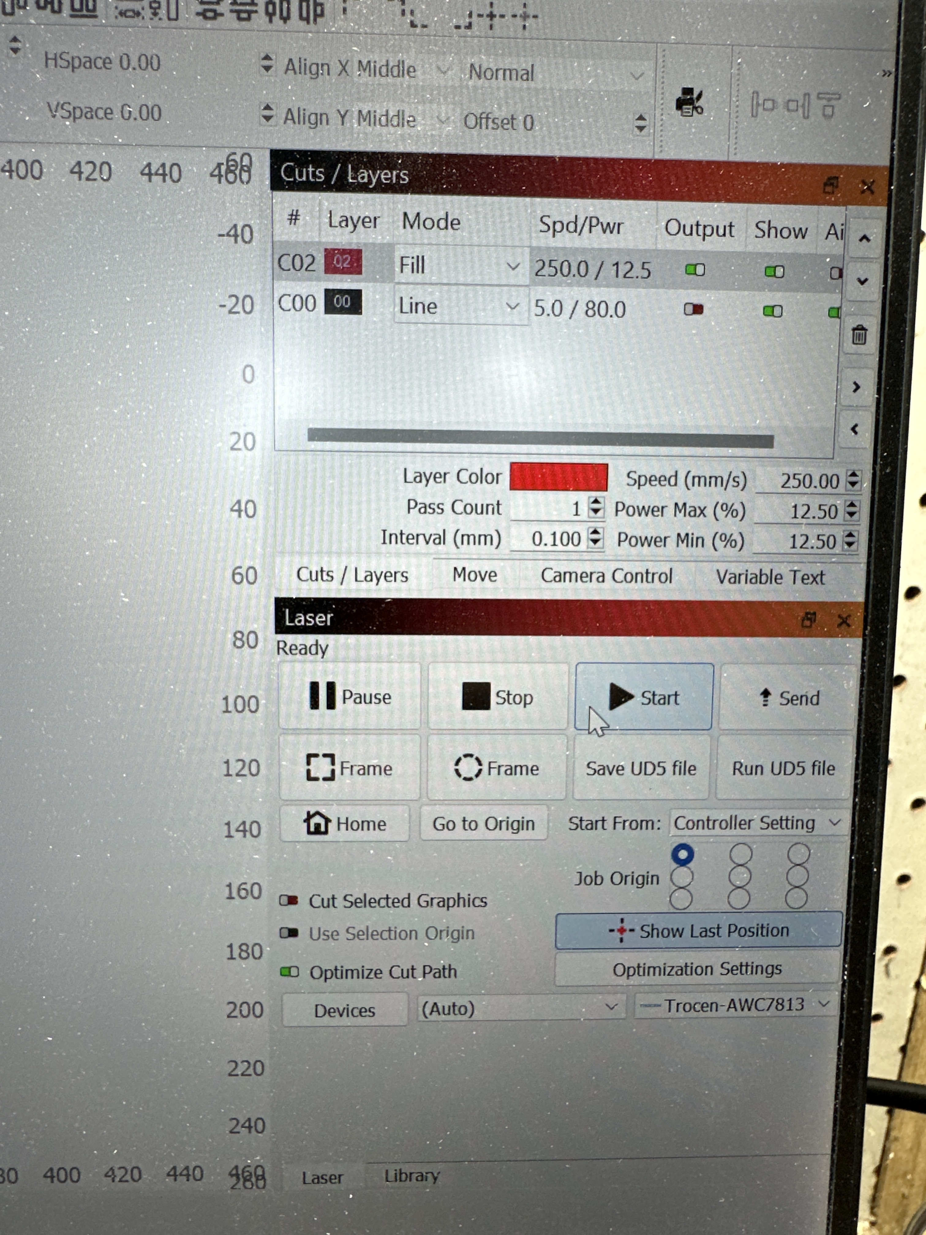

I’ve just started trying to use my K40 for engraving paint off acrylic.
I’m building a flight sim cockpit!
Can any diagnose the attached? Left side is offset fill and the right is exactly the same except fill only. It consistently creates the double image.
For reference:
Trocen AWC7813
250mm/s
12.5% power
Single pass
0.1mm interval
Thanks in advance
Dave the noob

If you run first the fill and then the offset-fil did you get the same output?
Does this still happen to the fill mode one if you turn Bi-directional Fill off in your layer settings?
If not, then this is likely to do with your scanning offsets either not being set, or being set much too high/low.
