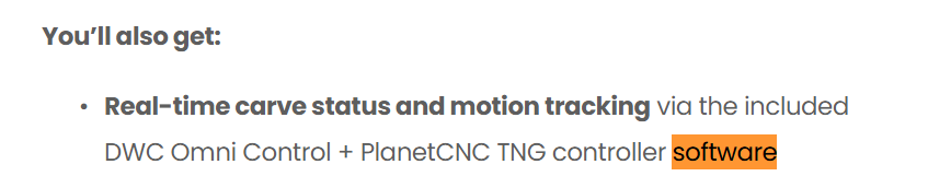

I have searched and not been able to locate the answer. Forgive me if I just missed it. I use LB for my laser so I wanted to get it for my CNC machine. I have Aspire but have never used it. My understanding is that MillMarge does not support my machine. I also have a CNC One from Kickstarter and haven’t even finished building it yet. ChatGPT said I can change my controller, but that seems like overkill. What are my options? I was planning on buying the pro version.
Hi Mark,
MillMage support comes in two flavours - direct machine control, and GCode-generation only.
Direct machine control means MillMage is an all-in-one design/CAM/Sender tool - for hardware that supports direct control
GCode only means MillMage does the design and CAM side of running the machine, but you transfer the output gcode from MillMage to your machine and run with your machine’s code sending/control interface.
DWC2440 Pro CNC Router | Explore & Carve Today — Digital Wood Carver - this appears to be your machine
That controller appears to be proprietary
The code appears to be standard gcode however: CNC controller Mk3 [CNC.Zone]
So you should be able to make GCode with MillMage without issue. I would suggest using the LinuxCNC flavour of gcode during setup. Adding Your Machine - MillMage Documentation
