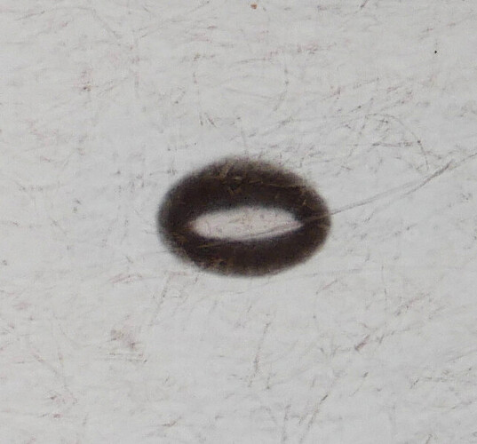

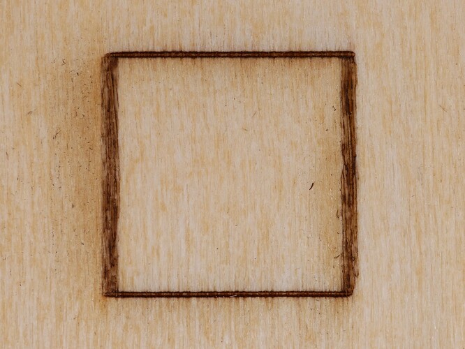

I recently picked up an AtomStack A24 Pro and ran into a concerning issue right out of the box. During a quick test engraving, I noticed something strange: vertical lines were coming out noticeably blurry and wide, while horizontal lines were sharp and clean.
To investigate further, I engraved multiple 1cm x 1cm squares at various speeds and power settings. The results were consistent — vertical lines always appeared fuzzy and significantly thicker than their horizontal counterparts.
When I tried cutting a square in 3mm plywood, the issue became even more obvious. Horizontal cuts went through cleanly at 90% power / 650 mm/min, but to get the vertical cuts to match, I had to slow it down to 90% power / 350 mm/min — a big difference.
I ruled out mechanical issues and checked the lens — it’s crystal clear, no dirt or damage. That’s when I decided to examine the laser spot itself.

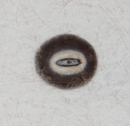

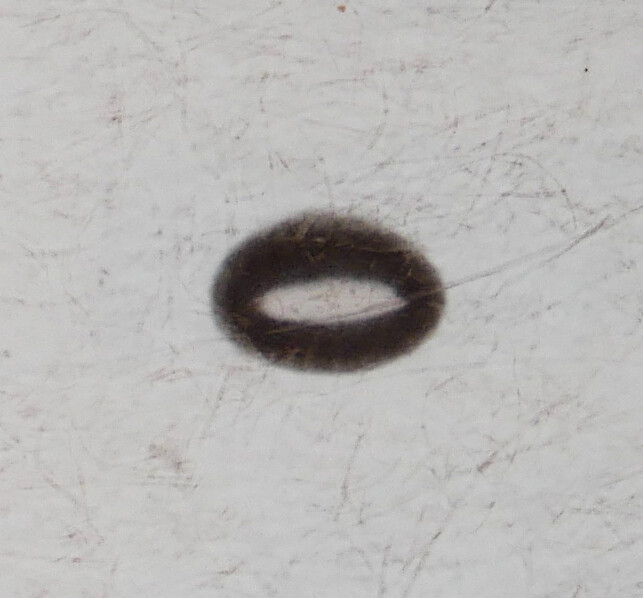

After a few attempts on different materials, I got the clearest laser spots on thermal receipt paper. I pulsed the laser manually at low power (3–6%) and photographed the spots using a 1:1 macro lens. The photos confirmed my suspicion: the laser beam is visibly deformed — more of a long oval than a tight point — which perfectly explains the engraving and cutting anomalies I’ve been seeing.
From what I can tell, this is a textbook case of diode laser astigmatism.

Diodes won’t give perfect cuts on both axis, and the higher the power the worse it gets, but this looks excessive to me.
Diode lasers do not produce a round or symmetrical beam; they produce an elliptical. This is due to asymmetrical nature of the PN junction in the diode itself. My laser produces a beam that is approximately 0.1mm by 0.08mm in shape. So along one axis it get I get narrow lines and along the other I get wider lines. Diagonals are noticeable as well. But what you displayed seems excessive as another commenter mentioned.
@Bugeyz @Dskall Thank you for your comments — that’s exactly my point. I know that diode lasers don’t have a perfectly square spot and that it’s normal for the beam to be slightly elliptical. But in this case, the distortion seems way too extreme and it’s very noticeable, especially when engraving.
When it comes to cutting, the difference creates a big problem in my view. There’s almost a 50% difference in cutting speed between vertical and horizontal lines, which makes it practically impossible to get clean cuts without excessive charring. One axis always ends up way too overpowered.

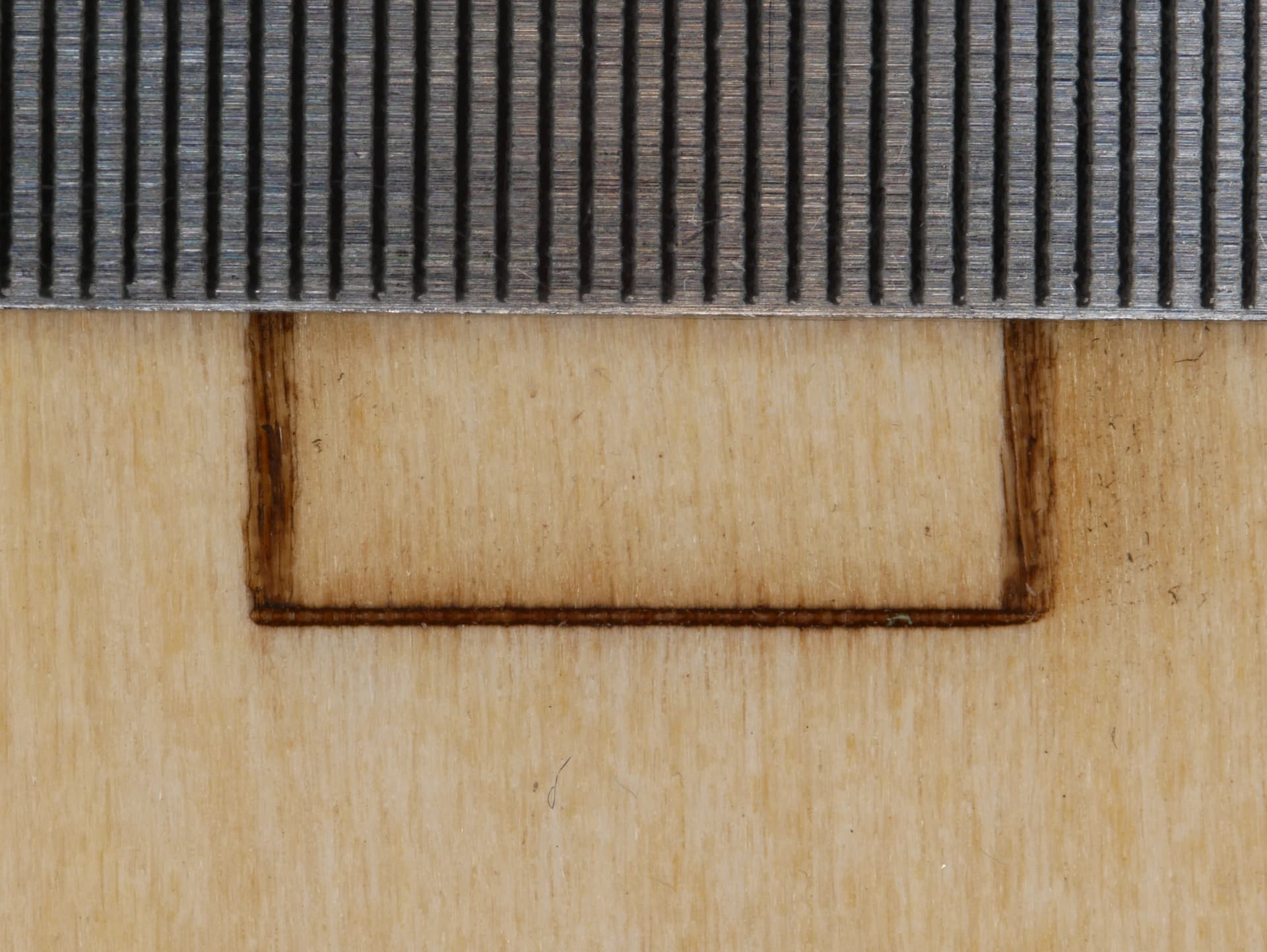

I’ve added two more images to show what I mean — one of the square and another of the laser spot both next to a ruler with 0.5mm markings. Based on the specs of the laser, the height of the spot should be around 0.08mm, but the width looks to be about 5 to 6 times larger than the height, so somewhere between 0.40mm and 0.48mm. That lines up with what is shown in the photos and is way off the specification of 0.06 x 0.08 mm for this laser.

That doesn’t actually look so bad. It depends one the beam optics if those two spots form a (relatively square) combined beam or if they are overlain in the focus spot. In that case, the beam is very rectangular. But still, the main spot looks ok. You can see some pictures of other modules that I have taken here: Guide to mechanical adjustments and maintenance (for comparison).

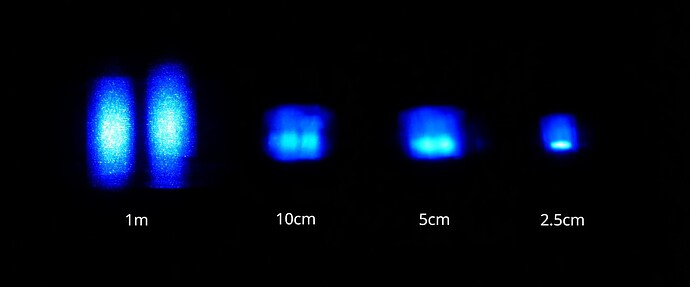

The previous photo I took was at 2m. But at 1m the spot still has the same shape as before (nothing like the ones in your photos). Then I decided to photograph it at shorter distances, and here is what I found.. The shape started changing in a way I did not expect, but the final photo at 2.5cm matches exactly the problem I’m describing, as well as the macro photo of the laser spot on thermal paper. I also noticed that my previous photo at 2m did not have the correct orientation. Now all the photos are orientated to the same axis.
To me, that looks like the optics is not aligned correctly, the spots that should be on top of each other are next to each other. I don’t have a similar module to compare it to, but you might reach out to the manufacturer to get a replacement.
You could try to do a focus test and check if the focus is just at a different distance than advertised..

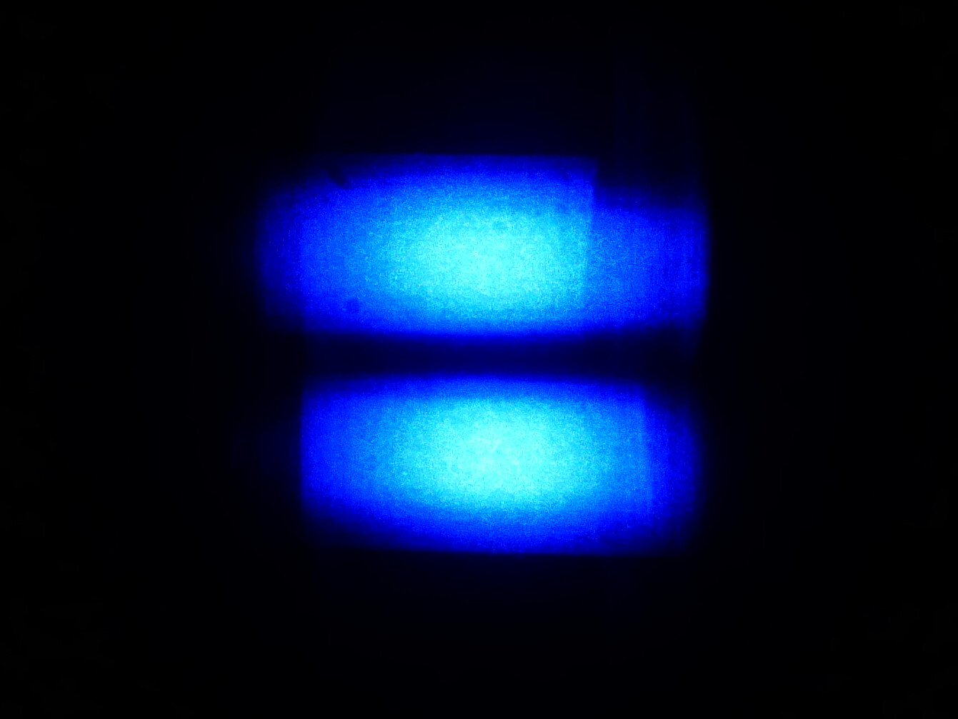

Also, I’ve added a few new photos below (taken with a different lens this time) for anyone interested.

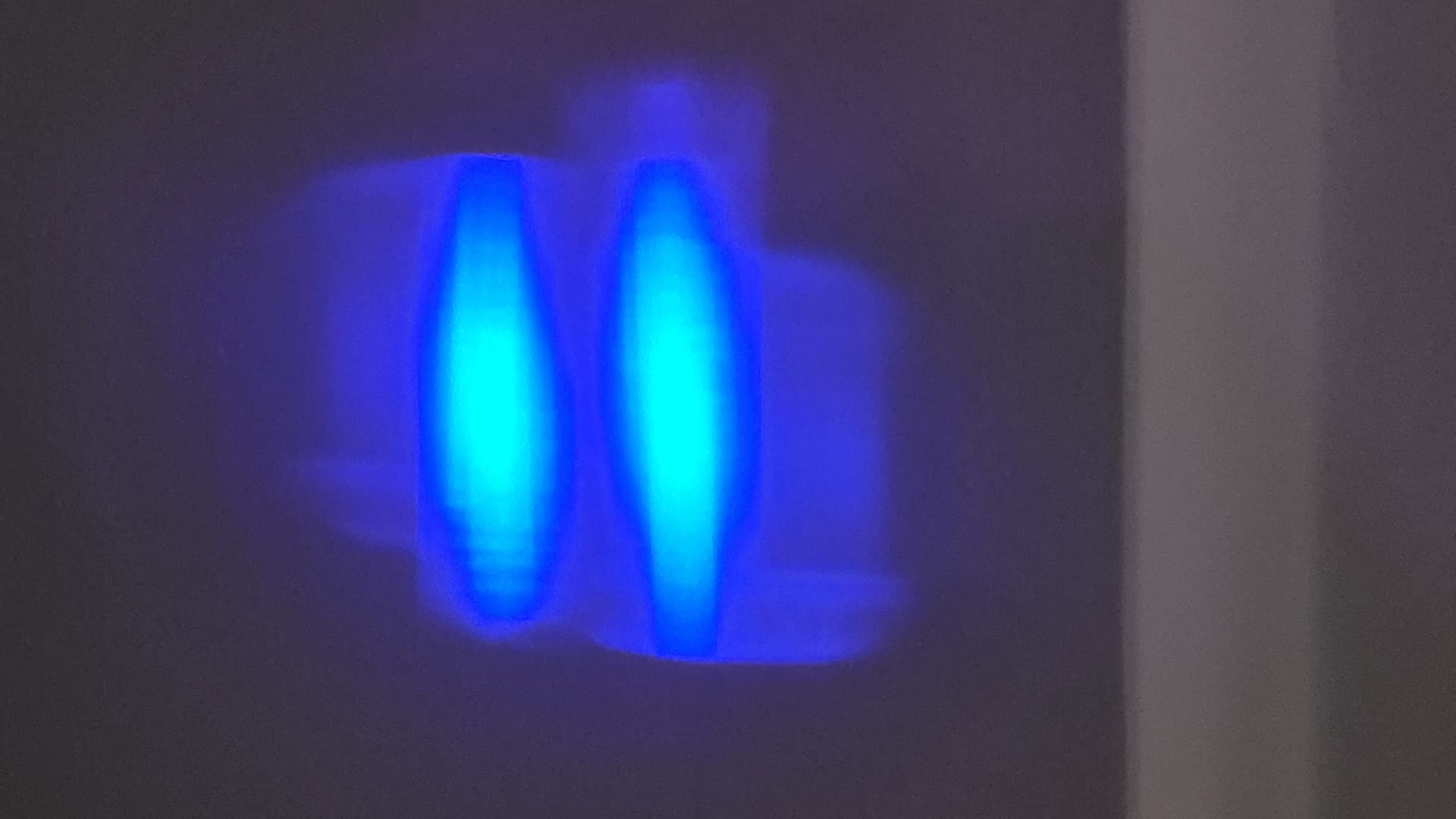

here is my beam on a wall @2 Meters / 2% power
and the cut 10000 mm/m / 80%
That looks like a faulty optics as well.

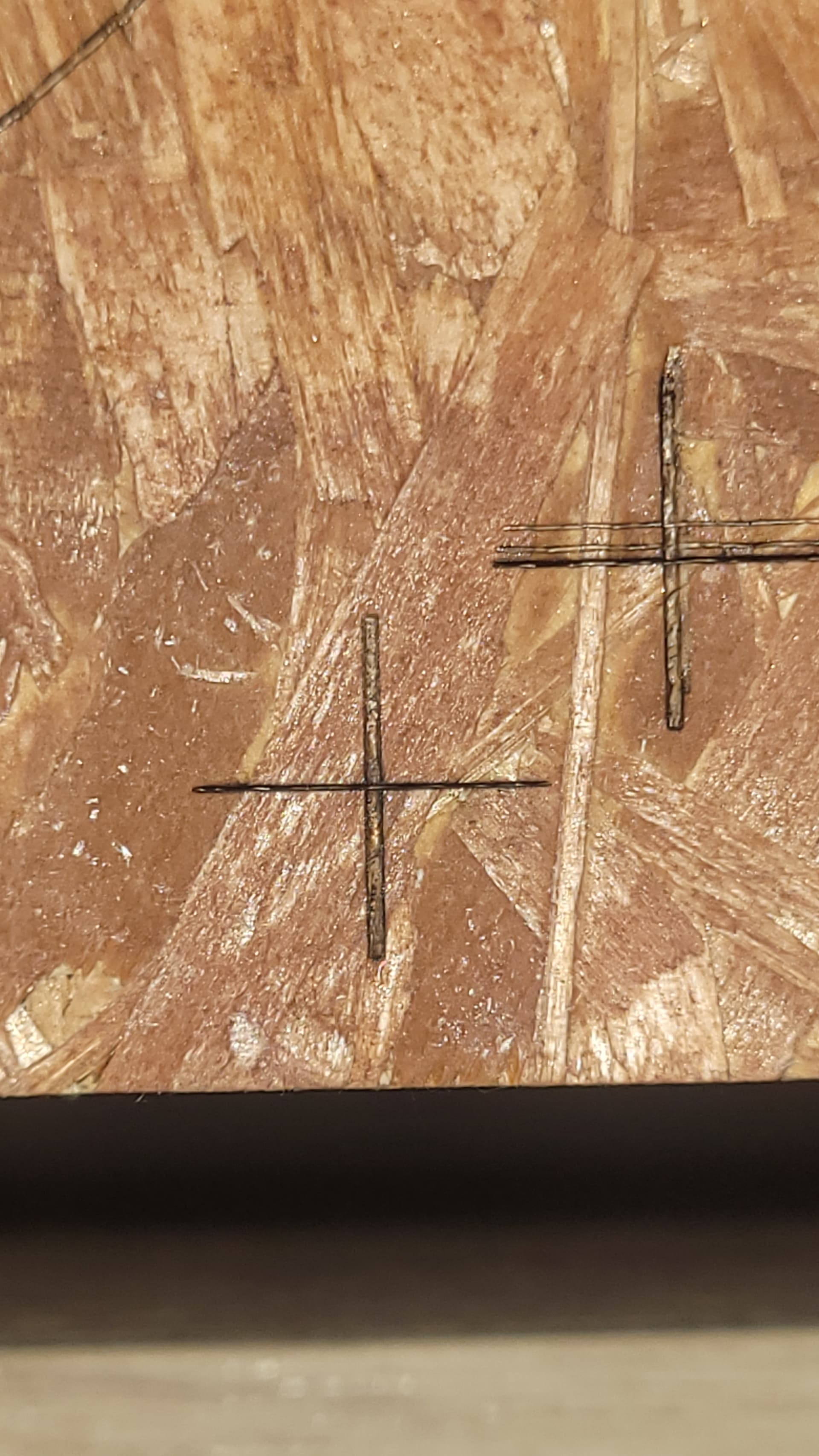

I should’ve done more research on this company. As I barely got mine delivered today I noticed mine was doing this on the a20 20w. Y-axis is clean and small but when the x-axis starts it gets thick. I was confused because I have an xtool 10w and have rounded up some knowledge on laser engraving/cutting. So I did the typical clean the lens or adjust the tensioner and check for frame alignment but the issue was still there. So sad because now I’m worried that they’ll try to do the same with me. I just want my machine to work so I can continue making stuff to sell but after reading this I’m so scared I won’t get this resolved
