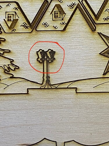

Hi, I have a Bodor 1309 laser with a print area of 1300x 900
It happens that on large scanning, carving and cutting jobs it unfortunately moves as if it were losing steps.
they tell me it could be the motor power supply or the settings of the machine itself
Could anyone give me some help?
I am having the same problem as you. Did you find a solution? What speed are you cutting?
Hi, unfortunately no solution, I replaced the RUIDA controller, the two stepper controllers but it hasn’t improved.
I think it’s a settings problem, but no one on this forum knows anything about it
I have contacted lightburn but didn’t get much help. They said most likely a hardware problem. Maybe loose screw? Loose belts? Don’t know I am still testing. Mine is a brand new machine so don’t really know where to start. Maybe just maybe someone here has had the same problem and has solved the issue.
hi, the strange thing is that the problem only occurs with cutting and engraving at the same time, my laser engraved for 180 minutes yesterday and the problem did not happen. I think it’s the software instead, we should try another software. let’s keep in touch
